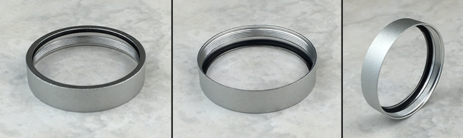

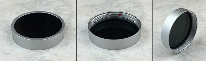

DJI UV (screw-on stock filter)
DJI ND8 (screw-on)

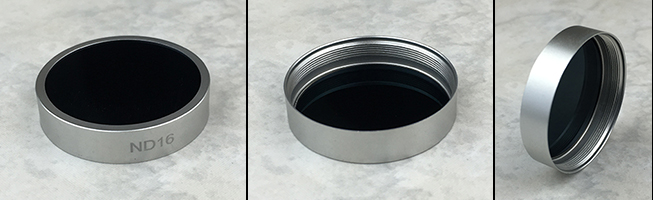

Anbee/BTG ND16 (screw-on)

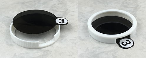

DitzCo ND8 (slide-on)

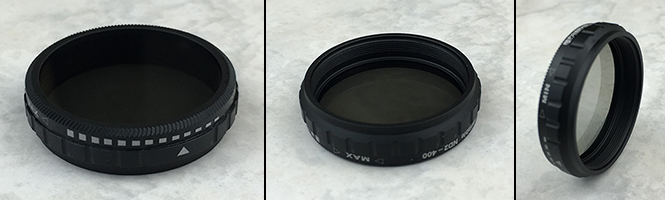

Freewell ND2-400 (screw-on adjustable)

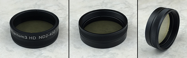

Mudder ND2-400 (screw-on adjustable)

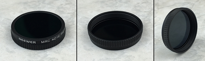

Neewer ND16 (screw-on)

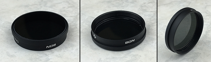

Polar Pro ND8 (screw-on)

  • DJI UV--(screw-on/glass lens/metal rim 0.05 oz)
  • DJI ND8--(screw-on/glass lens/metal rim 0.05 oz same size as DJI UV filter)
  • Anbee/BTG ND16--(screw-on/glass lens/metal rim 0.05 oz same size as DJI UV filter)
  • DitzCo ND8--(slide-on/gel filter/plastic rim 0.01 oz)
  • Freewell ND2-400--(screw-on/glass lens/metal rim 0.20 oz)
  • Mudder ND2-400--(screw-on/glass lens/metal rim 0.35 oz)
  • Neewer ND16--(screw-on/glass lens/metal rim 0.10 oz)
  • Polar Pro ND8--(screw-on/glass lens/metal rim 0.15 oz)

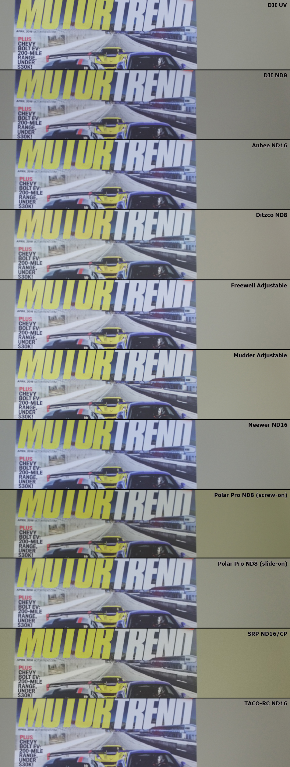

Color & Sharpness Comparison
The following photos were taken indoors to ensure the same lighting was used for each photo. The Phantom was not designed to take detailed close-up photos, but it's a great way to compare the color and sharpness produced when using various filters.
Note: The color differences above aren't really that important if you're planning on editing your photos/video in a program like Adobe Lightroom or Adobe Premiere.

  • DitzCo: These lenses attract more lint/dust than filters with glass lenses.
  • DJI: These filters have no marking on the outside, so you'll need to somehow label them or label the storage case so you're able to easily tell them apart.
  • Freewell: This filter has tick marks on the outside to show the selected ND level. This could come in handy if you want to use a similar setting again for a specific flying condition/location.
  • Polar Pro: Many of the lenses have traces of glue on the edges where they were glued in place. This does not affect the picture quality, but it's something you will visually notice when viewing the inside of the filters close up.
