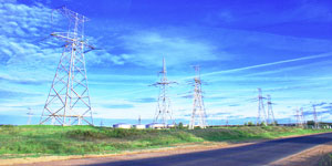

Just one last tip: during a recent flight I had problems with my signal. Afterwards I saw that my location was about 75 meters from a power plant. So just look where you are flying, power plants and power lines are bad for a good signal.
Stay away from these masts or accept that there may be disturbances in your signal.
