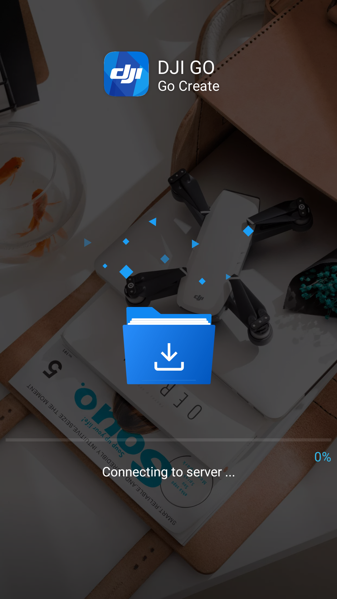

good morning everyone, I have a problem with moddate applications. It always remains stationary on this image. Only 3.1.8 works. Did it happen to someone? thank you

You have to delete all DJI apps and DJI folders on your android phone. After that you can download the modded 3.1.18 Version from the first Page.
If the modded 3.1.18 Version dosnt work and you have the same "Connectiong to Server.."-Screen, use another Handy. Important is, that you run the modded 3.1.18 Version to switch the CE mode to FCC mode.
After this you can run the normal 3.1.8 Version :)
