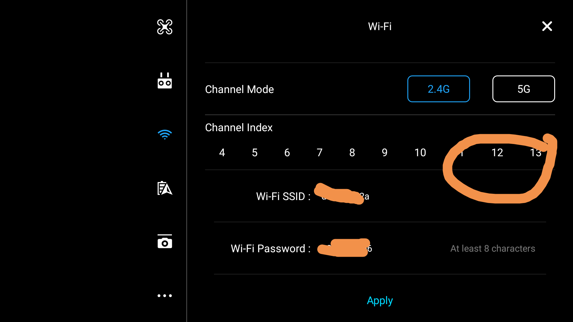

Actually, in v3.1.18, in the REMOTE CONTROL SETTINGS section of DJi Go, I can choose between 2,4GHz (11 channels (=FCC mode) instead of 13 channel (=EU mode). Thanks to you, once again ! ;-) ) and 5GHz (by default, it's set on 5GHz band).

Unfortunately, since I did the firmware update, I cannot change successfully to 2,4GHz anymore. If I choose this option in DJi Go (2,4GHz), it says me that it will restart the wifi, and that I have to wait for the auto-reconnection…
But it doesn’t work ! I see nowhere my “Phantom3SE WiFi”. Of course, I check on my MiMax 2, on the 2,4GHz and 5GHz bands. But it seems that my “Phantom 3SE WiFi” just disappears…
I have to “reboot” my remote to see the WiFi again, but of course, it’s back to the 2,4GHz band (unfortunately) !
I think that it’s a consequence of the last firmware update… :s

No, defnitly not. If you want to try 2.4GHz band, you need an IOS device. On IOS you can change the band with DJI Go, but it will put you back into CE mode if it gets GPS signal.
I made the try, changed to 2.4GHz in FCC mode, but it was not better then 5Ghz (I got a bit shorter range: 3000 meter with 2.4Ghz instead of 3200 meters with 5GHz) so I switched back to 5GHz.
