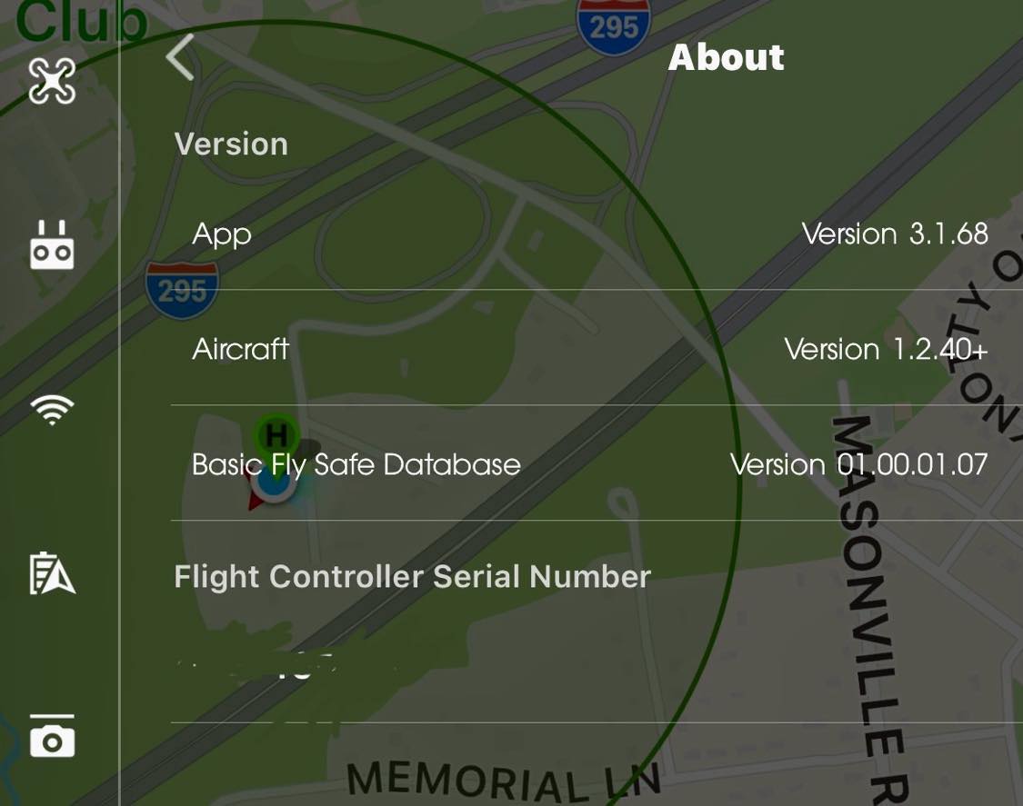

Well i plugged in and it has never flown and that the info that was in there..
captainmilehigh
That sound right what is stated below ? i do want the 27DB Mod

It seems to be a pretty old version. If you don't have any issue with it i dont think it's worth upgrading.
Aside from the 27db mod for video you already have the max of what's possible
yes i do want the 27db Mod for sure my Transmitter Ext will be here on Friday i think it is!! and i need to just upgrade to the 27db
