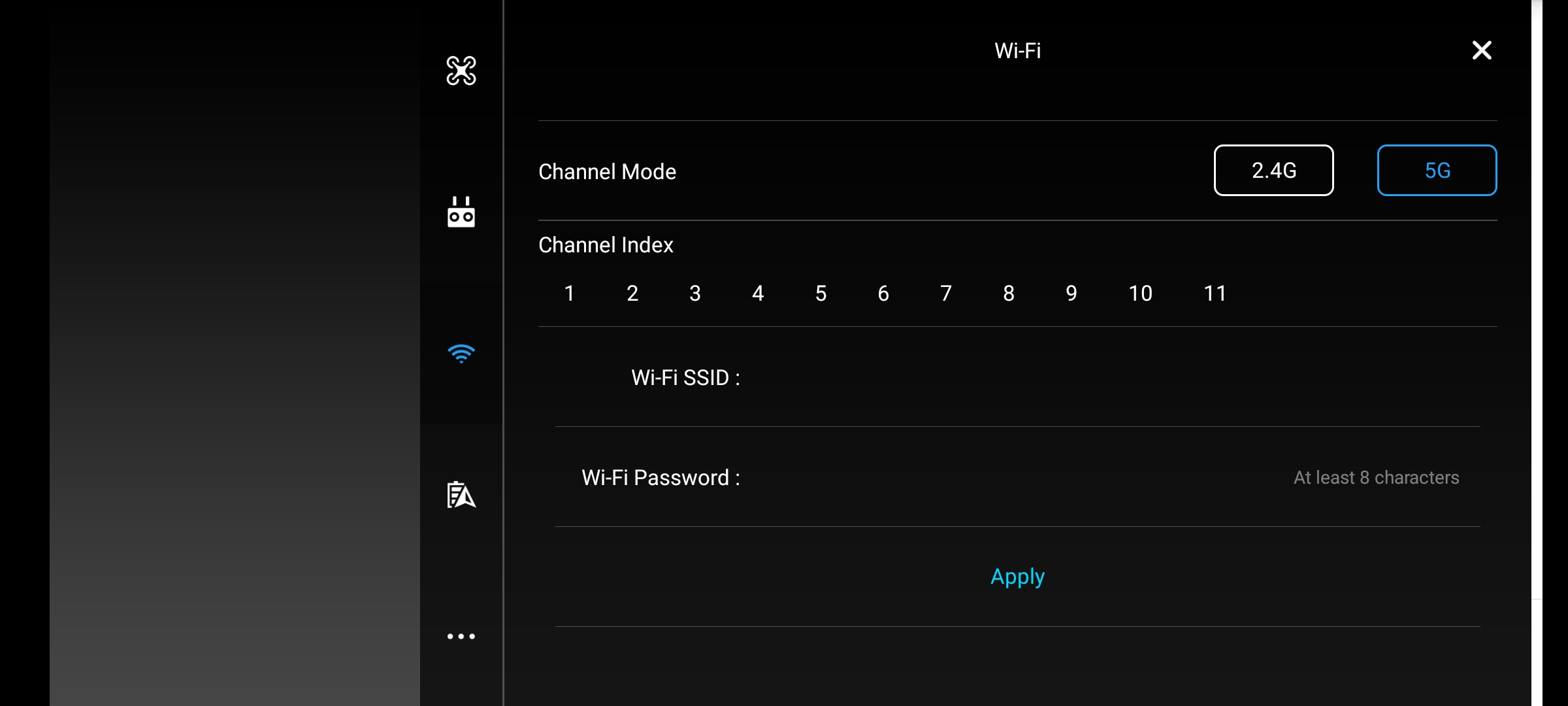

I set the drone in 2.4Ghz mode at lift off, channel 6. Abruptly the signal was lost, most likely (I was shooting circling around the vessel) since the presence of the ship command deck between the drone and myself. I awaited signal return, that never happened (for first time since when I’m flying). I launched RTH, that failed.
I awaited more or less 5 minutes, than when I was starting to rescue the drone, it appeared above me and landed. Transmitter was “on” but still not connected. I shut off the transmitter, I reconnected the Tab, put on 2.4Ghz and voila’, the connection was re-established. Somehow the transmitter changed (when connection was lost for a certain period) from 2.4Ghz to 5,8GHz. Cannot say was commanded by the app or else.
However, If I was flying the drone with 3.1.34 or 3.1.46 I doubt the drone was able to come back due to the bug of the RTH. Although I’ve lost contact with the drone in various occasions, this is the first time the transmitter reset, most likely due to the fact that the connection was lost for a very long time.
So, based upon the outcome of this last flight, I would recommend all of you to fly 5.8GHz always (this is the natural frequency of our drone, kept by the transmitter at startup) and to stay on DJI Go 3.1.18 that has a flawless RTH.
