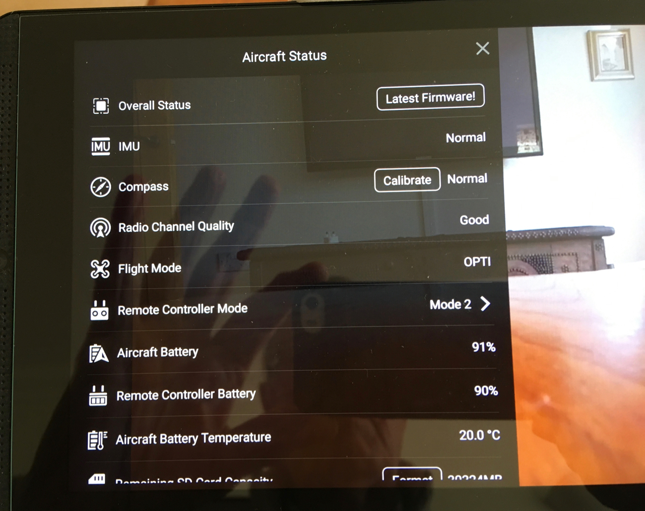

Every time I turn every thing on, and this was this afternoon, I get this, so you say ignore it?
Did you get a warning saying to calibrate your compass? I didn’t see one here. But if you did, then you should calibrate then, and only then. This screencap shows as “normal”
I thought the outlined "calibrate" was just that, saying calibrate? I will say no more.
DJI confuses a lot of people with that.
It's not suggesting that calibration is required.
It's the button to push in the rare event that you need to calibrate the drone.
Reactions: cheddarman
Yes very stupid Calibrate / Normal, same as the name DJI-Go. :rolleyes:
They should change it to this CALIBRATE! / normal. That's how it looks to most of us anyway. :)
