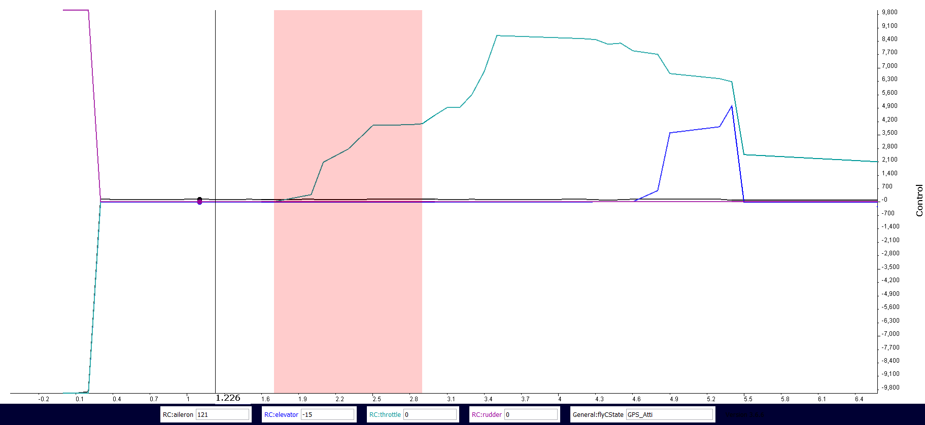

A short version of the flight data looks like this:
The first indication of a problem is at 0:17.7.
The drone is climbing and the drone starts to rotate clockwise despite the rudder being centred.
The rotating slows and almost stabilises around 0:21.
At 0:34.2 with the rudder still centred, the rotation pauses and then speeds up.
The highest point on the flight is 91 ft at 0:42.4 when the drone starts to lose height despite the throttle being centred and later, pushed upwards.
The fall becomes faster, it spirals, rolls and pitches as it tumbles and falls to earth.
It crashes at approx 0:49.4 and all data after that is garbage because of the crash.
The battery voltage was good and shows that it was not a battery issue.
The spining and falling indicates the loss of a prop or motor.
If all props were attached to the drone (and complete), that suggests a motor (or an ESC that controls the motor.
Broken or unattached props might have happened in the crash.

Looking at your flight (over so many houses??) there were several battery deviation errors starting at 45.8 where there was a sudden drop in unevenly in voltage.
Then at 49.6 your compass packed up and the battery cells dropped in voltage quite significantly possibly the cause of the speed error.
From that point on the battery was what I think is below their ability to power the drone adequately and unbalanced.

That question aside. Going back for a closer look at the data, I am starting to wonder if this was an actual aircraft alone issue at all. It could be a combination of the two. The RC looks to be off calibration. Notice below the values of the right stick. Specifically the aileron. It is not enough I don't think to cause a serious issue, however it is possible that being that the offset of the elevator recovered during the flight, the aileron remained offset the entire time. It never went to zero as it should when you release the sticks. Which in turn would provide false inputs to the aircraft. Just throwing that out there as something to consider.

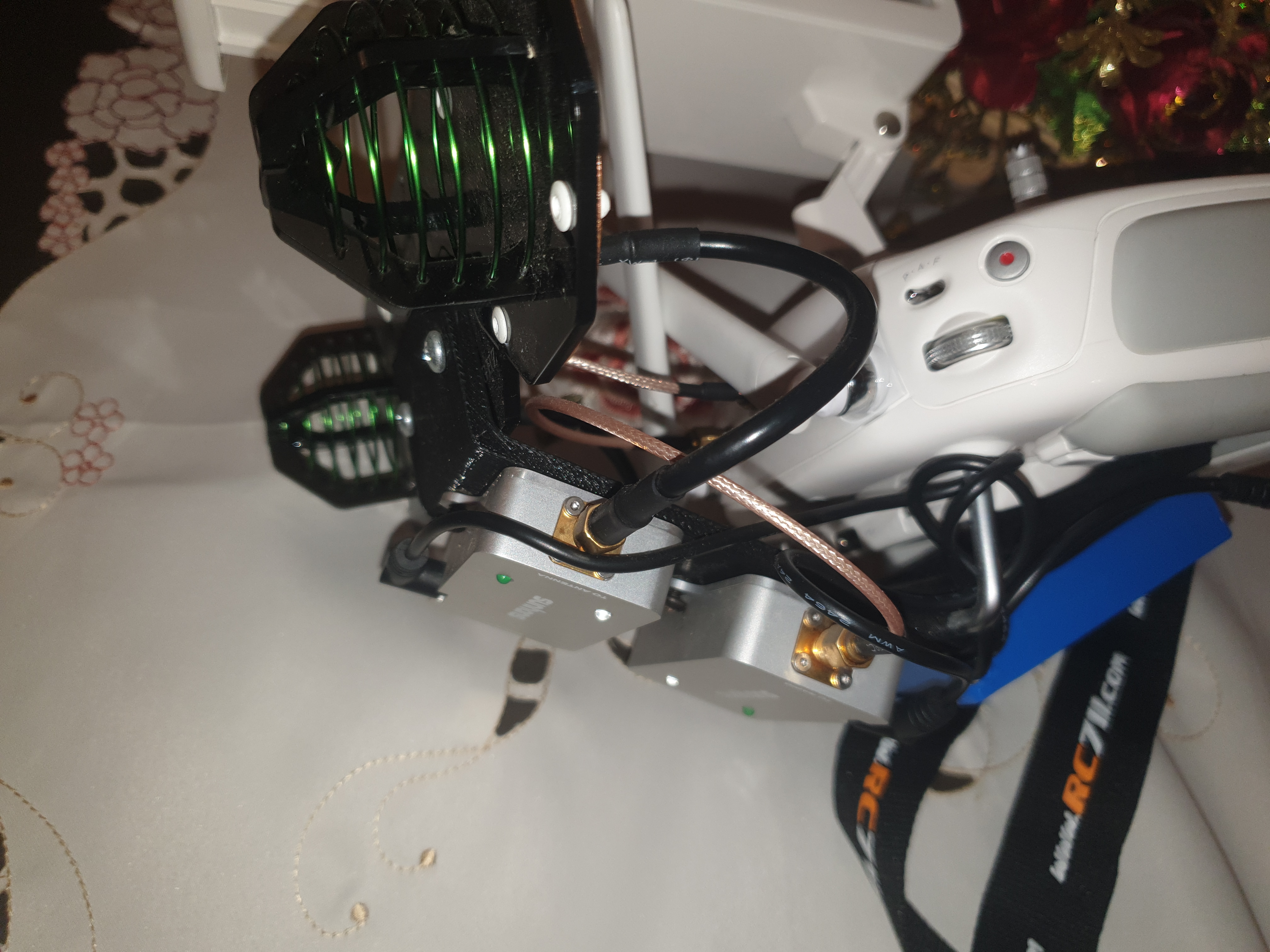

Yes. right stick of my RC is partly broken (pushes inside) while i was modding since earliest days of ownership.. I have been able to use it several times, I doubt this alone would make it spin erratically downwards and lose altitude.
As do I, but it was worth pointing out. That is all I was doing.
