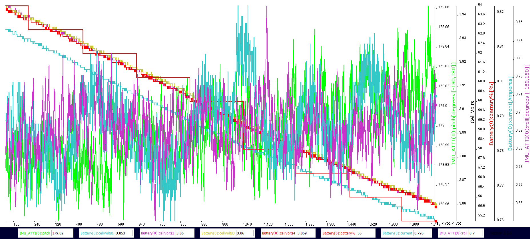

At the latter part of the flight the battery cells were showing some deviation but still at 95% capacity.

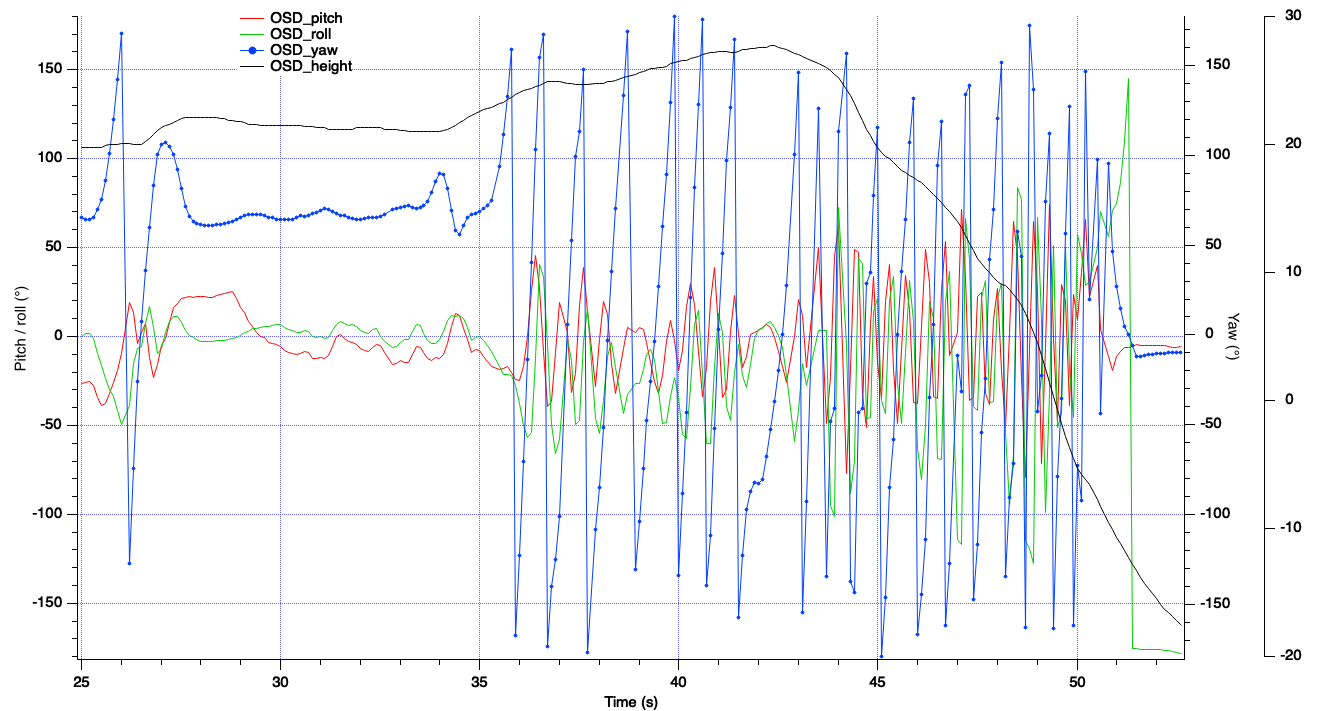

Your file download options are horrible, so I haven't looked at the DAT file. However, the data in the txt log are pretty clear. Firstly, it wasn't a compass or IMU issue - this was almost certainly a CW motor failure - probably front left - leading to rapid CW rotation and descent:

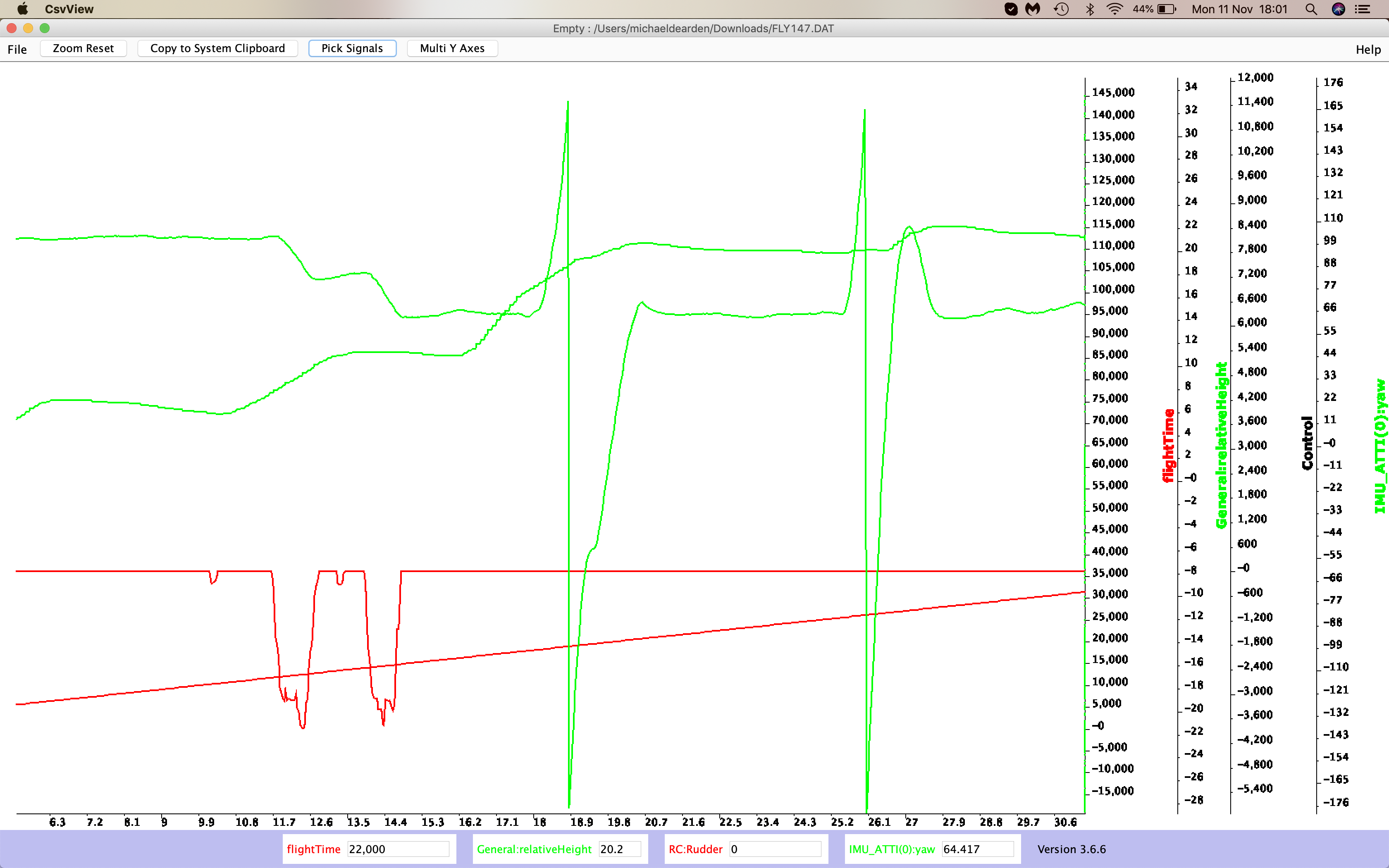

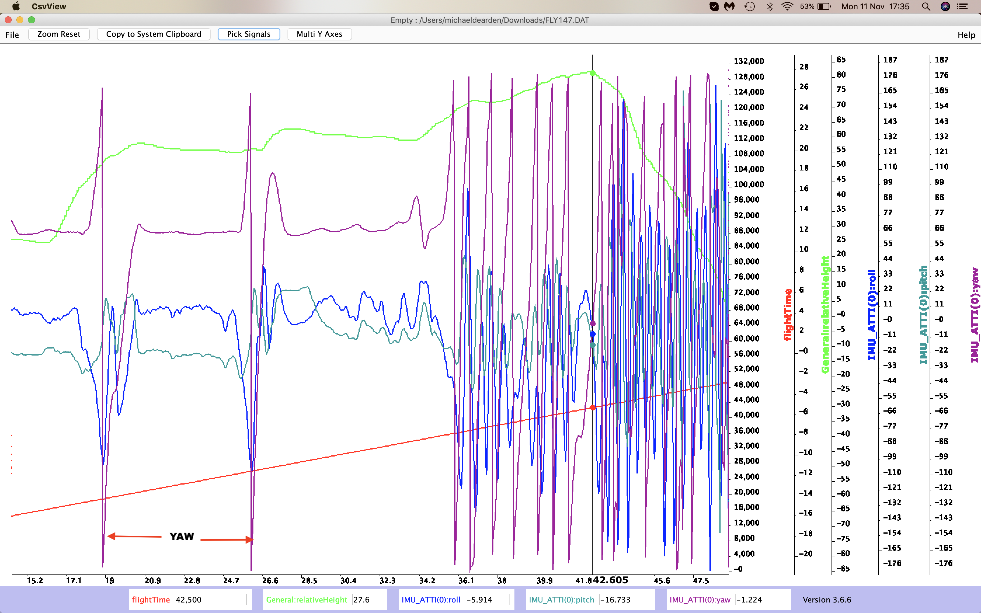

Bear with me, I'm practicing this from your FLY147 data file...........
At 18 sec and again at 26 seconds you put full left/right yaw (rotation) inputs and then after 36 seconds you appear to have put full left and then right yaw for some reason?
At this time all four motors appear to be working normally.
Not sure if this is relevant to anything but I'm enjoying the analysing!! I'm sure someone will correct me if my above is wrong? (I won't taker offence as I say, I'm practicing........
Reactions: MotorCycle-Man
@cheddarman...Look at the rudder inputs. There were 2, but well before the 2 spins. Not relavent to the spin.

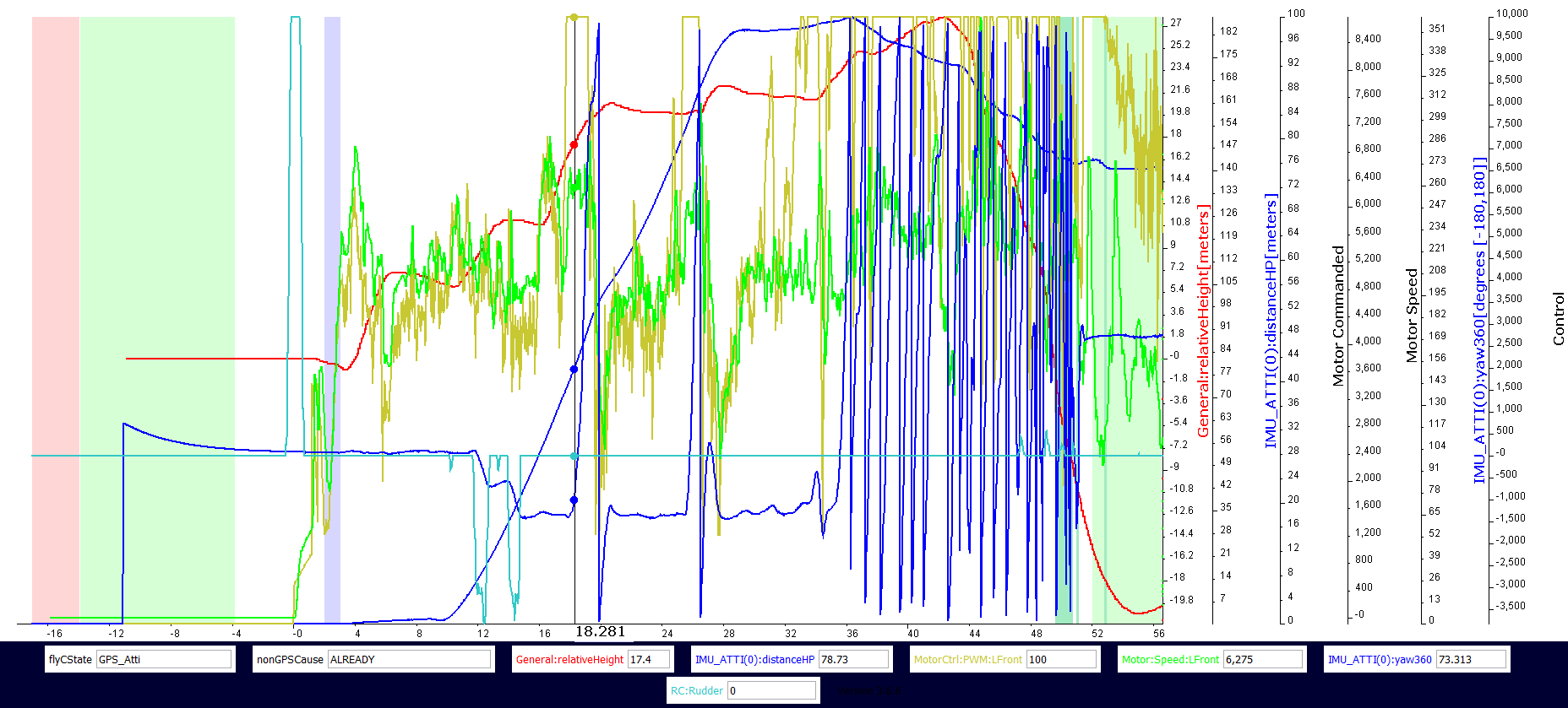

@gizmo To me this looks like an ESC issue. At the first 2 spins, the left front PWM spiked to 100% and subsequently the aircraft spun 360 degrees. It recovered after the first and second one, but got worse after that. That is not written in stone. Just what I am seeing. Not really certain why that spike would cause the spins, but could be the result of another factor. The motors were fairly stable in RPM.

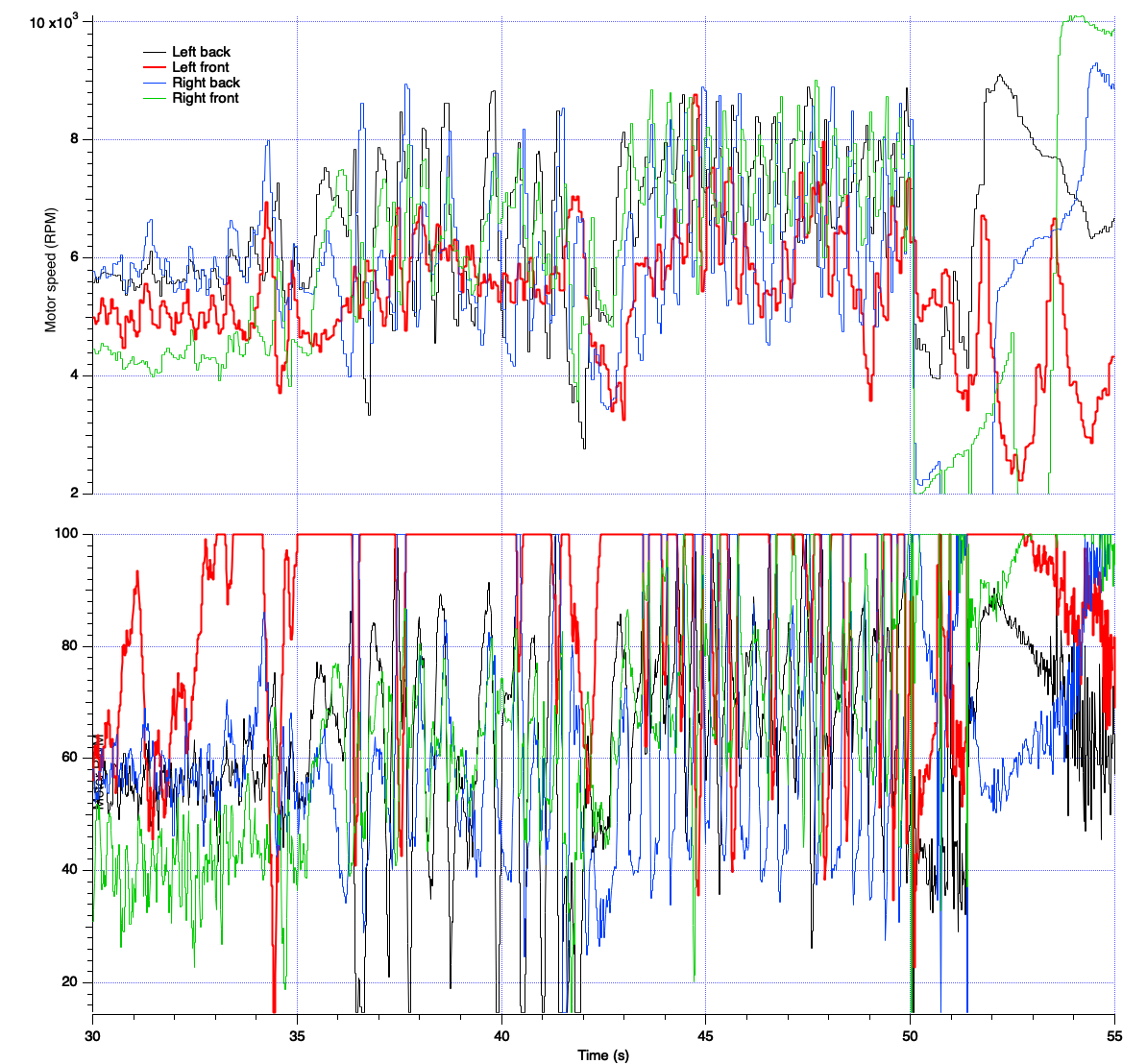

It was the front left motor, as I suspected:
Note that the ESC had been intermittently maxing out the PWM on that motor repeatedly after takeoff (hence the motor warnings). At 35 seconds it again went to full, but the motor speed dropped. That angular imbalance, with a CW motor running low, is what caused the CW spin. The lack of lift also caused the descent. It's either a bad motor or a bad ESC.

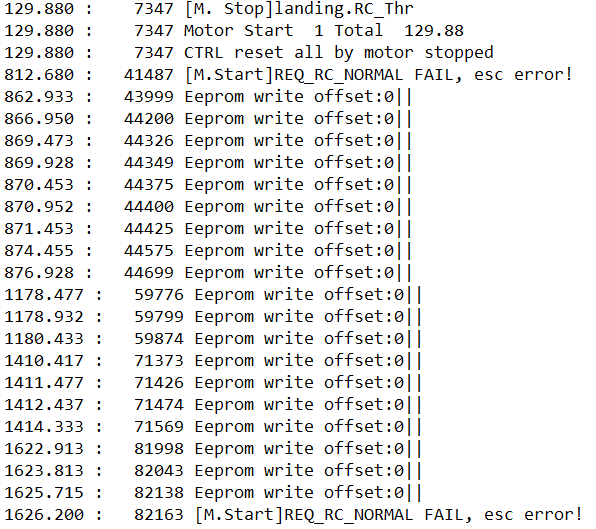

Thats the answer I was looking for. Wasn't 100% certain of the reason for the max PWM and motor slow down causing the spin. And agreed on the app messages as well. BTW, did you look at the event log? Specifically the first line here. Landing? Just curious. The remainder is after the crash I believe.
