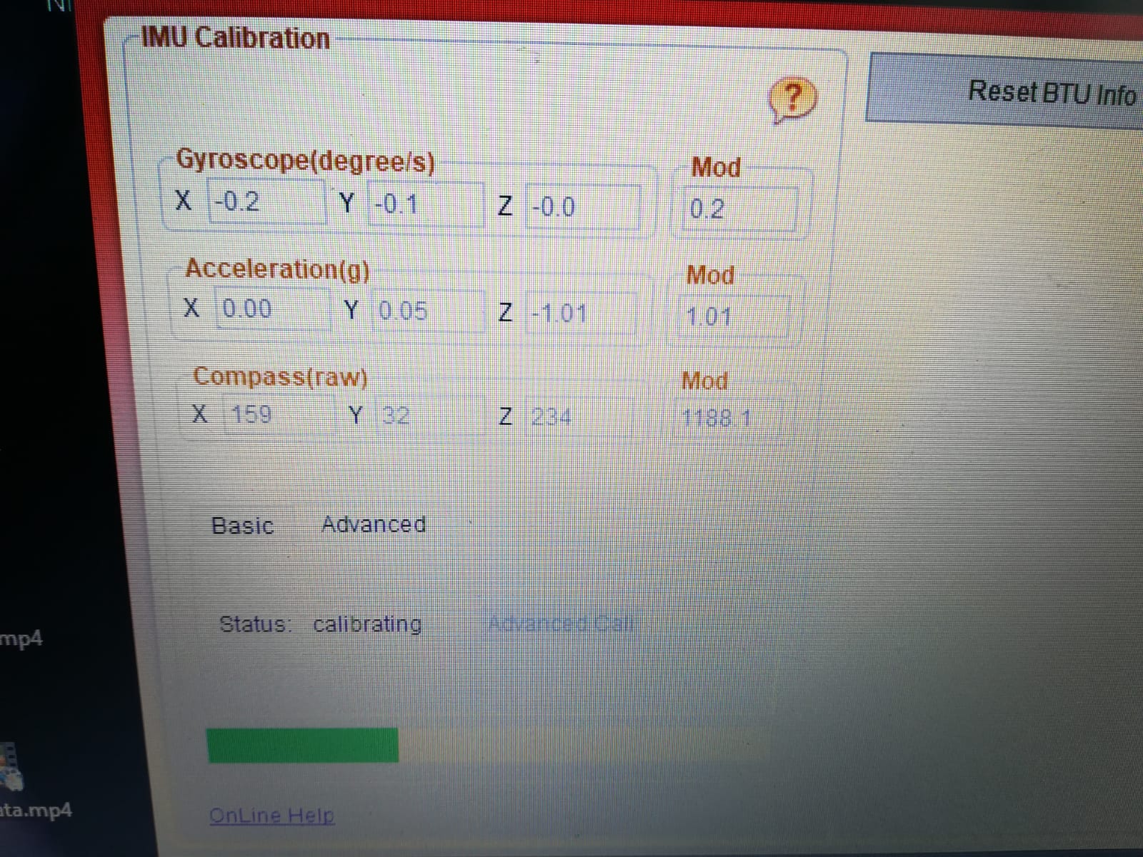

Have you taken the time to do an advanced IMU calibration after the crash? It also has to be done on a level surface also the Compass Mod Levels should be no lower than 1300 or higher than 1600.

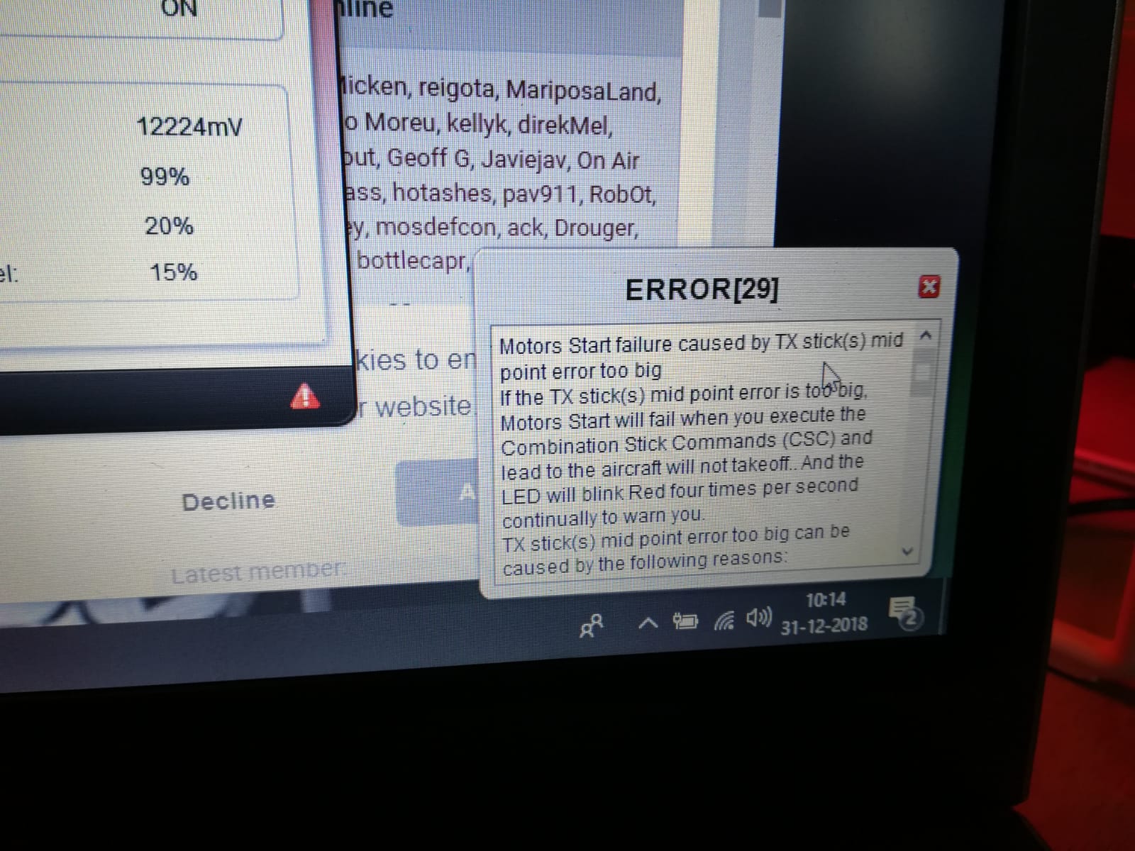

i pull the s1 switch 5 times and turn the phantom acw and the lights turn green then i do the same with the nose down no he starts blinking yellow instead of the green what should.
I try to start the phantom but it wont ;(

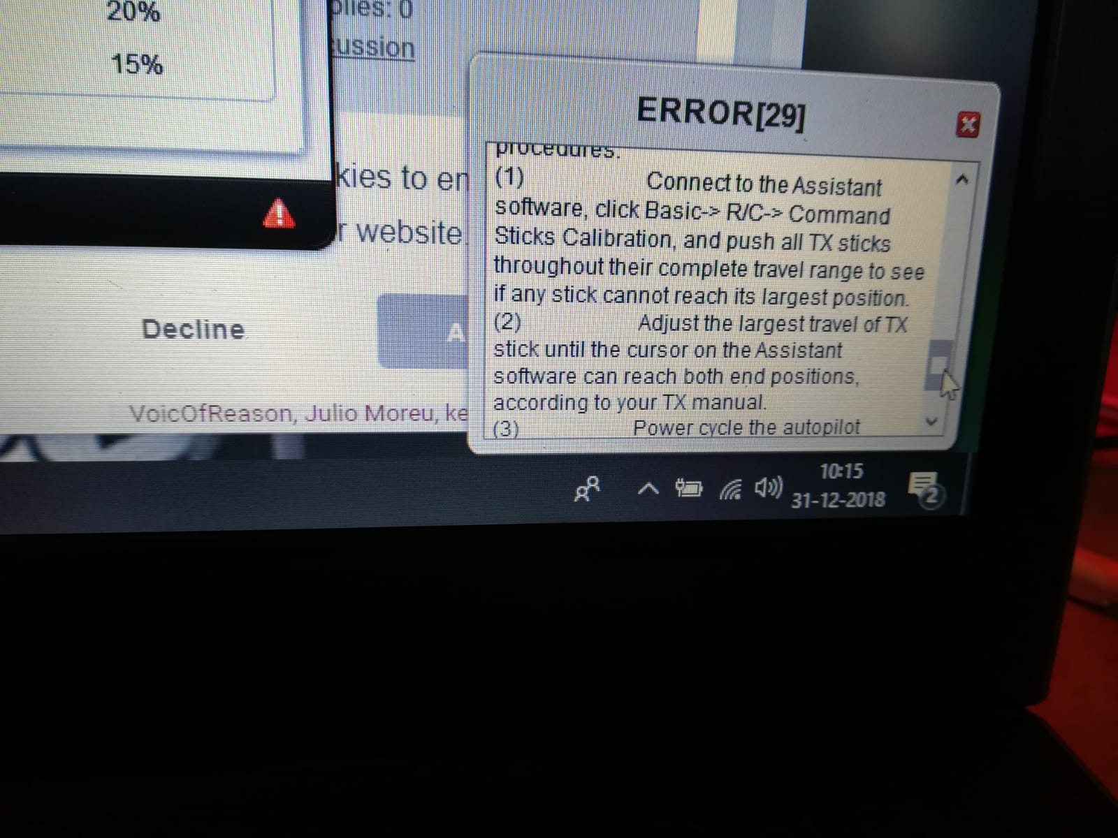

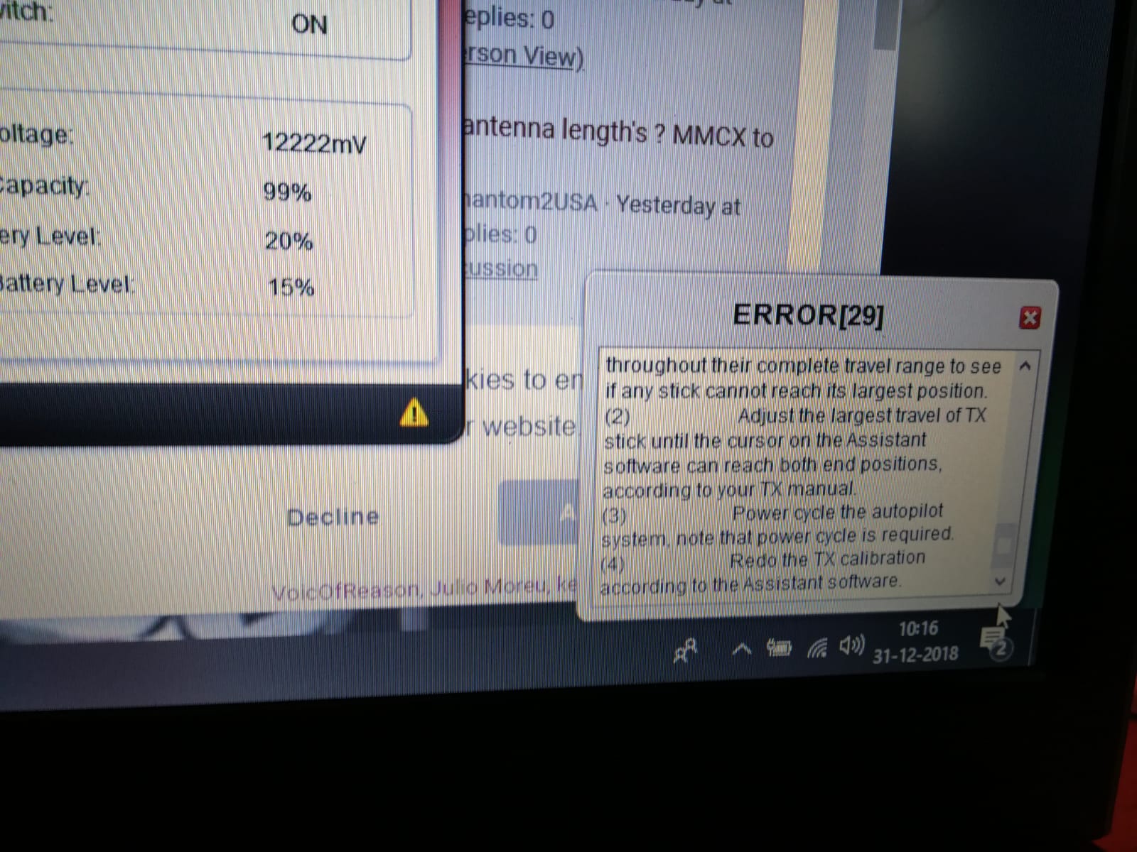

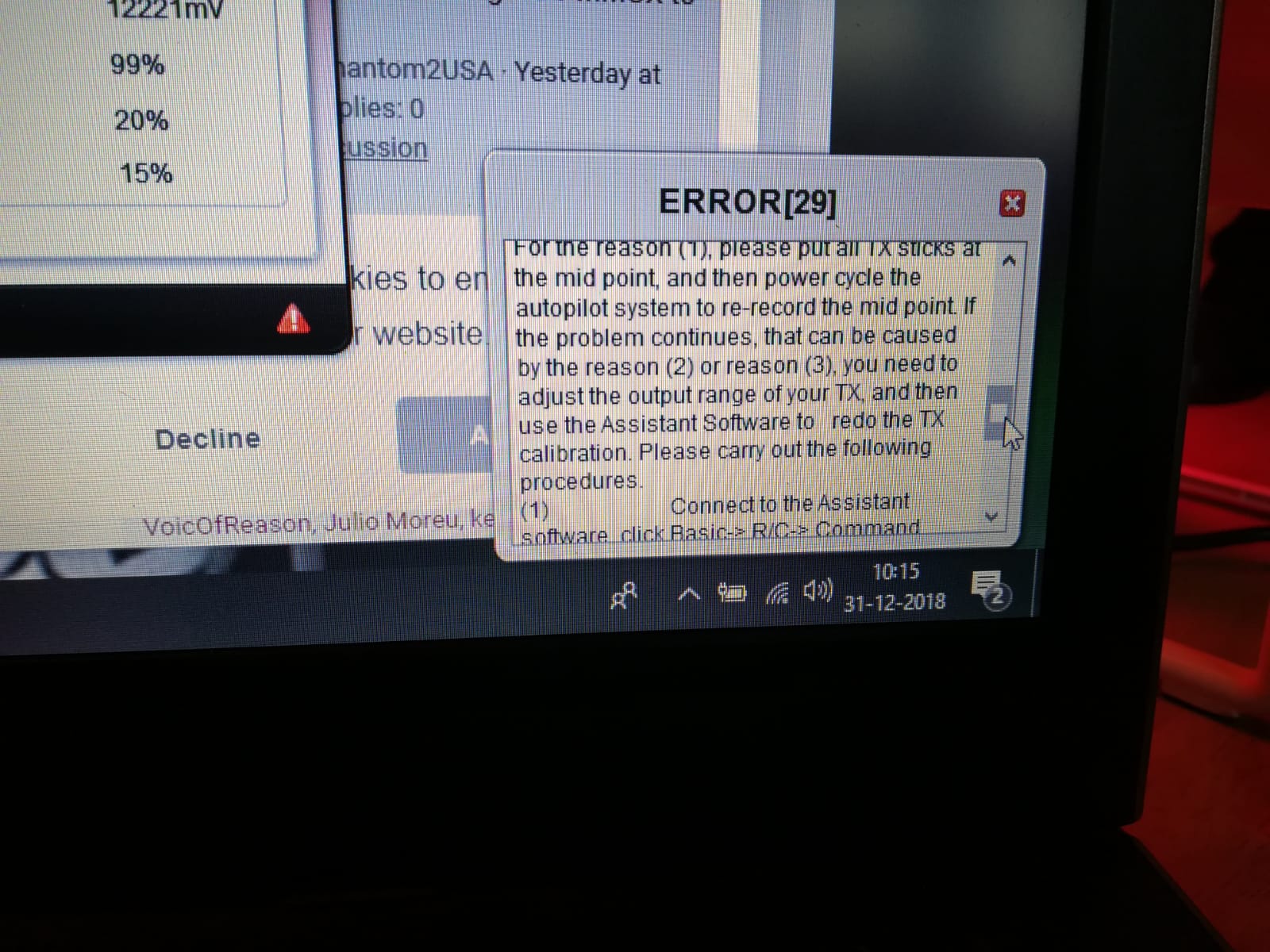

Have done the calibration basic and advanced pictures are here below

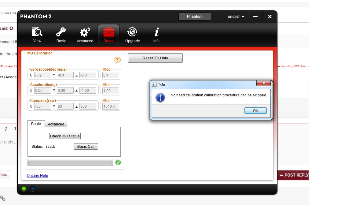

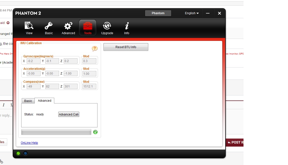

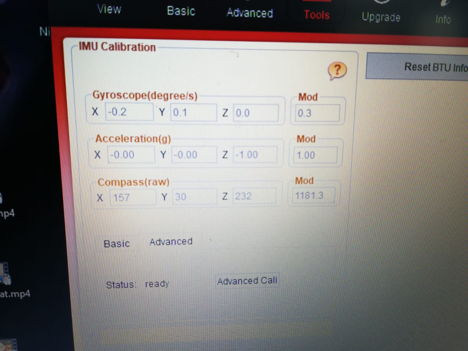

For one thing, the compass mod is too low. I would like to see a full screenshot of the upgrades and tools page.

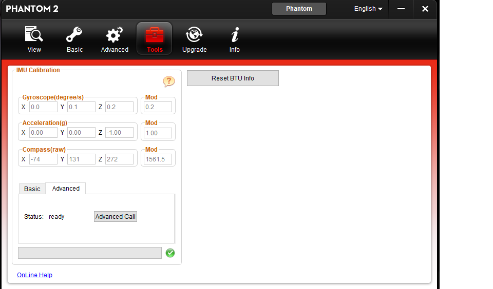

Hello jason here are the screenshots i recalibratet de imu in basic and advanced.
i hope this what you mean.
View attachment 106913View attachment 106914View attachment 106915
After a crash always do an advanced IMU never the basic. It's also a good practice to do advanced IMU at least once a month. The Compass Mod looks good.

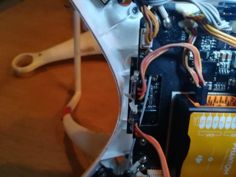

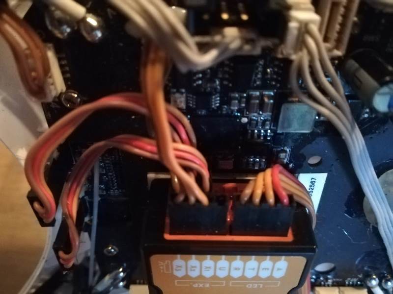

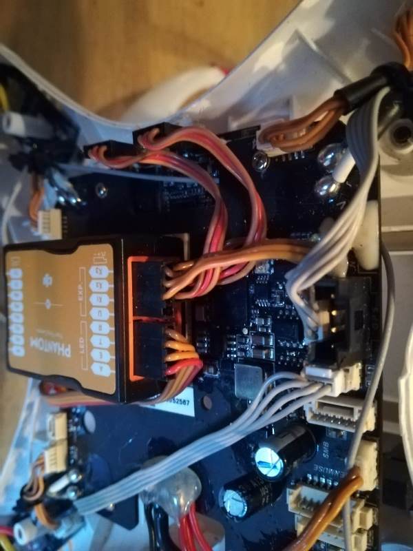

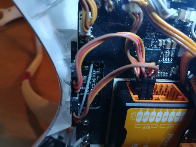

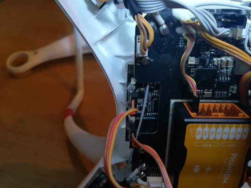

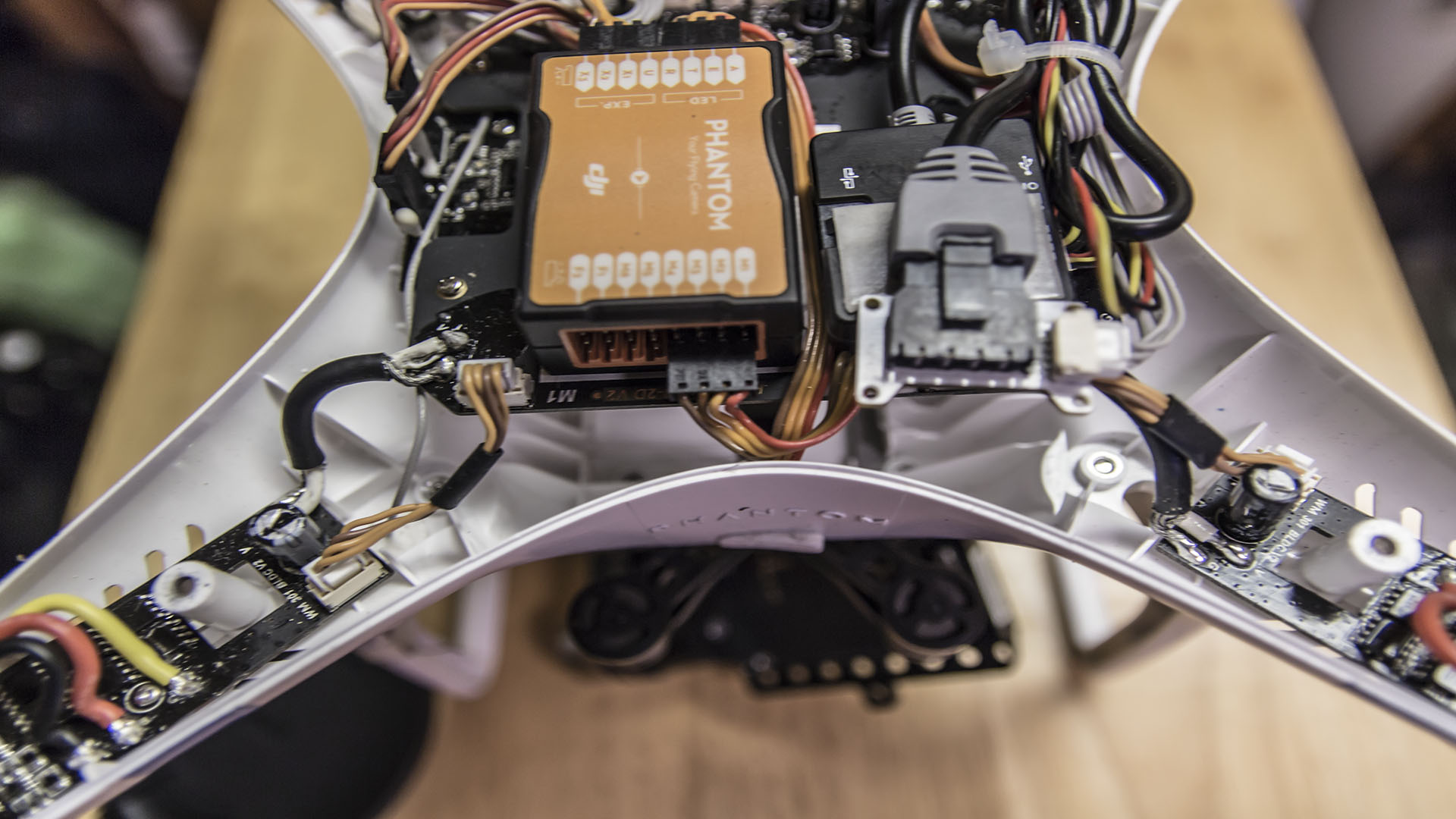

When you say you've changed the flight control are you referring Naza model taped to the mainboard? If so I'd like to see a good detailed photo of that module front and back for the wiring connections. I would assume you didn't take a photo before changing the module and you may have plugged it up wrong.

hello jason here are some pics of the flight controller and how i connected the wires.
the numbers of the controllers are DJ6 and PVT581 they will only connect to their own quad.

Check the back plug on the controller that it's plugged into the Naza module correctly. Bottum row with brown wire to the left. the only photo you didn't send.
hi jason didnt take a picture of that because it was just one,but that wasnt smart because it was the other way around,i changed and calibrate the bird again i will have to take it for a spin but its raining here so not good to fly.

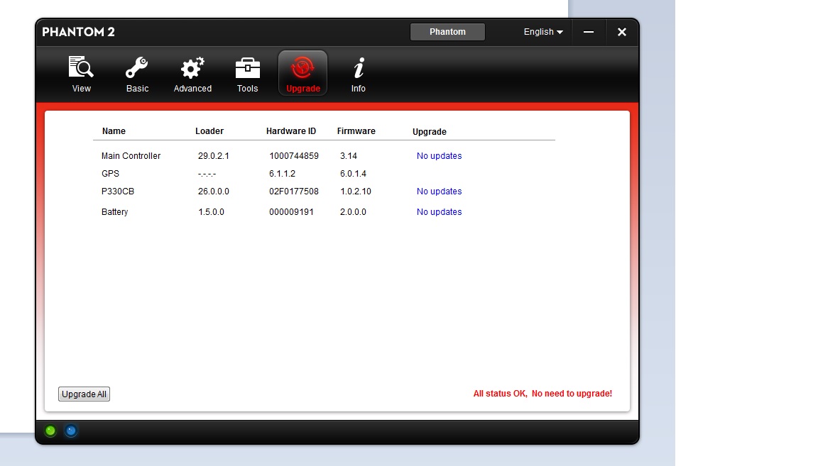

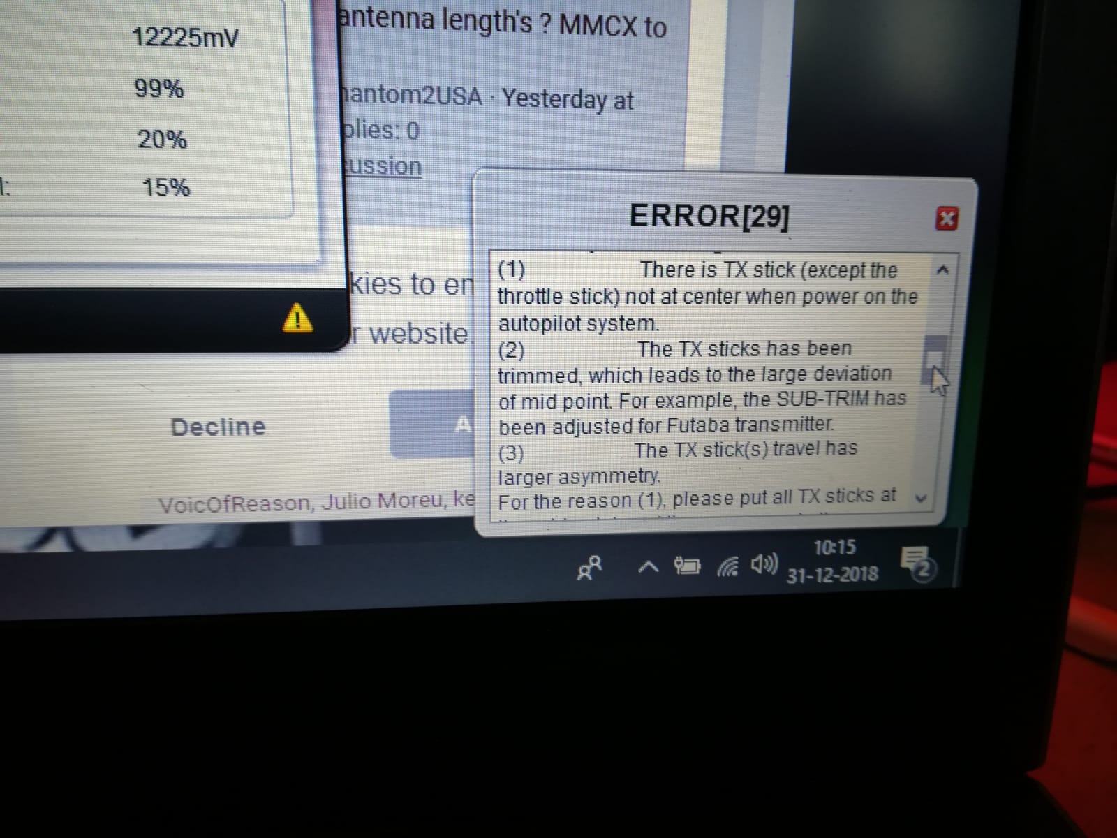

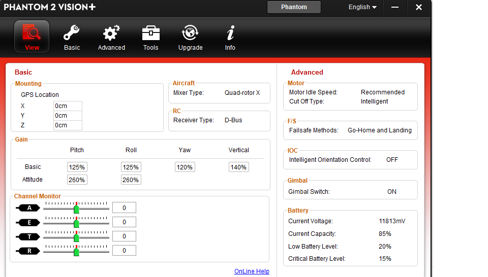

here are 2 screenshots the gain is that correct?
1,473,785
