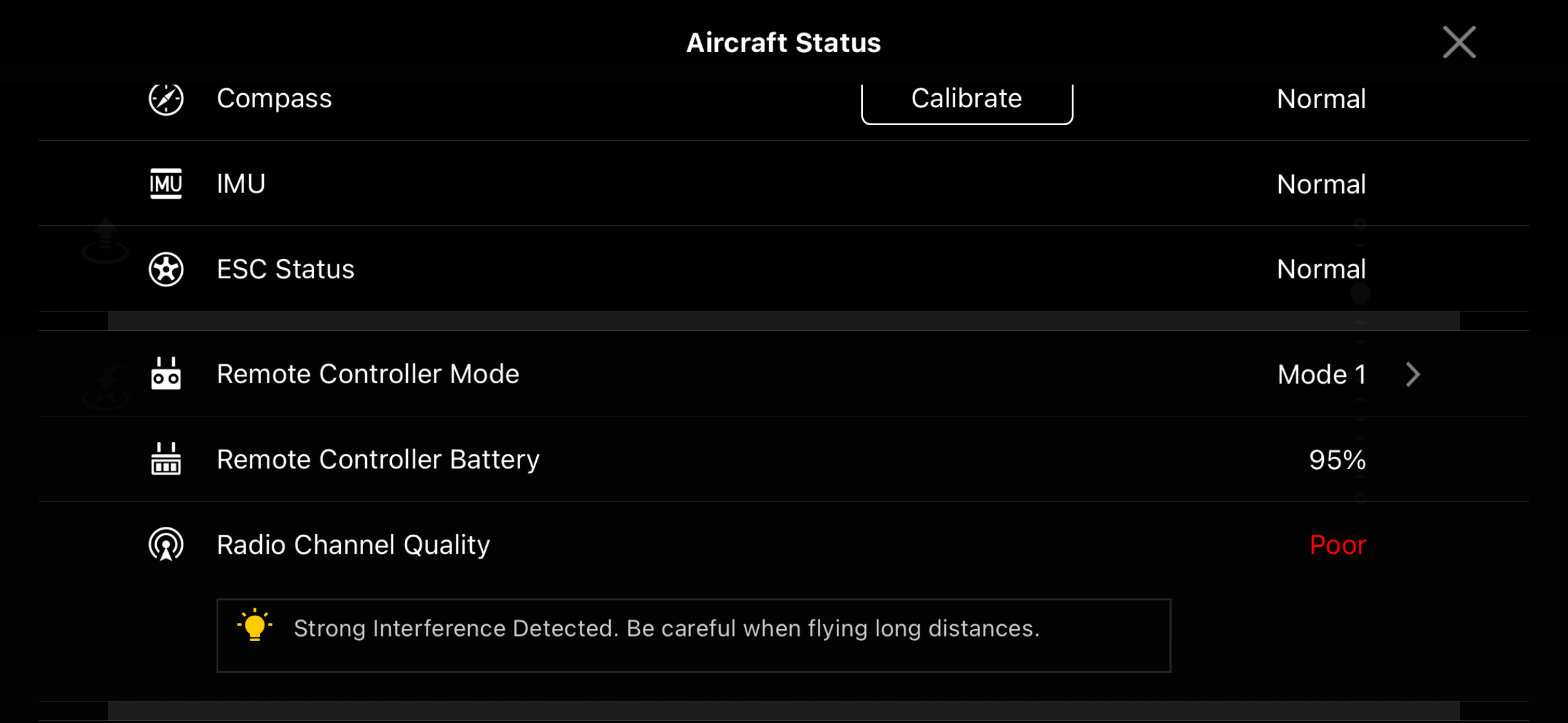

Just removed the SD card and tried pairing using the manual and DJI link method both of them are not working, the controller beeps and the link light on the Ac flashes but no connection at all the DJI go app says Aircraft Disconnected

Just removed the SD card and tried pairing using the manual and DJI link method both of them are not working, the controller beeps and the link light on the Ac flashes but no connection at all the DJI go app says Aircraft Disconnected View attachment 126180
Ok. Darn. I'll troubleshoot the subject a bit more. Maybe your 'drone guy' has a few ideas..........
