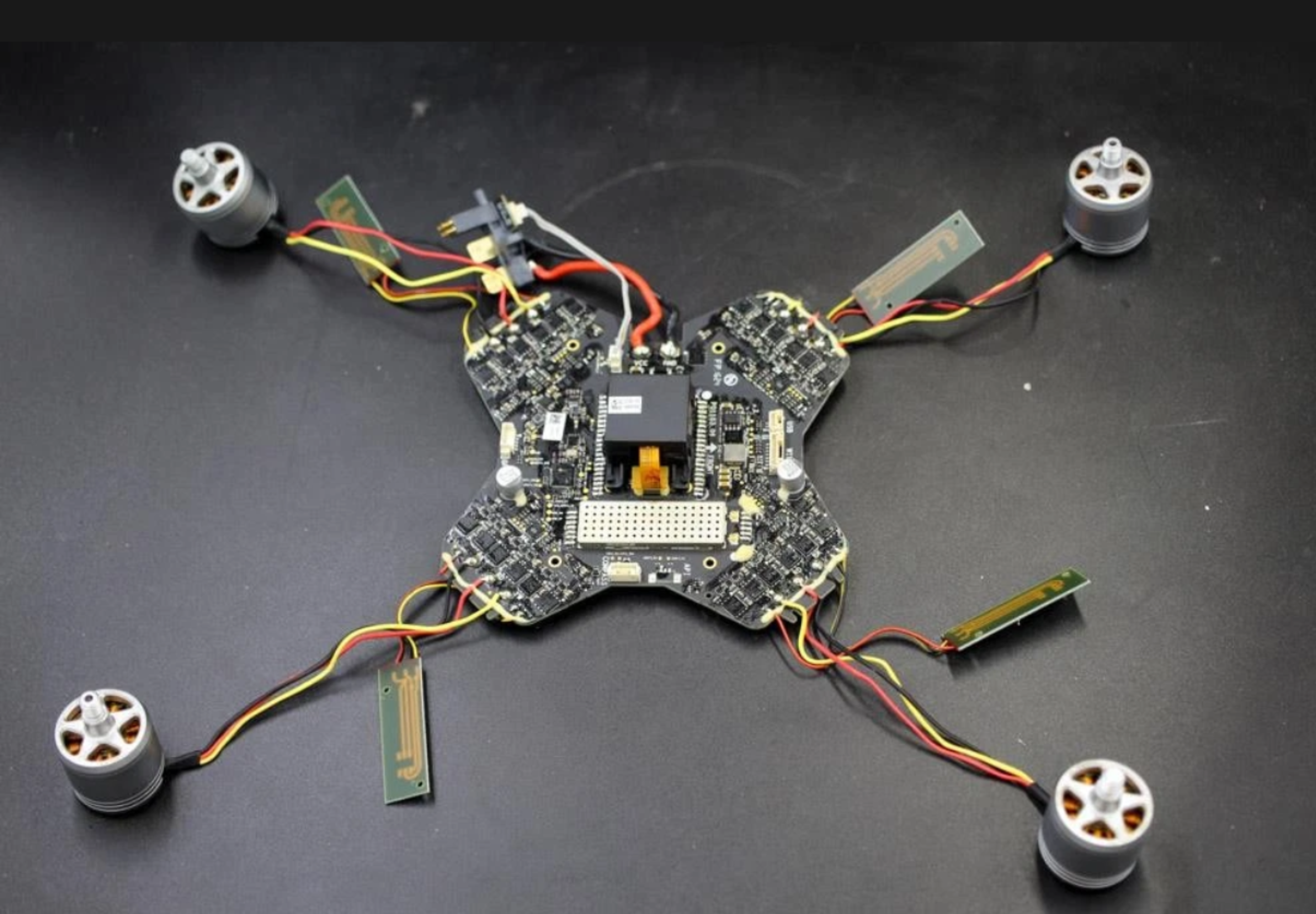

You can check around with sites like 'Flea-Bay' , or drone repair shops in your area. There are two routes you can take in repairing the drone.
One is to replace all 4 motors...2 CW and 2 CCW. Two is to replace all 4 motors AND the center ESC board as one unit. This is pretty much 'plug & play' since there is no soldering required. Just replacing only the 4 motors requires desoldering the original wire connections, and soldering in the new motor wires. Splicing the motor wires usually fails, although some have done it successfully. So, how are your soldering skills ?
Welcome to the Forum. Don't get discouraged too quickly. Many of us have had similar experiences, and will offer any advice and guidance that will get you back up and running.
Don't jump at the first set of motors that you see for sale, .......or a complete motor/ESC board. Many members part out their older drones to other members that often need replacement parts.
This is an example of a complete ESC motherboard with motors, leds, and main power connectors attached........
