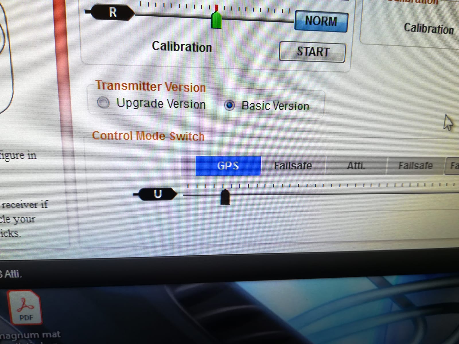

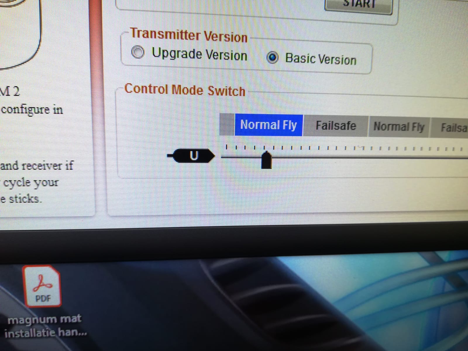

hi guys sorry for the late reply but was kind of busy i hooked up the quad to the program again and what i noticed was that in phantom mode it gave normal fly
and in naza-mode it gave gps
so if it gets dry today i will take it up for a try.
