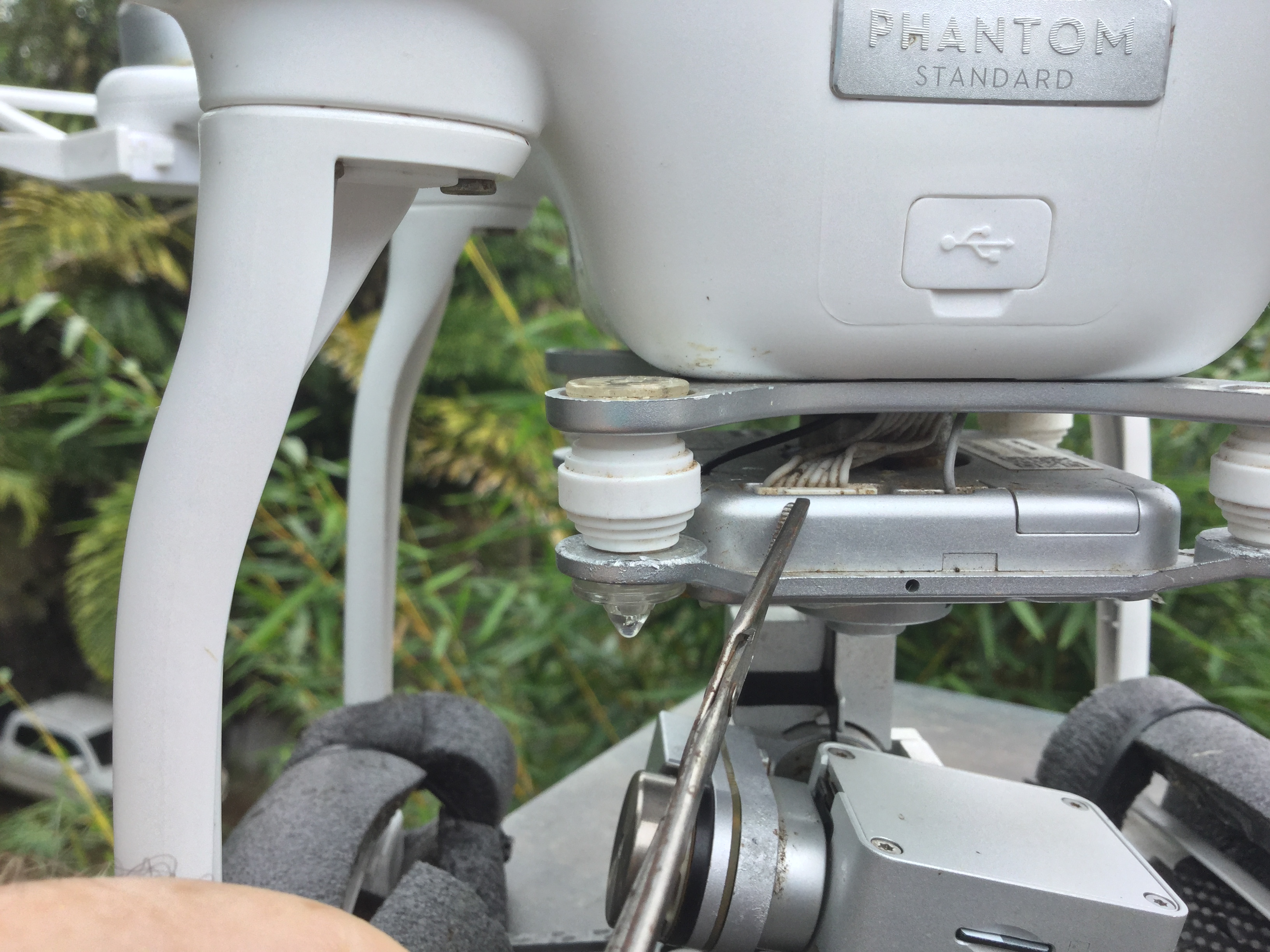

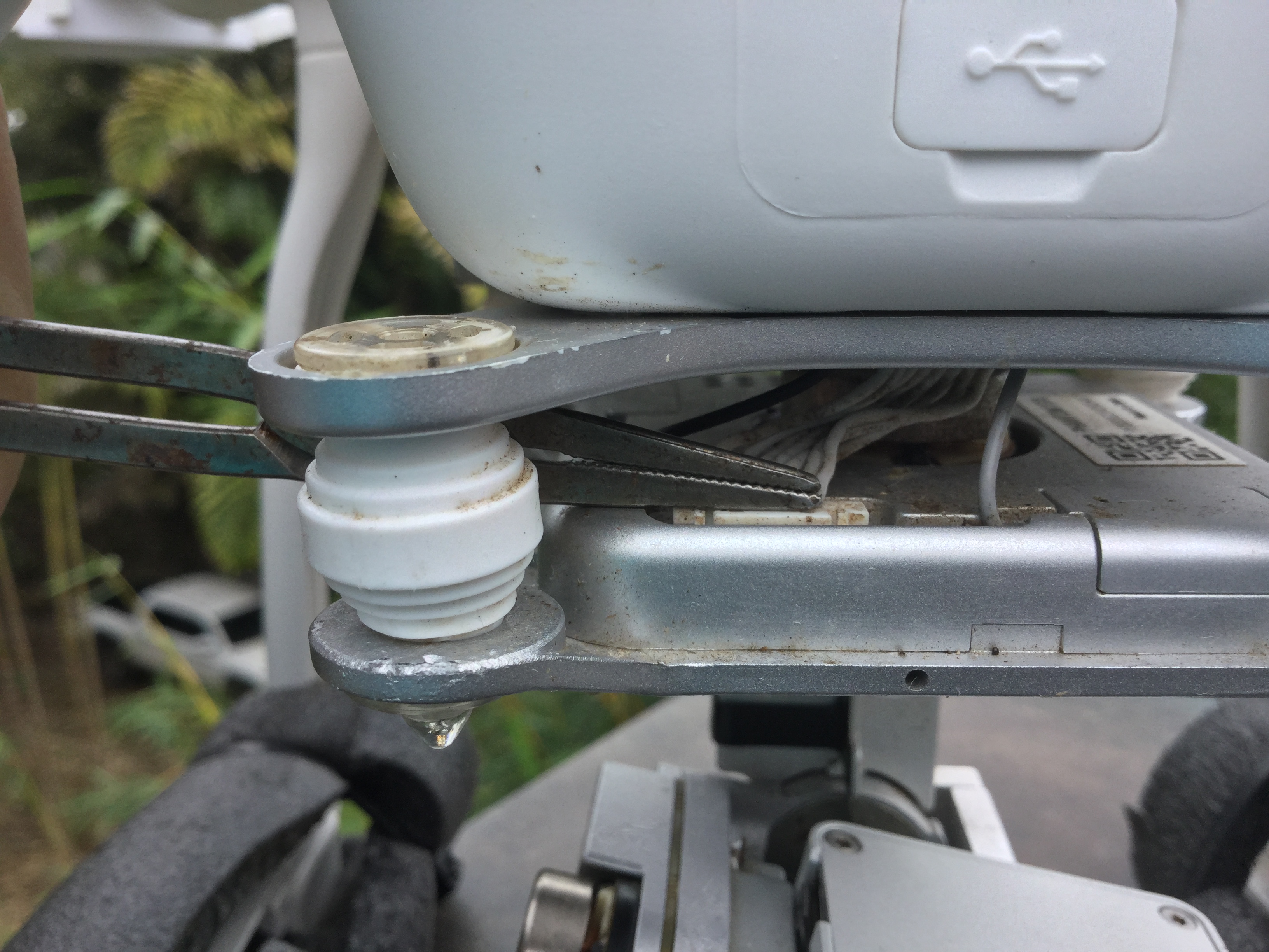

Please check the wires at the top..Do this with the battery removed...use a non conductive tool and press down into the connectors..
I have a P3S and I got the same gimbal message error. After a lot of studying I could find no solution
Electricians alway check connections or splice points.
After pressing all the wires down into their connections, installing the battery and starting the aircraft and controller...IT WORKS...
Good luck...Semper Fi
I just gave it a try and it seems nothing changed, thanks anyway for the tip Doug!
