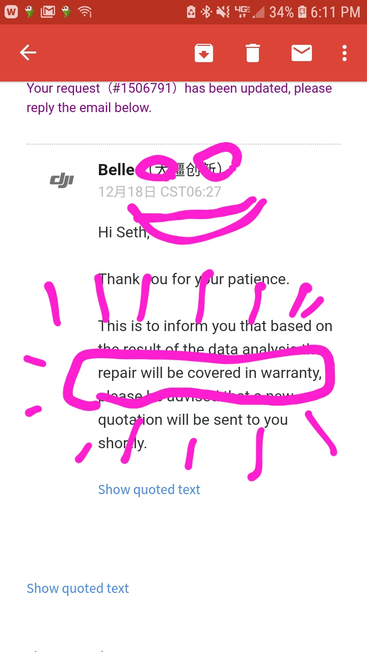

Good news for Dallas Drone GUY...
That's good, although pretty inevitable. There was no way they could argue with the motor data from the DAT file.
Very true but it's really not over until the fat lady sings. And technically I haven't heard any singing yet. Hopefully they don't play any funny business with a new battery and a new set of props as well. Thanks to you and the other guys for your interest in this crash case. Analysis on this forum really helped me get them to take another look and reverse their initial decision.
Reactions: DKG13CC and HABU1AZ
