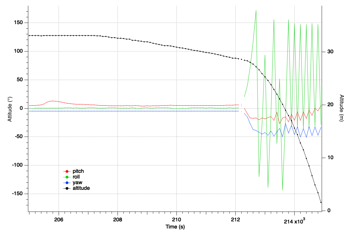

check the my previous post on this thread if you're interested. I'd appreciate your opinion. I just uploaded the Air Data link for the flight in question. I don't see any clues here, but maybe a trained eye can see what may have happened.
Thanks
I do not see any reason for the bird to drop, but I have seen you analyze these logs many times, and I have never looked at one until tonight. Do you see what may have led to the failure??
It has the characteristics of propulsion loss on one motor, but it is preceded by several seconds of apparently uncommanded descent. Best guess based on those data plus the event stream log would be ESC failure.

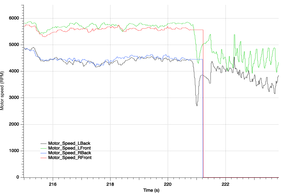

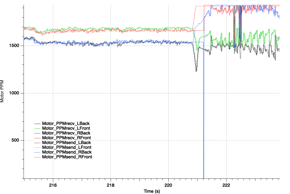

I don't recall any similar V2 incidents. Can you pull the DAT file from the aircraft - that will have the motor data.
How to retrieve a V3 .DAT File from the AC
Here is a link to the DAT file that I have placed in Google Drive. This is the same file I uploaded to AirData which generated the Airdata link above.
FLY066.DAT
I didn't realize that AirData reads DAT files. That must be new. Anyway - both right side motors appear to have failed - probably an ESC failure.

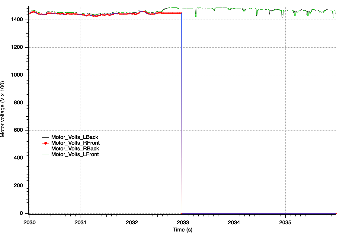

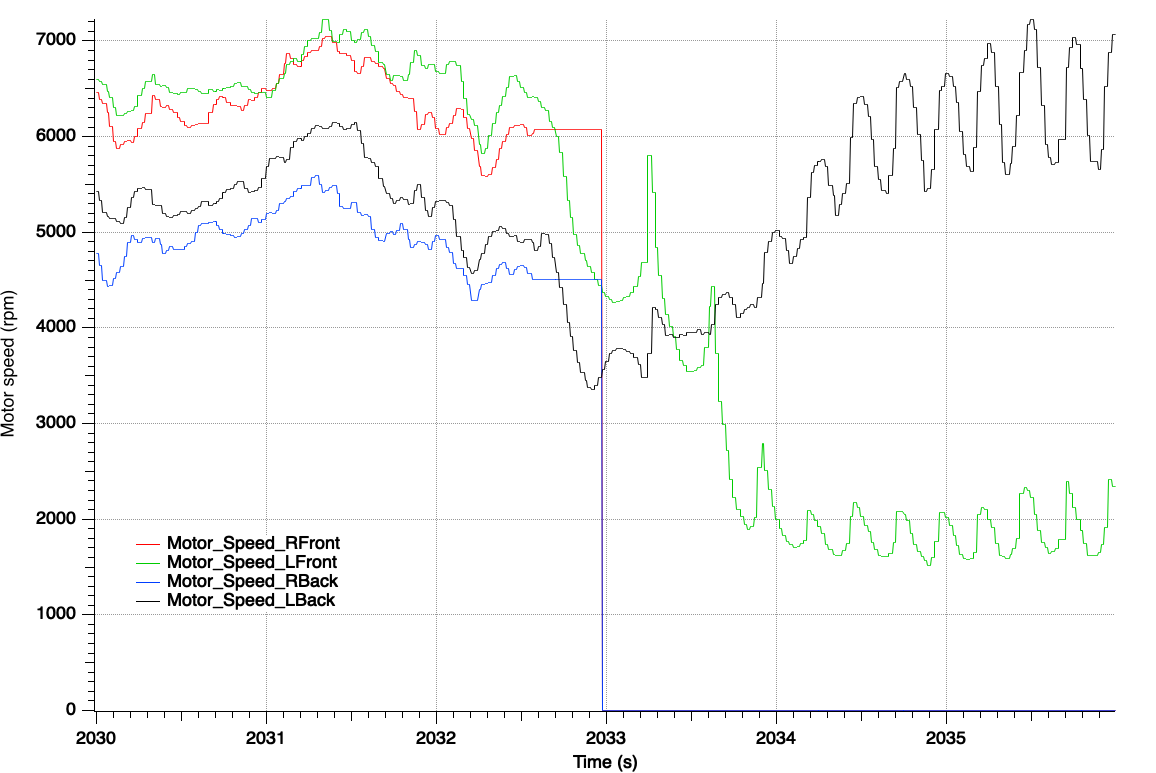

Well would you believe it---the refurbished bird that DJI sent me about a month ago in response to the failure noted on this thread FELL OUT OF THE SKY THIS MORNING!! Makes me think that V2 owners should be very concerned. Here is the DAT file link to google drive (pulled from the drone) as well as the Airdata link from a text file (pulled from the tablet I was using). ESC again!?! Thank God I didn't hurt anyone. Two houses down a guy was washing his beautiful black sports car. Could've hit his car or HIM...
FLY091.DAT
FLY091.DAT
Same two motors shut down again - right front and right rear - looks like ESC failure again:

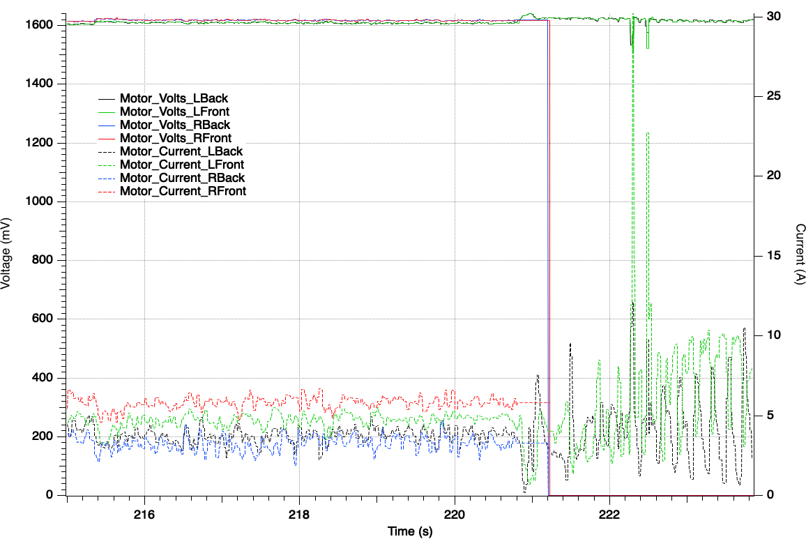

ESCs cutting out due to low battery voltage. If that is the case is there anything you can purchase to get a more detailed measurement on the Phantom battery as most of us depend on the lights and controller readouts.
Reactions: RFP
It had nothing to do with low voltage:
