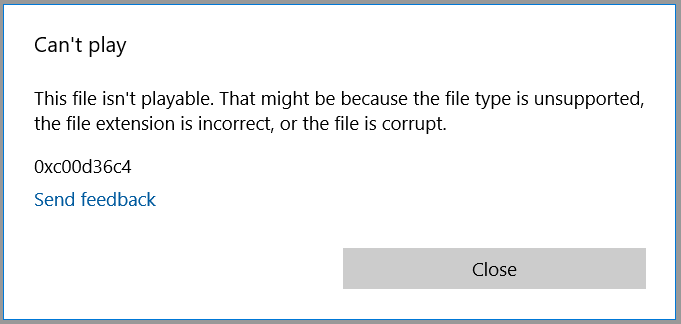

I will check my tablet for live stream recording, but recording from the micro SD card in the Drone did not give me a good file. The other 23 video files play fine, but because this file ended with a crash without me hitting stop, the file was corrupted and will not play. I am not a tech Guru and I do not know how to mend the corrupted file to be able to view what I recorded prior to the accident. Any advice or links that would help me mend the corrupted file would be greatly appreciated. Thank you SAR!
That's a common problem when the recording is not stopped properly. You can generally fix the file just by powering up any DJI aircraft with that card inserted.

It's not a file system problem - just a single file that wasn't closed properly.
I read the same advice on a different forum when I was searching for a fix to the corrupted file. 2 days ago I flew a totally new Mission with a different Phantom 4 Pro using the same SD card (the crashed v2.0 is currently in CA) which contained to the corruptfile. When I completed my mission my new files were perfect and viewable, but the corrupted file still would not play. Prior to the new mission, I renamed the corrupted file and it was not within the DCIM folder. Would that make a difference? Because the file still will not play. I am currently on my smartphone but tomorrow I will get on my computer and follow the above-mentioned protocol to try to mend the file.
Yes - you will need to put it back in that folder.
I put the file inside the 100MEDIA file which is inside the DCIM folder on the microSD card. Put it in my P4P (non v2.0) and fired it up, let it run for a few minutes here on the desk. Still no mending:
I will upload to Google Drive and share a link if one of you folks think you can repair the file I'd be very grateful.

Update: I found a way to fix it and looks promising. Here is a Screenshot of what I got so far. Haven't seen the crash yet.View attachment 106264
Awesome! thanks. That's the shot alright. I basically just go up and back until disaster strikes. You can see that I am above the roof level to start and only go up from there; not sure what I could've hit!! Update from DJI - I submitted screenshots of SAR's analysis along with my own commentary and they agreed to submit for another (hopefully more thorough) analysis of the flight records. Fingers crossed that they do the right thing here. Quoted repairs that they wanted me to cover were $300 plus $170 for new battery totaling $472... let's get it down to ZERO!! :)
The video stops before anything happens:
Dropbox - DJI_0024-repaired.mp4
That is unfortunate and strange. My memory is that the video was much longer than 12 seconds, maybe 20 or 25 seconds. I've no idea why it would end at 12 seconds. One thing I'm certain of is that video was still being sent to my monitor after the aircraft went out of control. I watched the horizon spin briefly before it said aircraft disconnected. I'll be sure to update the thread when I hear back from DJI again. I also have a thread going on the DJI Phantom forum to make very public all of my troubles, try to do everything I can to nudge them into the right direction.
Strange, the "Follow the yellow brick Road" guy's comments are all gone... Can you see them? Anyway, I have pulled the video cache from the tablet. It is also corrupted, but maybe would show the tumbling at the end? DJI says 2 days for data validation then another 2-5 business days for analysis :/
2018_12_01_13_00_51.mp4
That file is also corrupted, will not play in any codec.
This video was 8 seconds long, but it goes corrupt after just 4 seconds. The video from the SD card had more information.
Dropbox - 2018_12_01_13_00_51_repaired.mp4
Edit: Interesting enough, when I repaired the video on my pc, it only showed 4 seconds, but once I uploaded it to Dropbox, it shows up to the point of the failure and the Phantom spinning out of control.
I was able to see the Spinning however when I attempted to edit the video the data is lost. Ugh
So that spinning is part of the puzzle, if I did not know better I would say that you lost a Prop.
