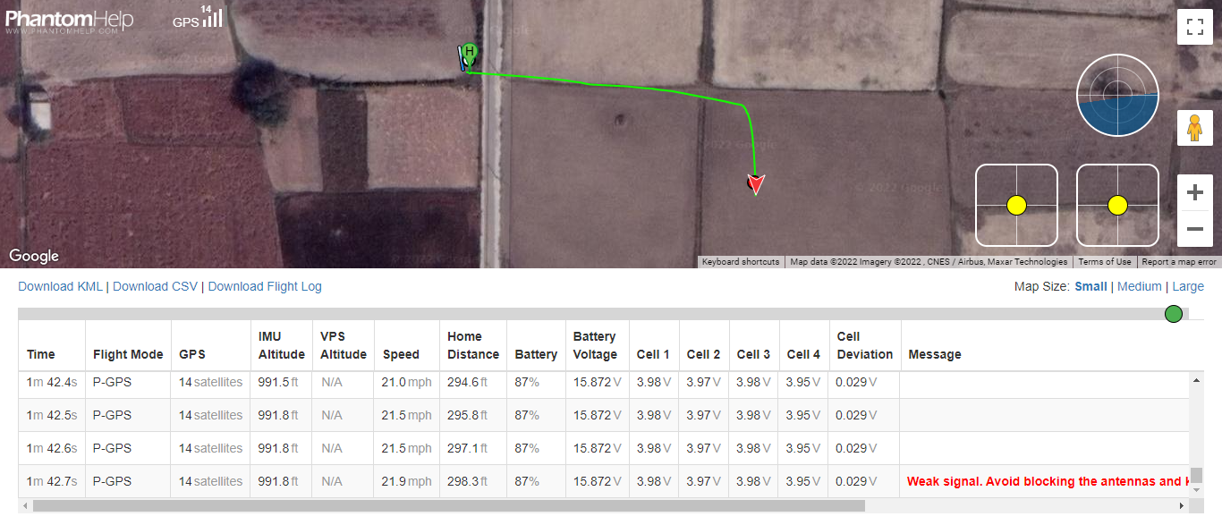

With the help of google I managed to take flight data from the TRANSMITTER and decoded it using Phantomhelp LogViewer which didn't help much as the last message came out was Weak Signal.
How do I read data from the Drone unit?
Below is the appeared record.
Obviously, the problem was with the signal. We don't know how you've set your RTH parameters.
But free fall as you described shouldn't have happened. Must be something with the power loss.

Check out
How to retrieve a V3 .DAT File from the AC
which shows you how to use DJI Assistant 2 to retrieve a .DAT log from the P4.
If you can't power up the P4 then you'll need to extract the internal SD card that contains the .DAT log file.
