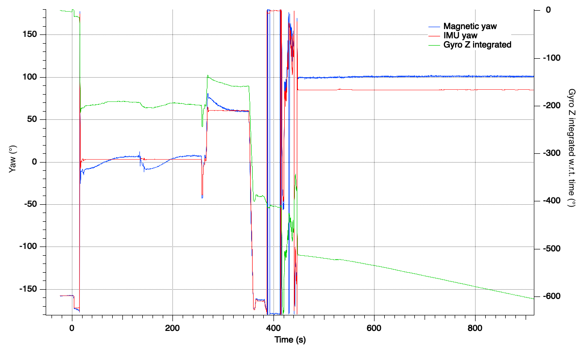

The rotation is clearly visible in the data. Somewhat curiously the compass and the z-axis gyro both see it, but the sensor fusion output shows indicates that the aircraft is not rotating at all. At the end of the flight the gyro is showing CCW rotation even though the compass and the FC show the aircraft as stationary. My first move would be an IMU calibration, but you mentioned previously that you have done that.
I suggest a simple test, which can be done either in flight or just holding the aircraft. Power it up and then slowly rotate it through more than 360° clockwise, and then counter-clockwise, and post the DAT file.

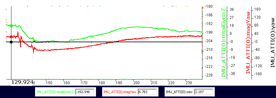

The uncommanded Yawing is normal in the sense that the FC sees an incorrect Yaw/magYaw separation that needs to be reconciled. It does this by holding the Yaw value fixed and then rotates the AC until it sees the correct Yaw/magYaw separation. This strategy first appeared when the mavic Pro was introduced and, I think, has since been incorporated in all the DJI platforms. Note, that at times 17 secs and 137 secs the Yaw/magYaw separation target was close to the geoDeclination which is the initial target.
But, the question remains what causes the Yaw/magYaw separation in the first place. I really don't know why this is. But, it appears that the FC is holding the Yaw value fixed when it shouldn't. E.g at time 132 secs the AC rotated as can be seen by the totalGyroZ and magYaw data, but the Yaw value is fixed.
The rotation wasn't actually commanded since there was no rudder input, just aileron, elevator and throttle inputs. Maybe the FC thinks the Yaw should be held fixed since there was no rudder input.

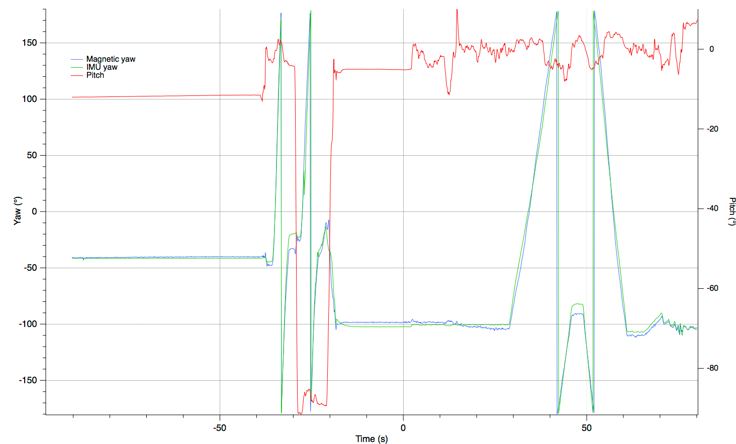

That looks pretty good - no obviously significant yaw problems.
You started that test with a compass calibration triggered by distance (obviously DJI has added that to the P4Pv2 firmware too), and that succeeded.

I'm not convinced. This flight (FLY055) doesn't duplicate the conditions under which the uncommanded yawing occurred in the first .DAT you posted (FLY047). In that flight there were just aileron and throttle inputs that caused the P4Pv2 to yaw a bit even though there was no rudder input. The result was magYaw changed but the FC held the Yaw value constant. This was then followed by the FC performing the uncommanded yawing to reconcile the magYaw/Yaw separation.

Doesn't seem like a roll or pitch problem per se. In his flights there is a bit of yawing when an abrupt roll or pitch happens. I suppose that's normal. But, the FC holds the Yaw value constant even though it's clear from both the magYaw and totalGyro:Z that the AC has yawed.
