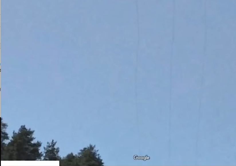

This YouTuber posted a follow-up video clearly showing that he flew into power lines. It was definitively not a battery disconnect issue. Also, is there evidence to back up the claim that the battery tab introduced with the version 2.0 did not solve the problem?

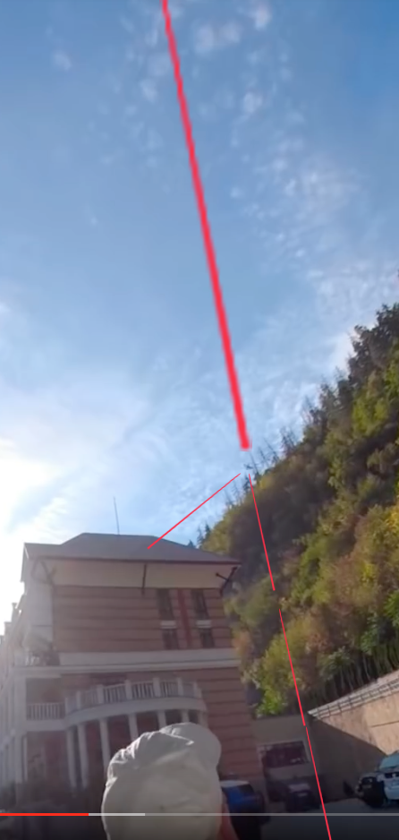

For the record I do not believe that any power lines were hit, just doest not add up for me.
The point of vertical take off was over the steeple on the building, the drone landed 10 ft past that.
The camera stopped recording in Mid Air this is a very telling tale of power loss.
Just look at these pictures , I do believe there were power lines but not anywhere near where he was, he was in the clouds when the drone fell.
Notice the Power lines and the Tree height and how far away it is from the steeple 300 ft. Notice the Trees ,

Now look at where it all goes down: Directly over the top of that steeple as he was getting ready for the top shot down of the steeple.
That black spec is the drone going above the steeple, very small speck
Notice the Fall is straight down less than 15 ft from the steeple , notice the type of trees where the power lines are and what is showing here .
So yeah no one is buying the power line , nor magnetic interference from them as they are just to far away and much lower.
Power shut off in mid air, no camera, no recording. This was the take off over the steeple and than straight up past 100 m and into the clouds.

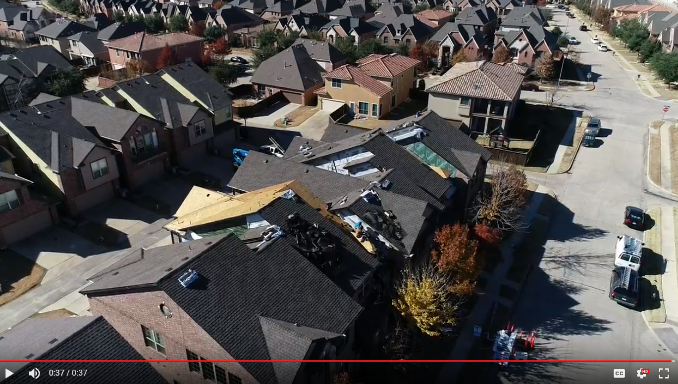

The creepy saying about what happens to me and the roofer I was working with, he just knew that I left the job site but didn't know why. He put his bird up and started filming the exact same house I was filming and his bird dropped out of the sky in roughly the exact same air space at the same altitude. It made me think that the homeowner has some sort of physics nerd contraption that it was testing out on us poor chumps. Realistically that is probably not the case. If somebody owns that kind of Technology could Market it properly and become widely successful.
question is: Did your new one fall in the same place as your first and your roofer Friend's fell
This recent crash was in the same neighborhood but maybe 1/4 to 1/2 km from the first crash. If there were some kind of interference in the area, wouldn't I get some on-screen warnings? or at the very least there would be warnings in the DAT file, right? Also, I have a paid job in this neighborhood documenting work crews and their progress, so I have spent a lot of time there. Maybe three hours on site 3 different times. I am open to any hypotheses!! hope this additional information helps.

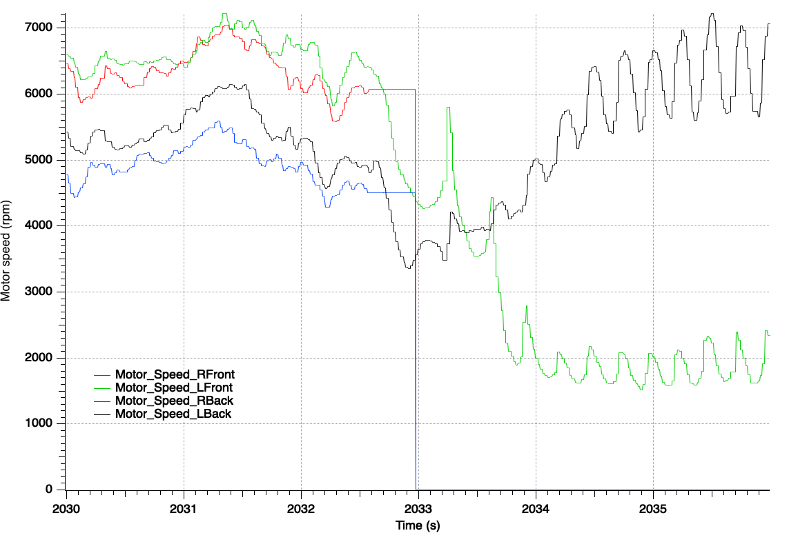

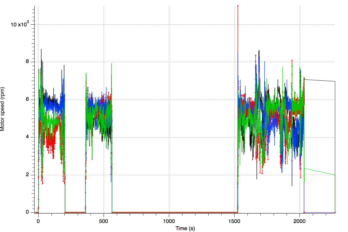

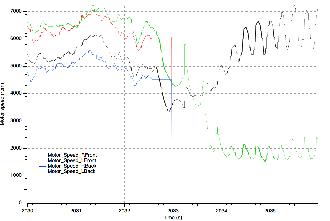

Same two motors shut down again - right front and right rear - looks like ESC failure again:
You should definitely have a word with DJI about that.

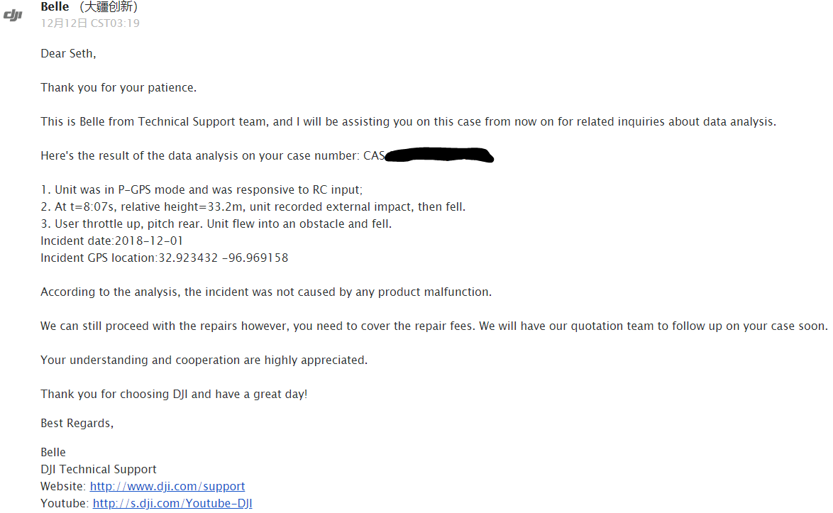

SAR, I wonder if you can have a look again at this thread and weigh in with your expertise. Today I received the flight record analysis from DJI... they say that I flew into an obstruction and crashed to the ground...PILOT ERROR! at 108 feet in a neighborhood of 2-story homes and all underground utilities. Can you point to something in the flight record that puts holes in this garbage analysis?? Here is the exact message from DJI. Not very happy about this to say the least...any help is much appreciated.
For anyone just landing here for the first time, I had an ESC error crash in October (v2.0 was only 45 days old) where DJI admitted hardware was to blame and replaced with a refurb at no charge. Then on Dec 1st, only 30 days after receiving the refurb I suffered another catastrophic fall out of sky crash. Now DJI says I flew into obstruction at 108 feet. Here is a picture of the crash area. Nothing in this neighborhood extends higher than the street lights. I promise I will stop crying over spilled milk and carry on; hopefully this thread can help others decide on whether to purchase the v2.0 if they were on the fence.

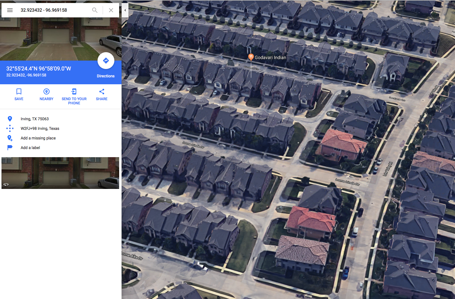

So this is what I Pull up form the GPS location from DJI :
108 ft does not really make sense, so puzzling
Their analysis is wrong. You were climbing and flying backwards but, as I posted previously, the two right hand motors simply shut down:

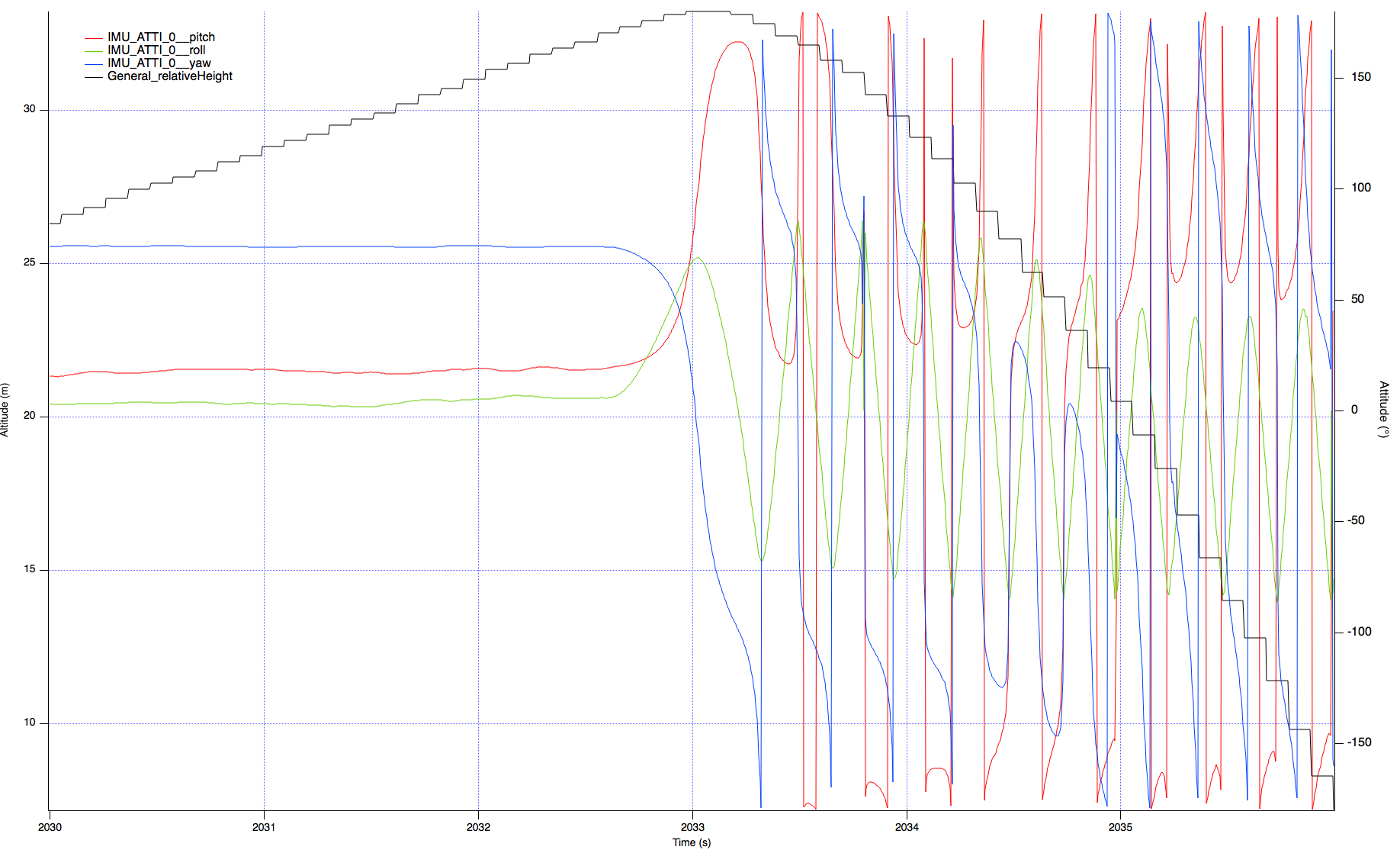

Looking at the pitch, roll and yaw we see the characteristic tumbling following propulsion loss, but no sign of an impact:

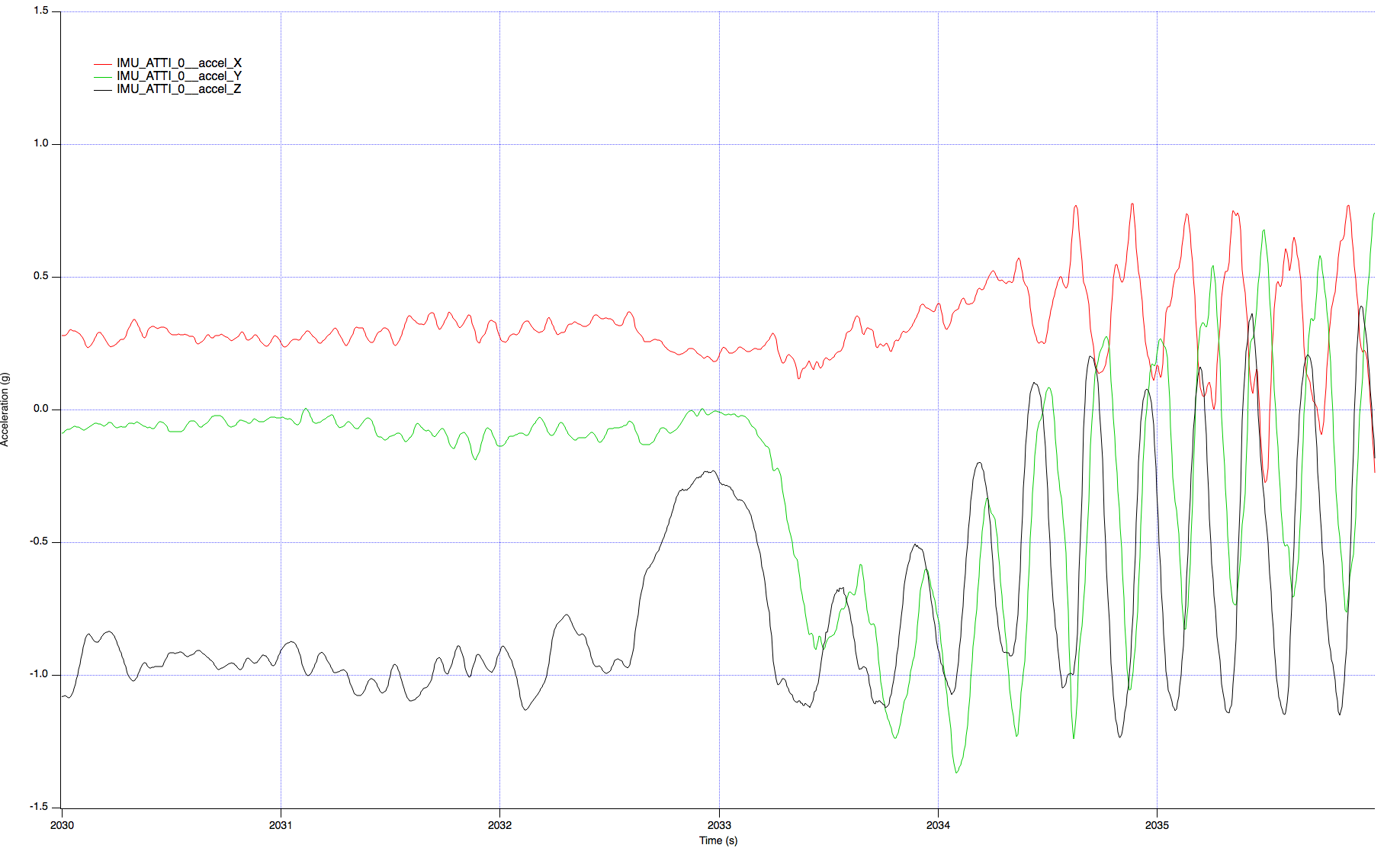

Finally - looking at the x, y and z acceleration data, there was no impact at all - simply a transition to the spinning, tumbling descent:
Note that the time discrepancy (DJI state the event at 487 seconds) is because they are measuring from the last takeoff rather than the original motor start in that DAT file:
It's disappointing that they would get it so badly wrong, but I'm sure that if you point out their error then they will take another look and figure it out correctly.
