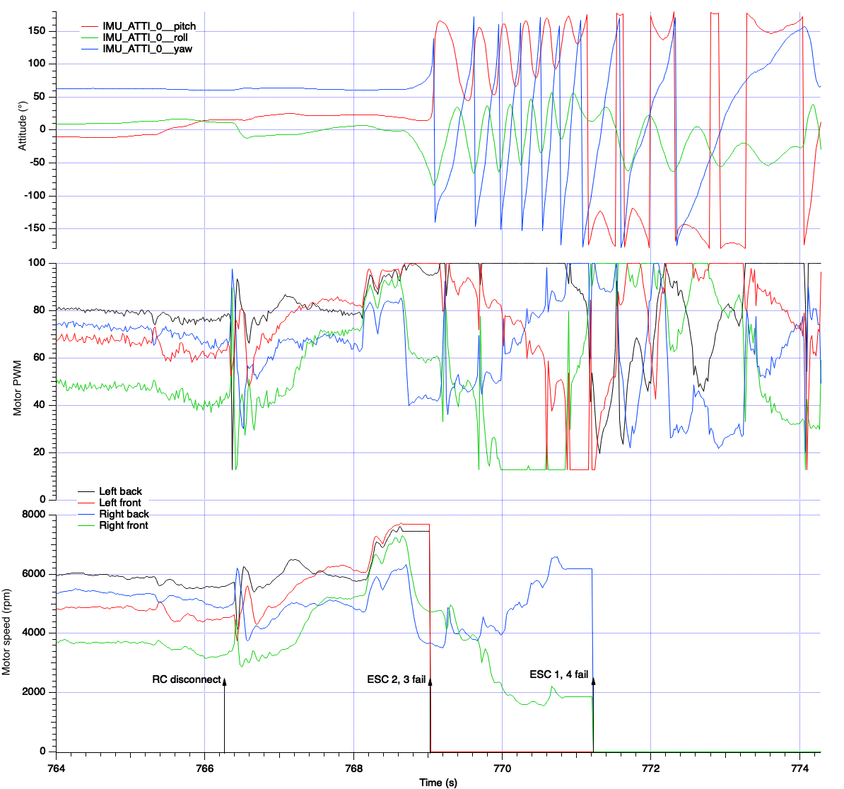

That's unusual - several things went wrong almost simultaneously, but I cannot see a causal connection. At 766.3 seconds the uplink was lost. That resulted in a sudden motor adjustment with the lack of stick input. No flight control problem there, but at 769.0 seconds the left ESCs both failed. That didn't go well, as you would expect. And then at 771.2 seconds the right ESCs failed.

And here is the result:
That looks like simple hardware failure, except for the strange coincidence (?) of the RC disconnect. @BudWalker ?

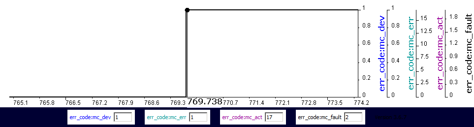

There also seems to be some kind of failure with the MC. The values mc_dev, mc_err, mc_act and mc_fault all changed from 0 at 769.738 secs.
