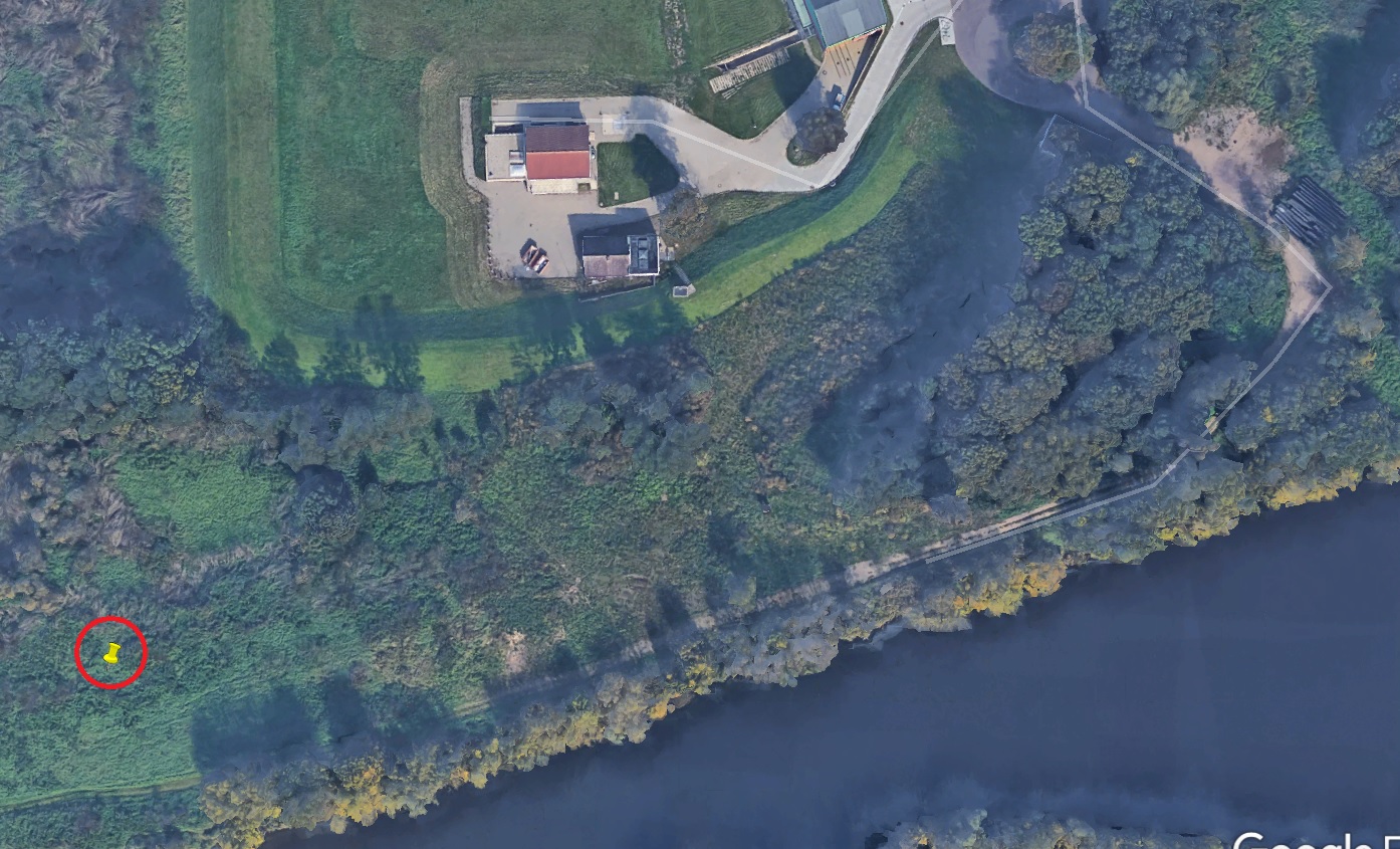

I only looked at the data from @msinger 's log, I say it headed the direction away from you in the second log until it ran out of power and did a Auto Land. My first focus was elevation changes and should have just kept going East.
Others are good in calculating speed, wind speed, battery power, and where an Auto land might happen.
Viewing the first log when I saw the home point changed and how close it was to you. :eek:
Oh-No
Rod
Reactions: Dr Crashmenot
As noted above DJI GO 3.1.2 contains a bug that can cause the home point to be reset to an incorrect location. Your Phantom should have landed here:
If you cannot find it or you find it and it's damaged, contact DJI support for help. They will most likely fix it or replace it under warranty.
you are the best and made my birthday the best i ever had [emoji2] [emoji2] [emoji2] i found it where you said it would be. can not believe it after 4 hours searchi g completely wrong.

So the end of the story is that the bird went precisely to the last recorded home point of latitude 51.52697204 degrees longitude 11.92622875 degrees. This is critical information for others having fly always.

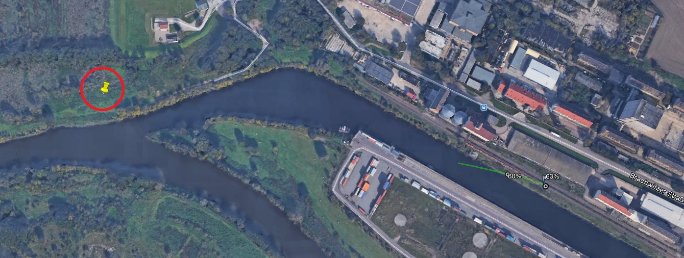

Sorry i dont know if and how I see the Home Point.
If I now search in the direction North West of what my DJI Go App shows me as my point maybe the drone is around there (also direction north west )on the accident place. Amazing is as well when I change from DJI 3 Standard to Aspire 1 in the App my location is correctly shown.View media item 3042
In looking at this map your north arrow is pointing right not up. If it were pointing up the northwest direction you referenced would have been toward where the bird was recovered.
Would be nice to know if when turning on the Go App in the spot where you initialized flight yesterday does the blue dot lay where you recovered the bird? If so that would explain the entire problem with the 3.1.2 version of the app. If it does not but is on the same bearing but different distance at least it can be partially useful information.
