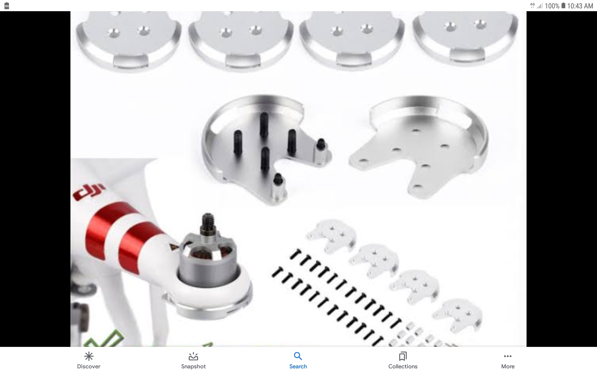

Ok you can get these,this just 1 sort but there many to choose from,,these mount under the motor to prevent further cracking and works as a brace,,very cheap too,,yeh,,gota watch those screws,,,these sets come with correct size screws,,,couple pics so you know how these work
