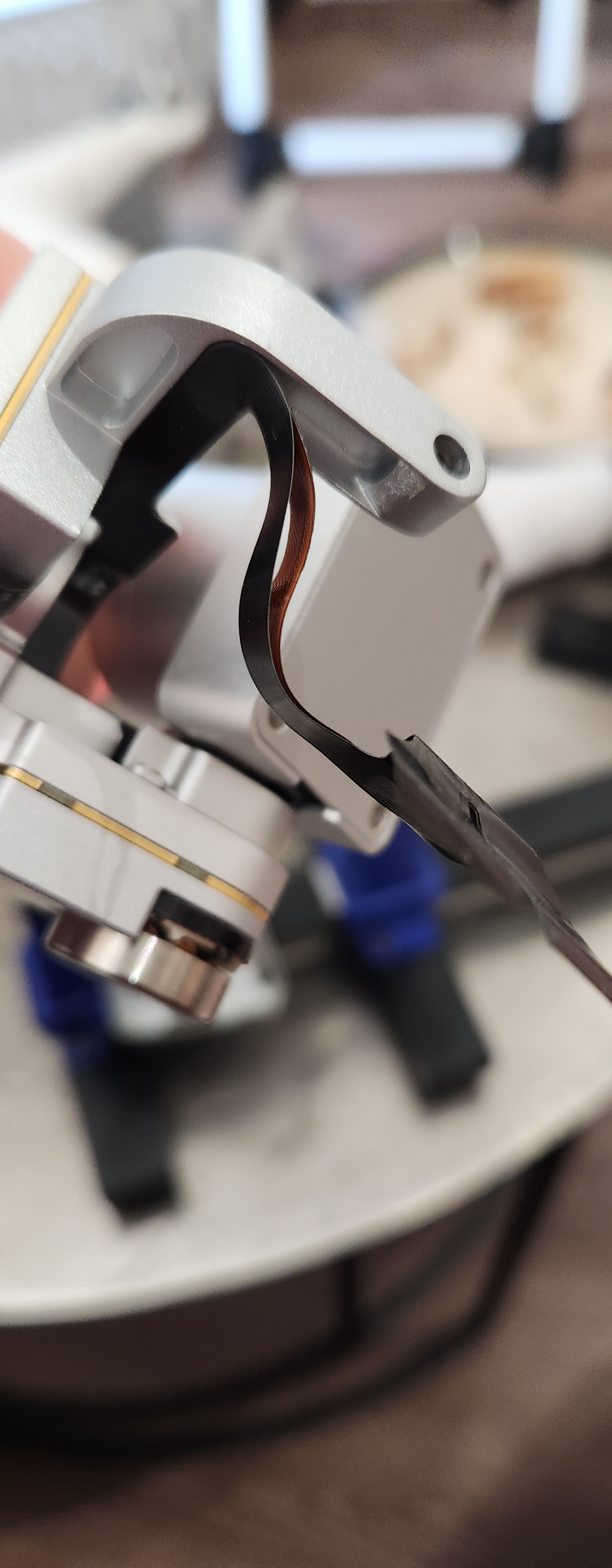

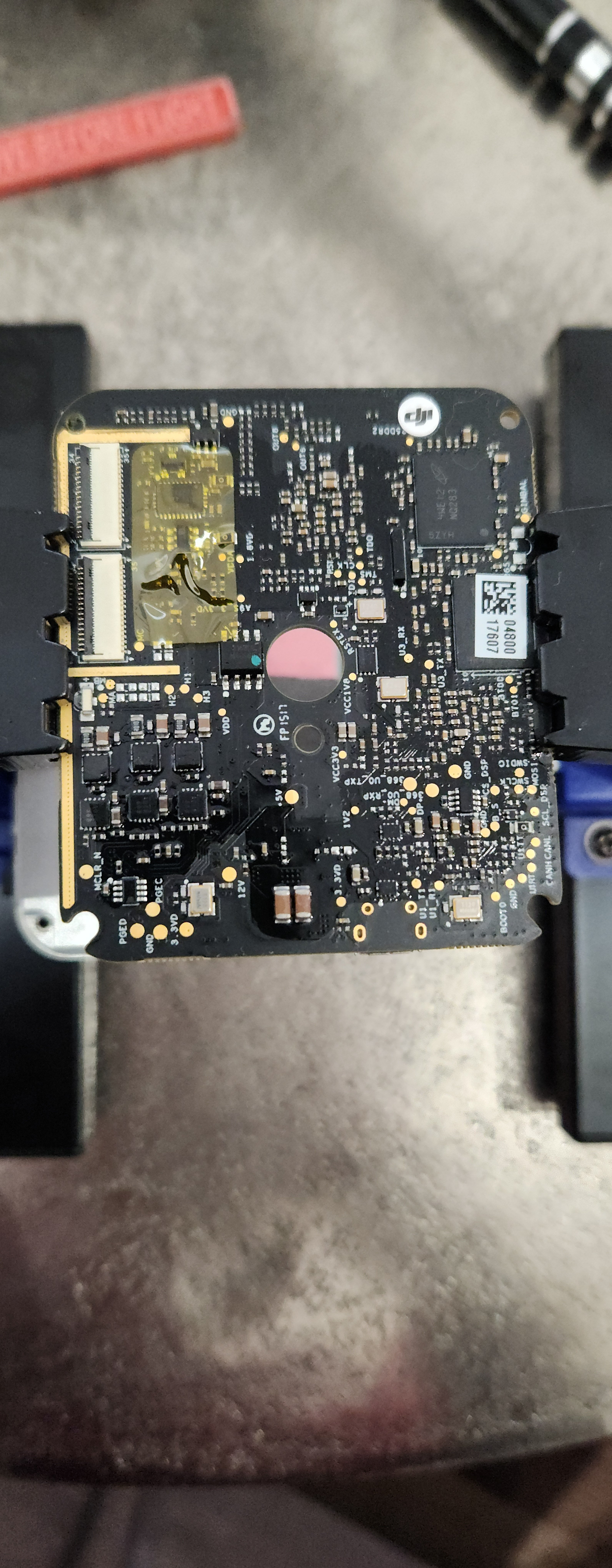

Thank for all your inputs I've disassembled the the camera gimble as I've brought a replacement ribbon the old one see attached is this normal or failed.
also brought a google nexus 7 2013 as my ipad was to new to run dji go.
Also 2 versions of the board.
That ribbon cable looks like it separated in the pic. Doubt if it will work correctly.
Hopefully your 'new' ribbon cable is 100% DJI OEM ribbon cable Part # 49. There are many copycat ribbon cables out there that rarely work correctly. They are extremely delicate and damage easily. Good luck.
