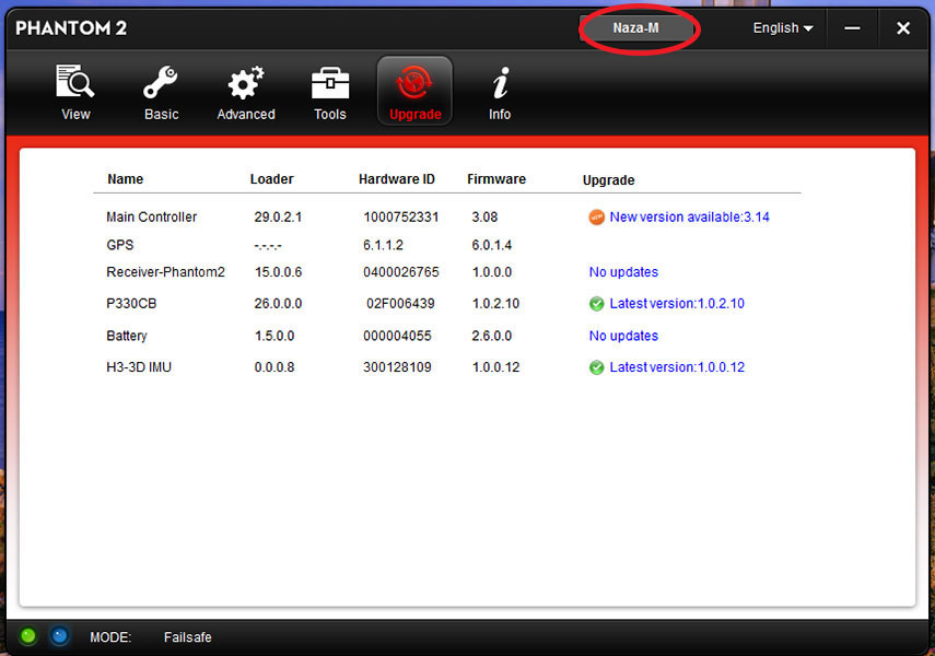

This photo show you where the switch between Phantom and Naza-M takes place that is if you downloaded the windows driver into the P2 first. If you never loaded the driver into the P2 the assistant software will not be recognized.

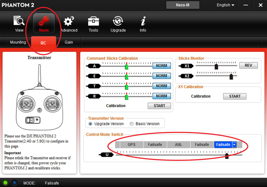

Naza-M has two parts. Part 1 adds ATTI to the center position of switch S1. In the pull down U ATTI, Failsafe and Manual

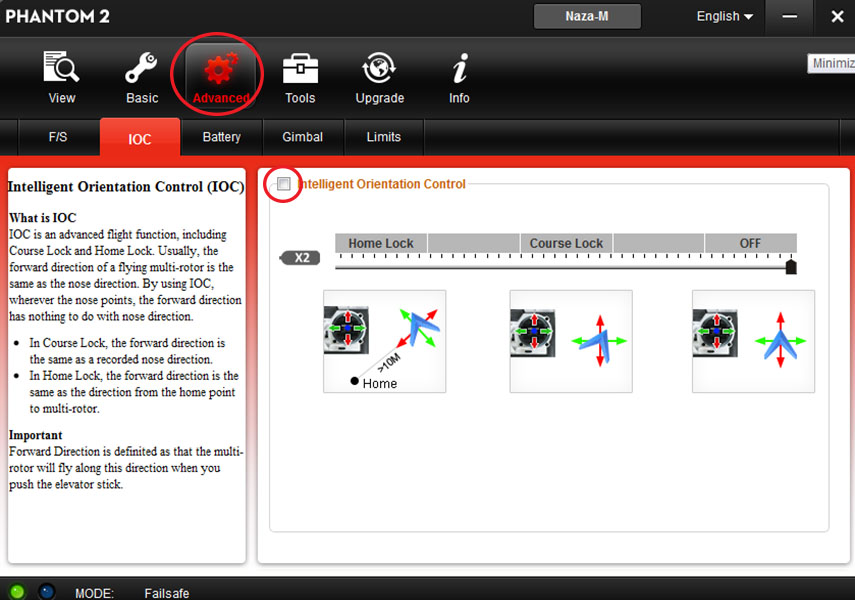

Part 2 Once you check the IOC box you'll have the same functions in part 1 plus you have activated switch S2
Switch S2 also has the function of allowing you to change the home point while in flight. That information can be found in the user's manual v1.4 or on youtube.

Ok I just tried enabling IOC and for some reason it won't. Does the controller have to be connected?
