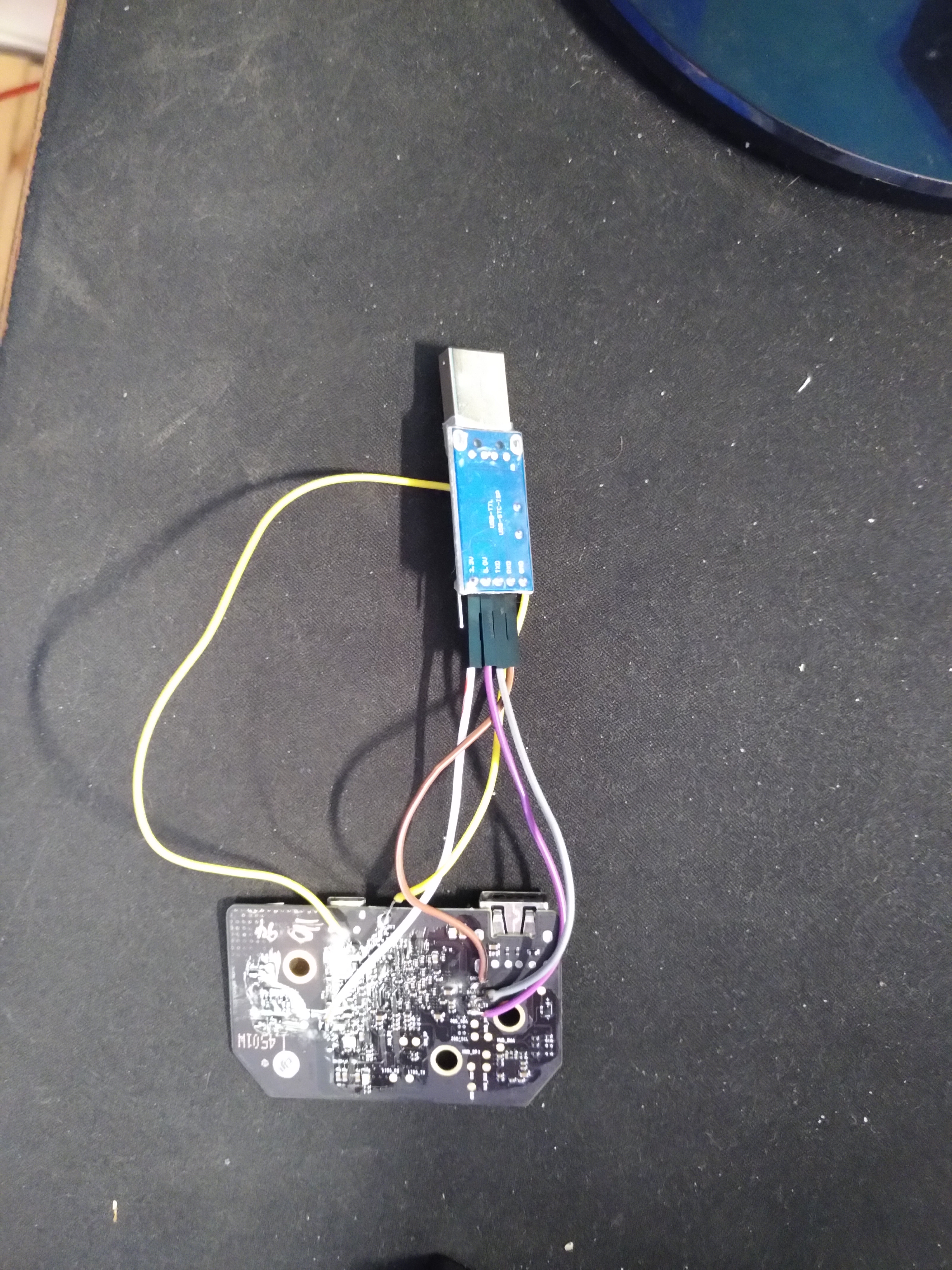

So @quaddamage i now have the board out and ready to solder.
I read somewhere i need a soldering station with variable heat i do have that. What amount of heat in C would you solder with?
I usually use between 350 to 450 when i solder. But ive never solderet anything that could get damagede from high heat.
Reactions: RodPad
We are talking about just soldering 3 wires to pads, not soldering/desoldering any chips.
Most technicians look at the state of solder (and state of components) when selecting temperature. And they rarely even know the exact temp - stations typically just have numbers 1..10.
In your case, you will use your own solder and your own flux. So you can easily start on any unrecoverable equipment - solder and unsolder the wires there to get some basics. The temperature should be set to what is enough to make the solder fully fluid. The soldering tip should be in a shape which allows to transfer the heat easily. And that's it, really.
There are two ways of doing it wrong: overheat it and the copper pad will stop sticking to the board, or rip it by pulling (either pulling the wire, or pulling the soldering iron while it's too cold).
1. Overheat - to avoid that you need set the proper temperature, but also make sure the time of soldering is as brief as possible. A good flux and some skill are crucial to make the soldering moment short.
2. Ripping by force - yeah, the pad is small. Avoid applying any force to the wire when soldering. If your wire it too large and too stiff, you can rip the pad even by bending the wire - so also use a small gauge wire. Some people use tape to secure the wires after they're soldered, so that bending the wire doesn't apply force to the soldering point.
I wrote a lot about the process because you seem worried; but this is really fast and easy.
I cant Figure out about the 5v ps. You just want me to connect an external instead of using the 5v on the ttl board?
Edit:
It works now. Rx needs to go to Tx and Tx needs to go to Rx i missed that part. I got the bootme going. Ill move on in your guide.
Reactions: RodPad
So this is my active window.
It doesnt realy get any further then Target: BOOTME in the end. Is it safe to disconnect or what should i do right now ?
That's no what the log says. According to the log, the target did responded with "BEGIN" on a command.
It later responded with "Target: CORRUPT" which probably means there were errors during the data transfer.
But after a few retries, it did flashed successfully - "Target: DONE".
Yeah thats what i saw too.
But then in the end it keeps saying:
Waiting for SFT on the DM36x...
<br> Target: BOOTME
<br> Target: BOOTME
I guess thats why my next error is not boot image found.
EDIT:
Apparently i didnt focus on the part that says do it twice. Now im at operation completet sucessfully
Reactions: RodPad
BTW, I have soldering iron, I can adjusted from 350 - 850, maybe 8 different types of tips.
I still screw up. :rolleyes:
Rod ..
Reactions: ninja_plys
Okay the operation was successfull yesterday and yet i couldnt connect either of the phones i tryed.
This is my putty output without the 3,3v jumper cable.

Haven't you seen something about that in the guide?:
Code:
Loading from nand0, offset 0x4a0000
** Unknown image type
Wrong Image Format for bootm command
ERROR: can't get kernel image!
Loading from nand0, offset 0x900000
Though since the Linux is booting, I think you should be able to reflash the primary kernel using the standard USB upgrade procedure rather than manual flashing.
I did the USB firmware update starting from the lowest available firmware on phantomhelp and it worked with 1.2.7 guess i had 1.1.9 or something.
It still connect fine with the drone able to start the rotors and controll gimball. Just no phone connection on either Samsung S5 nor my newer phone.
Code:
==========1970.01.01 00:00:10==========
Packet: /mnt/usb/P3S_FW_V01.02.0007.bin,
Upgrading ...
Result: Success
But i still get the same error.
This mean i need to flash the kernel manually right?
Code:
DM36x initialization passed!
UBL Product Vesion : DJI-GRC-P3-SUPER-UBL-1.0-rc0(2015-05-12)
Dji UBL Version: 1.51(May 12 2015 - 11:29:40)
Booting Catalog Boot Loader
BootMode = NAND
Starting NAND Copy...
Valid magicnum, 0xA1ACED66, found in block 0x00000019.
   DONE
Jumping to entry point at 0x81080000.
U-Boot Product Vesion : DJI-GRC-Uboot-1.0-rc1(2015-01-27)
U-Boot 2010.12-rc2-svn-Dji (Jan 27 2015 - 18:45:11)
Cores: ARM 486 MHz
DDR:   360 MHz
I2C:   ready
DRAM:  128 MiB
NAND:  128 MiB
Bad block table found at page 65472, version 0x01
Bad block table found at page 65408, version 0x01
nand_bbt: ECC error while reading bad block table
*** Warning - bad CRC, using default environment
Net:   Ethernet PHY: GENERIC @ 0xff
DaVinci-EMAC
Press ESC to abort autoboot in 1 seconds
Reactions: RodPad
To reflash the kernel manually do i need the jumper cable from 3,3v or is that not needed ?
Since im trying to interrupt the bootloader it shouldnt be needed right?
Reactions: RodPad
