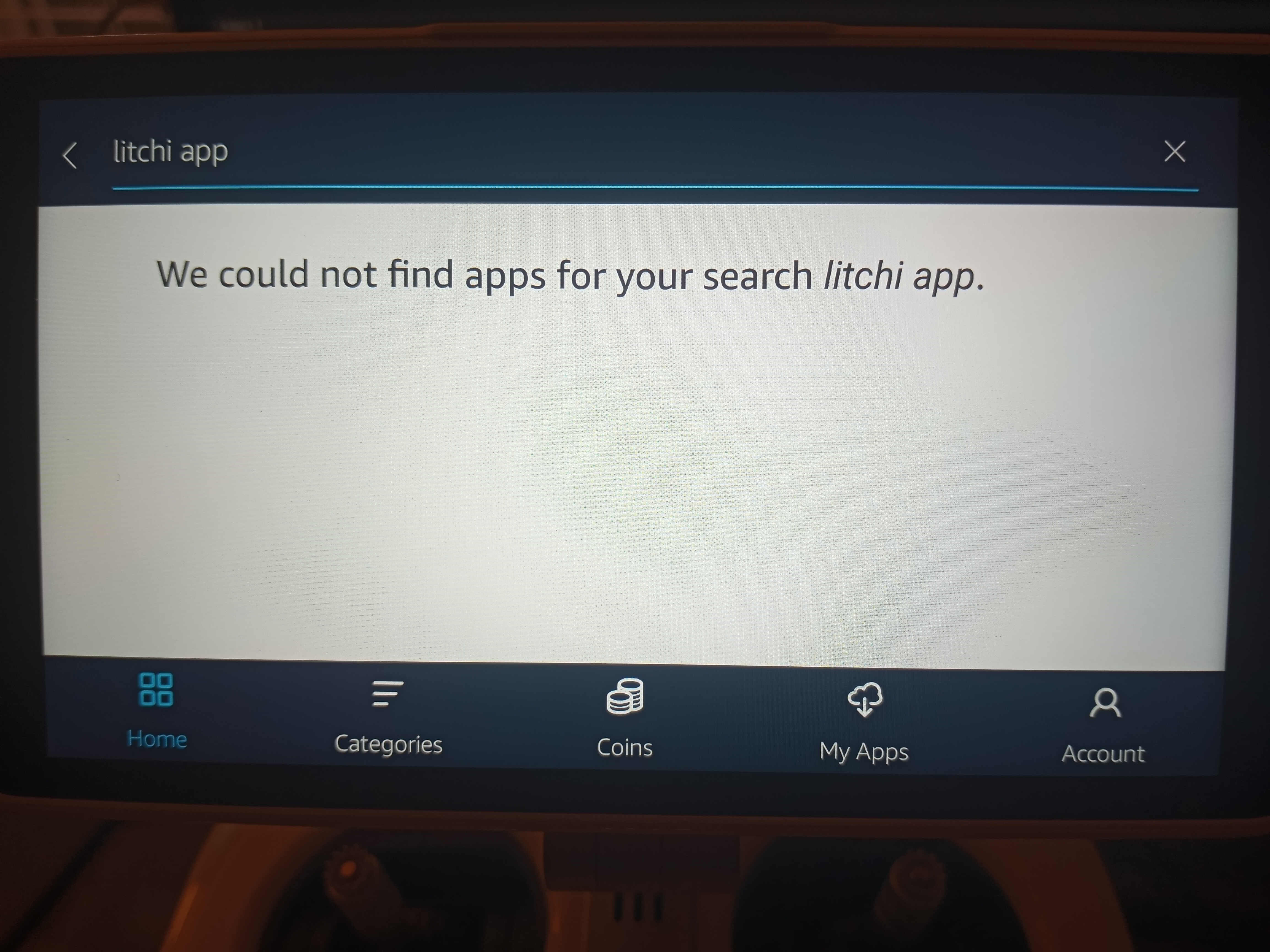

Hello All,
I just recently been trying to get Litchi on my GL300E DJI Smart Controller with no luch in finding it in the Amazon App store after I installed it. Is there a work around?
Hello All,
Tap on "my apps" and see if it already lists Litchi there, If it does simply click on it and it will install the latest version.
I wish it was that easy, but it was not, I went ahead and purchased another controller and a separate tablet. I just was not having any luck!
  • Sad
Reactions: Aairon
Sorry you couldn't figure it out I have the 300E and have a lot of third party apps on it, I have dronelink, Litchi, Airdata, Pretty much any android app I want I can load to the 300E.
Reactions: Bo Jangalz
I have installed many apps as well but for some reason I am not able to install Litchi but have been successful for other apps. Now that I have a new controller setup, I will take the original controller back to factory default and start over again because I am going to use that one as my backup.
Litchi was the easiest app to install of all of them because all I had to do was go to amazon store. once I did that, even if I wipe the controller completely erasing all signs of litchi. if I go back to amazon and search I can't find litchi anymore.. BUT if I tap purchased apps in the amazon app it will still ask if I want to reinstall Litchi.
