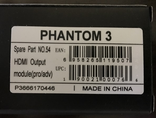

Can you please tell me what the exact DJI part number is on the module box?

There's only one. Here's the box:

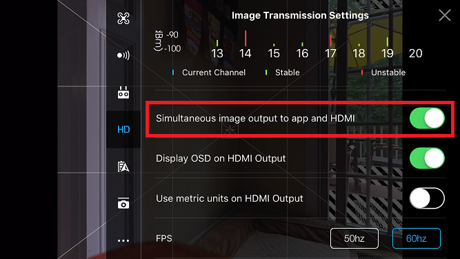

Hi msinger, I tried to grab your attention in another thread so apologies if I am repeating myself. Recently ordered a set of fly sight Spexman goggles and a genuine hdmi board to suit my P4. The tech guy that sold them to me said that the process is straight forward to install (watched the videos etc, so it looks straightforward), but reading through this and other threads suggests that you either need to update the RC firmware or for some it worked straight away. Checking my go 4 app and there is no option to select dual outputs as per one of your posts that I found so I am assuming for that option to be enabled, there is an update or similar to recognise the hdmi module. Can you advise please?
You'll see the option in the following section of DJI GO after installing the RC firmware:
Legend! Thank you for the definitive answer. I have yet to see any posts regarding the Spexman goggles so I'll write a story when they are up and running.
