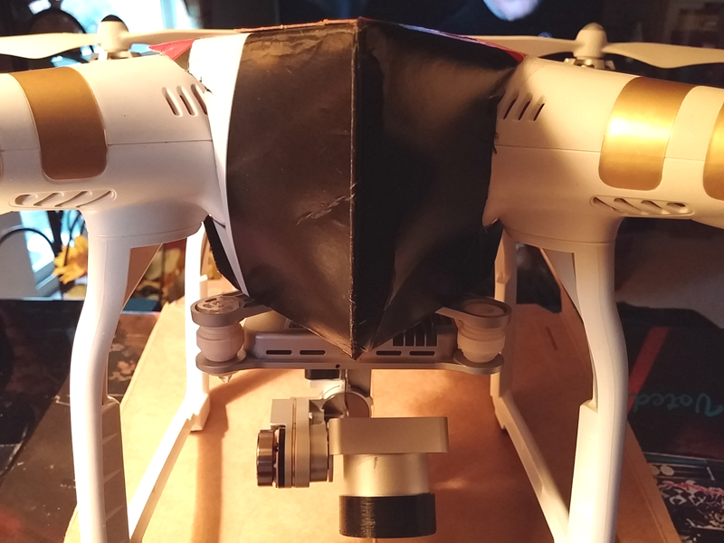

Talking about Wind Drag this has been a recent ongoing project I have been messing around with. I do not have the data collected yet on what I'm working with for a comparison. I'm hoping I will get the type of results that are earth shattering....but as we know that is asking more then it's capable of.
What has my attention the most is what effect the setup I'm using shown above has from the wind deflecting from the nose and up into the propellers. That would be like simulating a updraft. I suppose it could go either way in that the aircraft might react as though it is lighter and become more efficient, or it might cause a disturbance causing the propulsion system to work against itself.
Well eventually I'll get some data collected with & without to a comparison.
Wow, just when I thought I've seen it all, Sally had to show us her tits... That is very interesting. I'm curious if it does help at all. Just be careful so it wont go into the spinning props.
