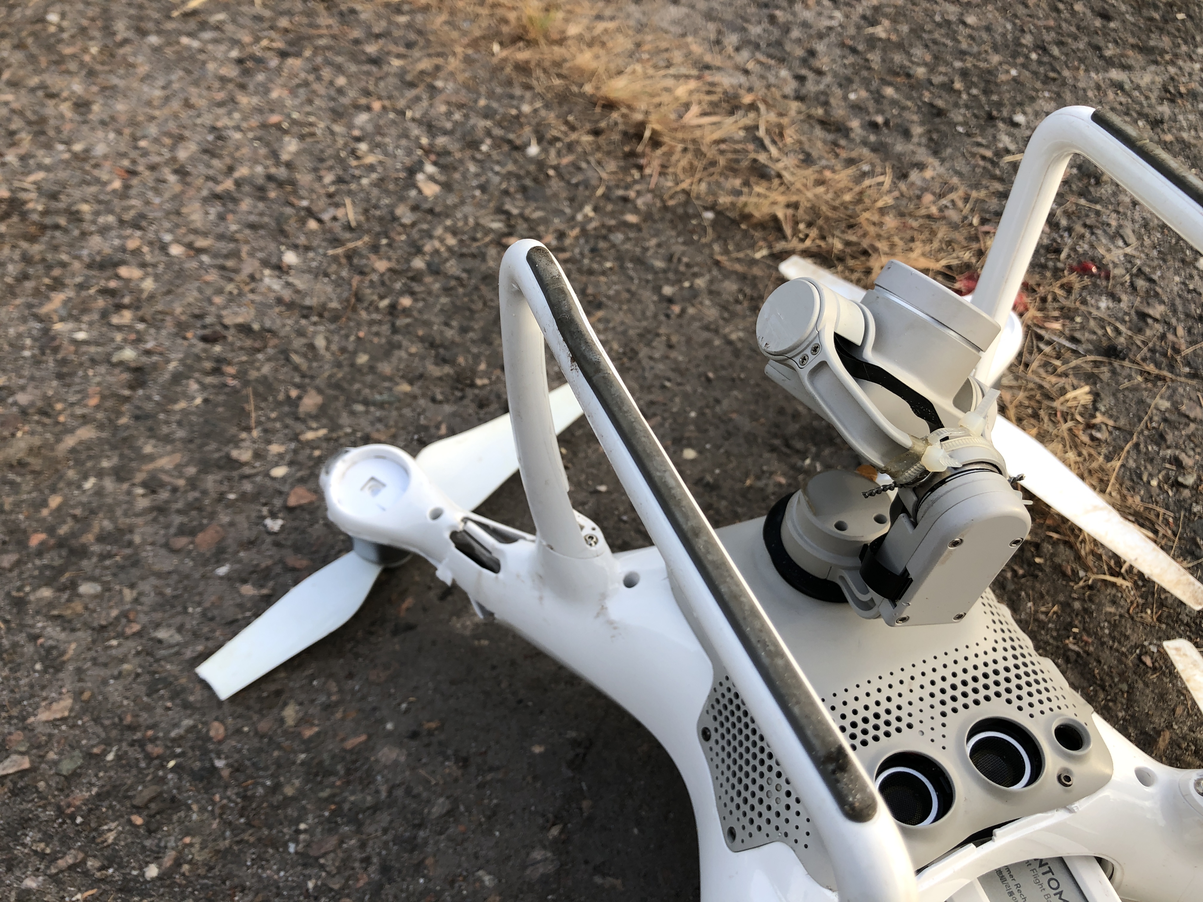

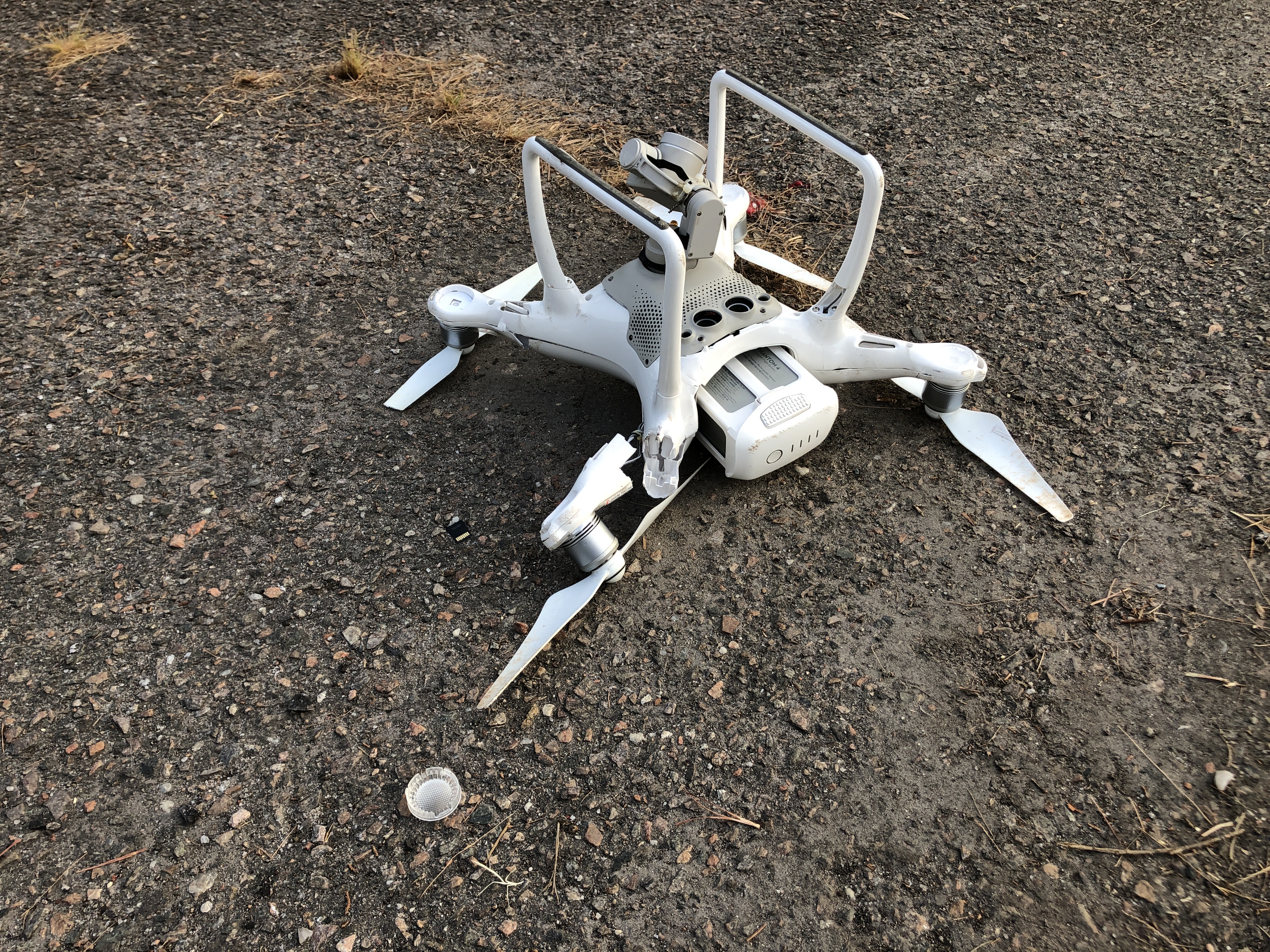

My P4 fell out of the sky for no apparent reason. My guess is the new replacement battery was defective.
I had just flown for about 15 minutes. Landed and replaced the original battery with one I ordered from amazon which came in a set of two. I charged both batteries before the day of my event. After swapping the the original battery with the new battery...I took off and flew less than a minute and within my site. I looked at my monitor and it read no contact or something like that. I don’t remember the exact words. I begin to look up and around hoping it was somewhere. Someone asked if I was looking for my drone...they pointed to the parking lot and there it was upside down on the pavement. I have a short video documentary of my reenactment. I post last week but I have no idea where it is. I found the SD card the next day at the crash location along with parts of the wing and landing gear. The SD information could not be read. PLEASE HELP. I’m new to this stuff...any assistance is welcomed.

Is it under warranty that looks like it hit awfully hard to break arm like that

Hoping he submits flight data... just a guess but looks like battery was not secured properly?
Totally agree. Bottom half of battery was not fully engaged. Easy to overlook with a new battery that does not fit the same as the original. Sorry for your fall. Hope you're retrieved data will supply your answer.
It's very common for the battery to become dislodged in even mild crashes.
It only needs the case to be slightly deformed.
It's not surprising that the battery is loose after an impact that caused this much damage.
Meta4,
Agree with you too. ? just don’t want the battery to become unsecured, loose, whatever BEFORE it hits the ground. I kind of think they’re supposed to pop out upon hard landing, they all seem to. Maybe a fire hazard or something. Oh well, that data will tell.

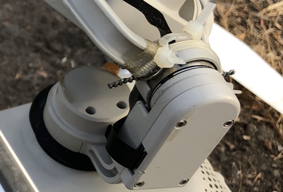

The gimbal seems to have an existing repair, significant?
With any battery that is new to you I'd suggest a couple of LOW test flights, right the way through its voltage range, to see how it behaves

Were your new batteries DJI OEM's?
