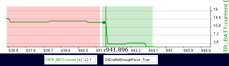

Looks like it's possible all 4 motors stopped turning.
Shortly after the P4P started tumbling the current dropped from 13A to 3A. In addition, the notEnoughForce flag became true which usually indicates that the motors are unable to deliver enough thrust.
More could be learned from the FLY177.DAT log file. Hopefully, that can be obtained from the mobile device running the Go 4 app. Take a look here
