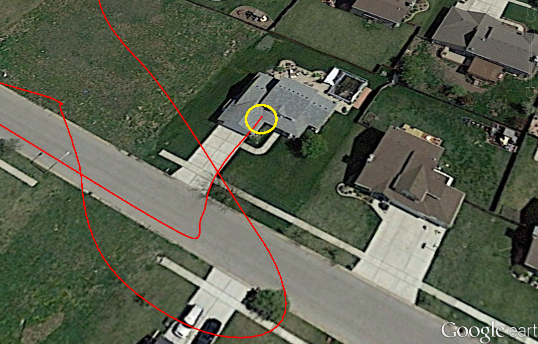

P3A fell out of sky... can someone look at data and explain???

According to the DatCon KML and CSV (and your TXT flight log), you did a CSC on top of your neighbor's house. Your sticks were in this position at that time:
Thanks for this diagnosis. I'm sure everyone has learned from this thread.
