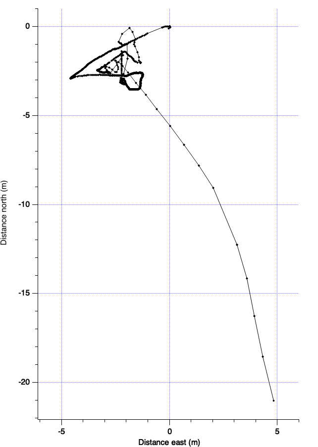

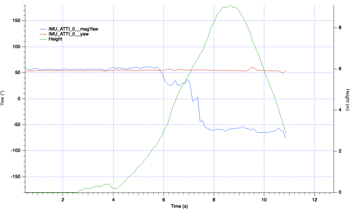

FLY026 was the flight. Your takeoff location was magnetically compromised. Notice that the yaw was initialized to around 55° by the compass, but that as the aircraft ascended the compass reading changed as it climbed away from the interference. That led to a discrepancy of over 90°.
109909
And uncontrolled flight:
109910
