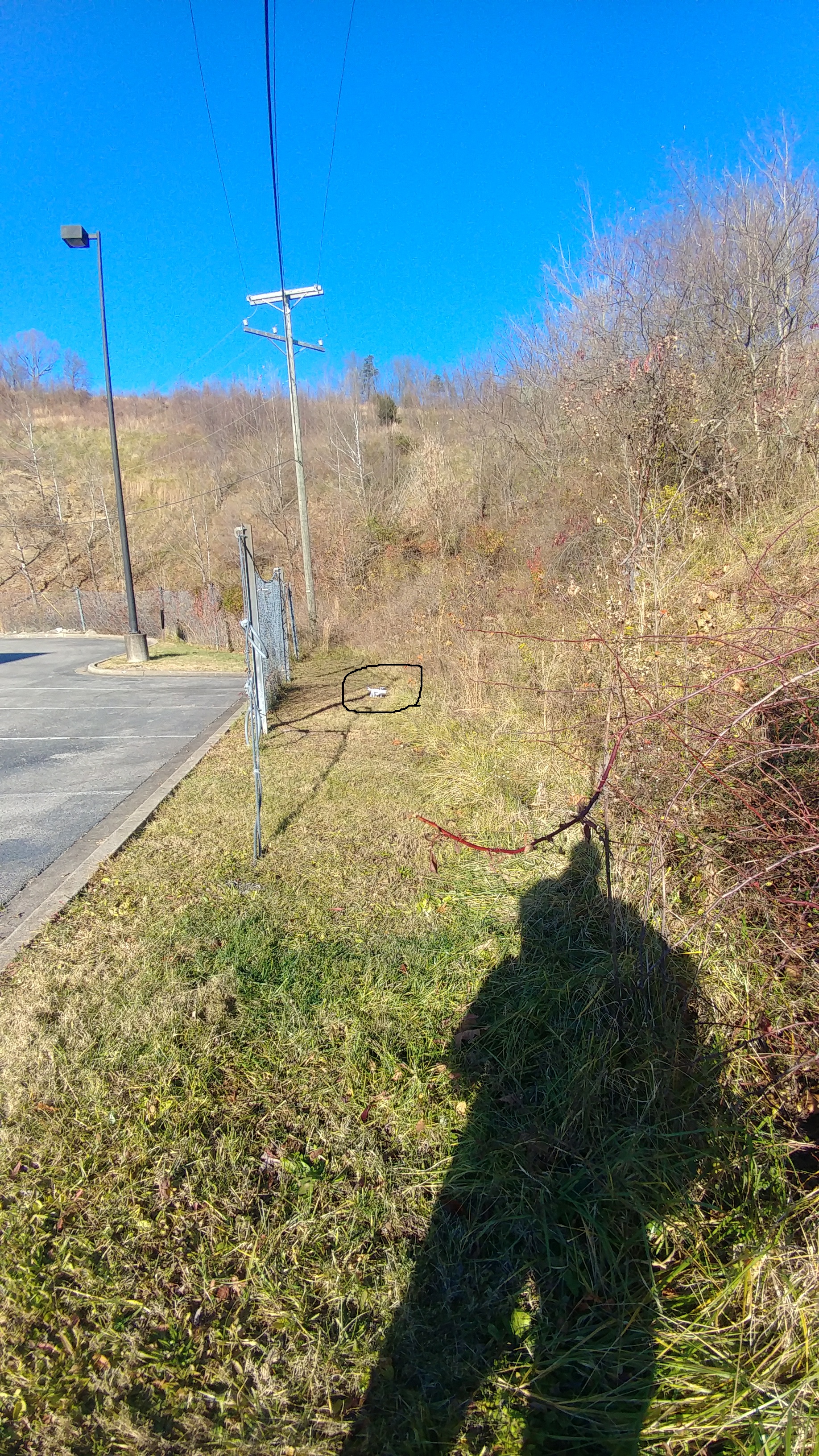

This was the first sign of my issue due to an earlier crash where, like yours, my drone came straight down (if you look closely, I circled the bird on the ground) where it landed perfectly and kept its lights on flashing helping me find it. I thought it was going to be a long time finding it as I had it pretty far away and couldn't see it land. It's easy to see that it didn't miss the high power lines by much. It was above them when the "critical battery error" came up, paused for a second, and then proceeded to descend in a slow and steady manner. I didn't have any navigational control and could only watch in horror as it went down and out of my sight, not knowing where it was landing. I thought I was going to have to walk up and down a fairly steep hillside to look for it.
