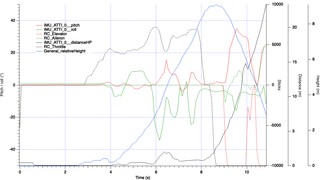

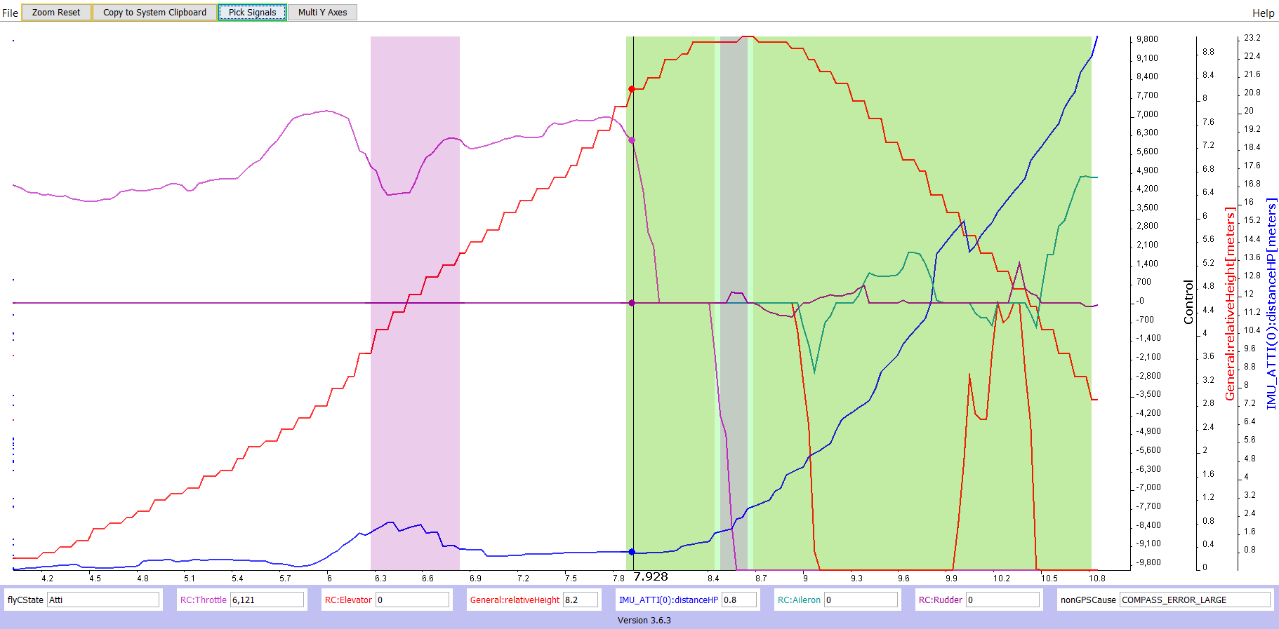

@Brianj4242 .....It looks like at ~7.9 seconds the aircraft experienced a compass error and switched to ATTI mode. You may have over compensated for the switch over by applying, full down throttle and back elevator. As mentioned by @sar104 above it appears to be a compass discrepancy.
@Brianj4242 ....And yes, it can be seen that you did calibrate prior to flight.

Not likely. The motors looked fine per the data. I suspect this was more related to your takeoff point as sar104 mentioned in his post previously. There was a magnetic deviation at the takeoff point such as Re-Bar under concrete, close proximity to a large metallic object etc..and so forth.

Your recollection is not quite correct. After it started to drift slightly, at 8.5 seconds you applied full down throttle, which is why it started to descend, and at 9 seconds you applied full back elevator, which caused it to pitch up and accelerate backwards. It was facing northwest so it moved southeast. That was the action that caused it to crash.

It was not the calibration - the data clearly show that the magnetic field changed direction as the aircraft took off. Magnetic interference can be very local - just a few inches if it is rebar in the ground, for example.
