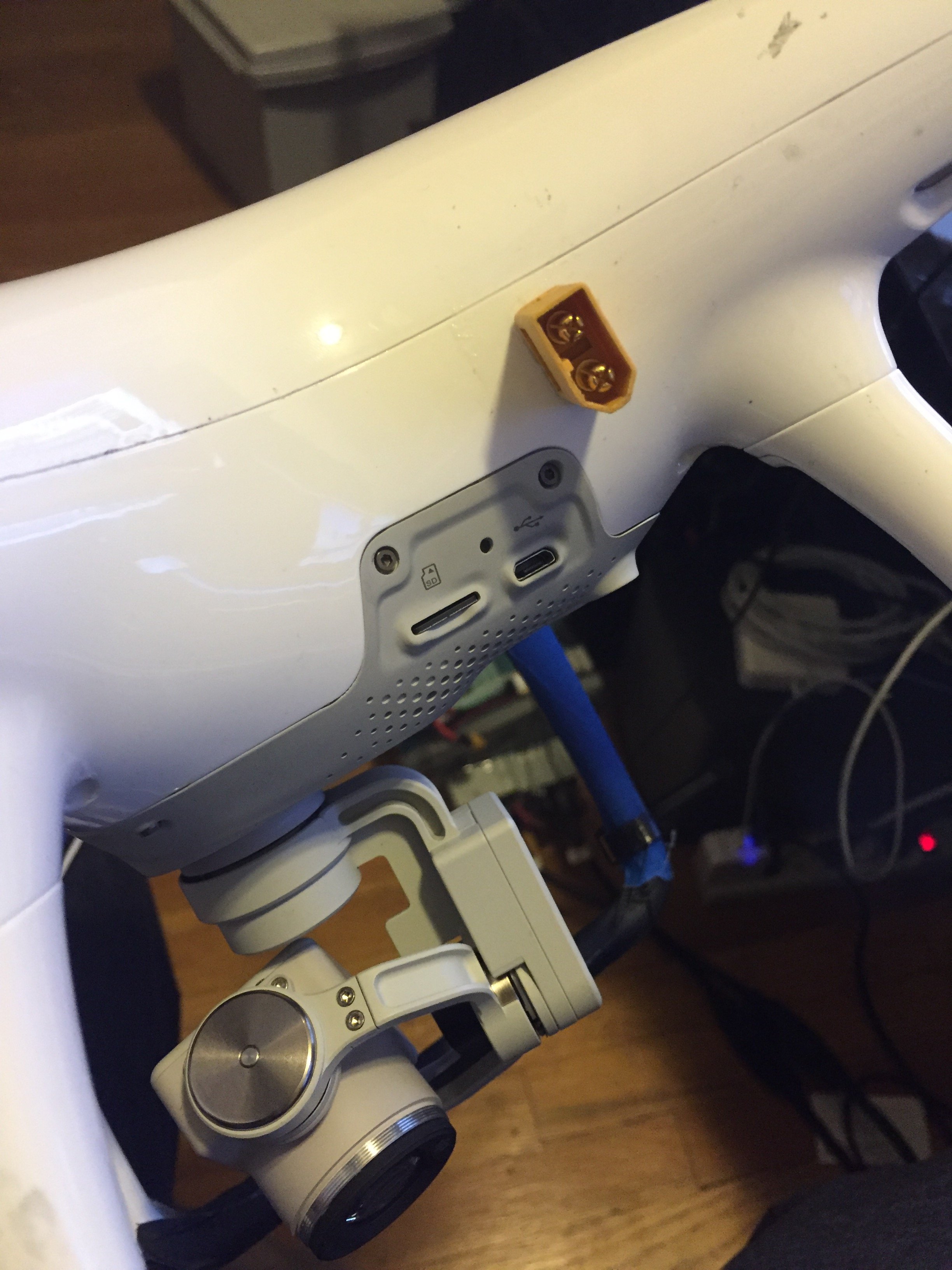

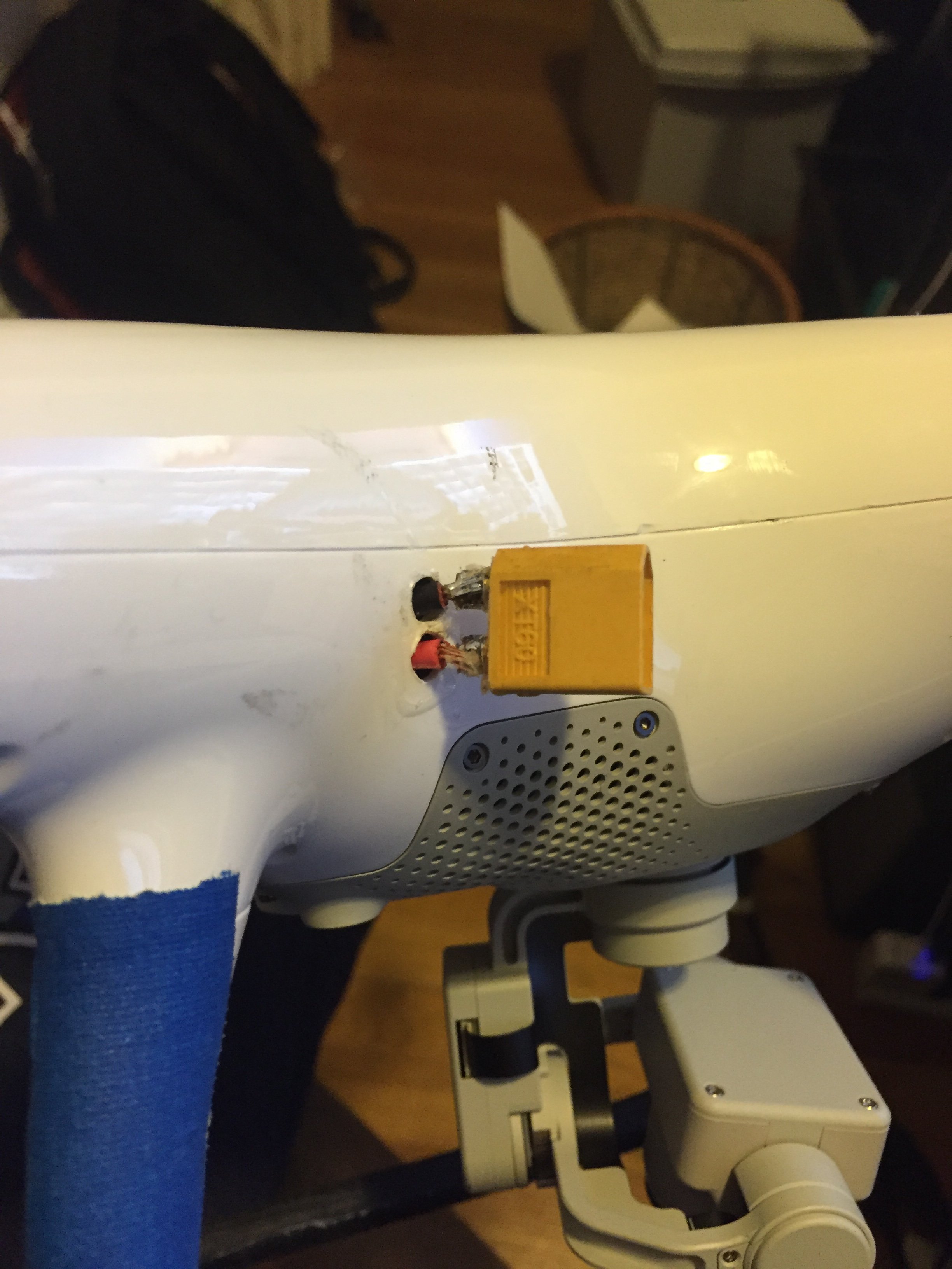

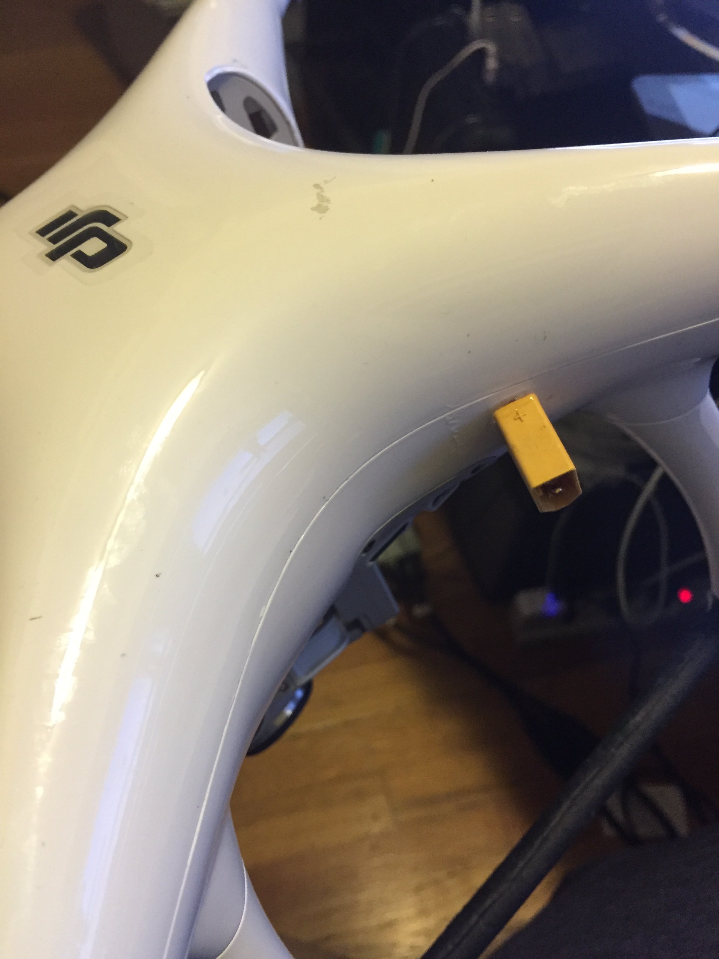

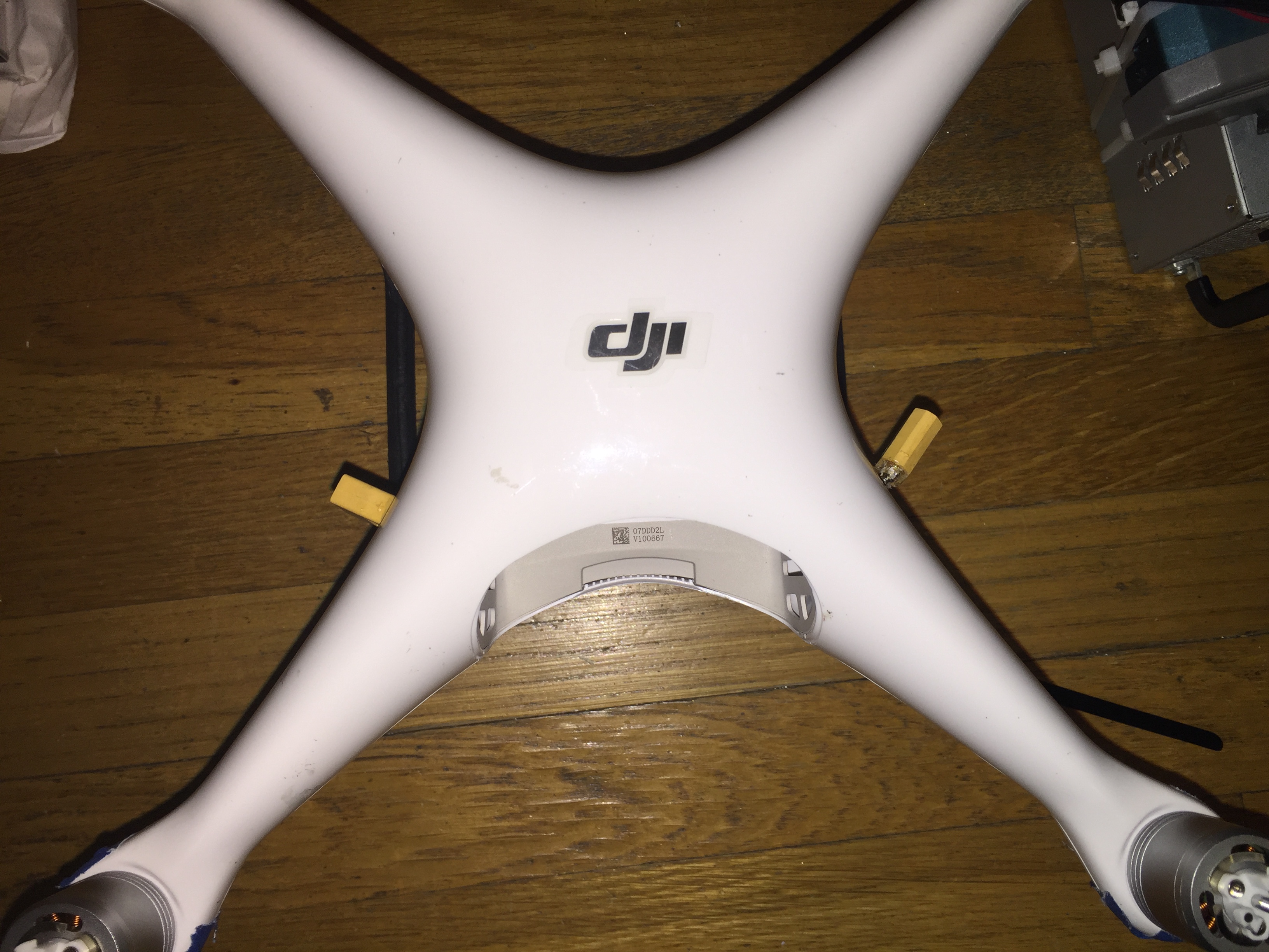

I didn't take any pictures when it was open but if you search around you'll find pic's of the P4 on the web. I just used those pic's to determine how the power was distributed to the Electronic Speed Controllers and soldered in a new power lead on each side. Those two leads are directly connected to Hyperion G6 S4's. I'm using the 2800 and 2400. Not sure which is better, haven't timed them but they both work very well. Basically exactly the same as on my P3. Didn't think I'd have to resort to this on the P4 but so far many things about this generation have disappointed me. Basically a BS build. Kind of like the S versions of the iPhones. Eh... who cares. Actually I like the way the P3 flies better although I do like the speed of the P4. Here are some pictures of the outside. Before you ask, no I don't have battery tray's on this one yet. I haven't seen any for sale that I like. I might make some out of spare plastic. For now Zip Ties work just fine.

View attachment 50221View attachment 50222View attachment 50223View attachment 50224

How difficult was it to split the case open? Did you think it would be possible to ultimately perform the surgery without splitting the case, through the holes you create, in just the right spots, even if larger than necessary for just the wires, like laparoscopic surgery? How are you using the zip ties to attach the externals without a battery tray? Any pictures with the external batteries attached with zip ties? :cool:

I thought it was easier than the P3. Nope. You need to take it apart. You'd need very big holes. Taking it apart was easy. No pics with batts. Will take pic when I have a chance.
