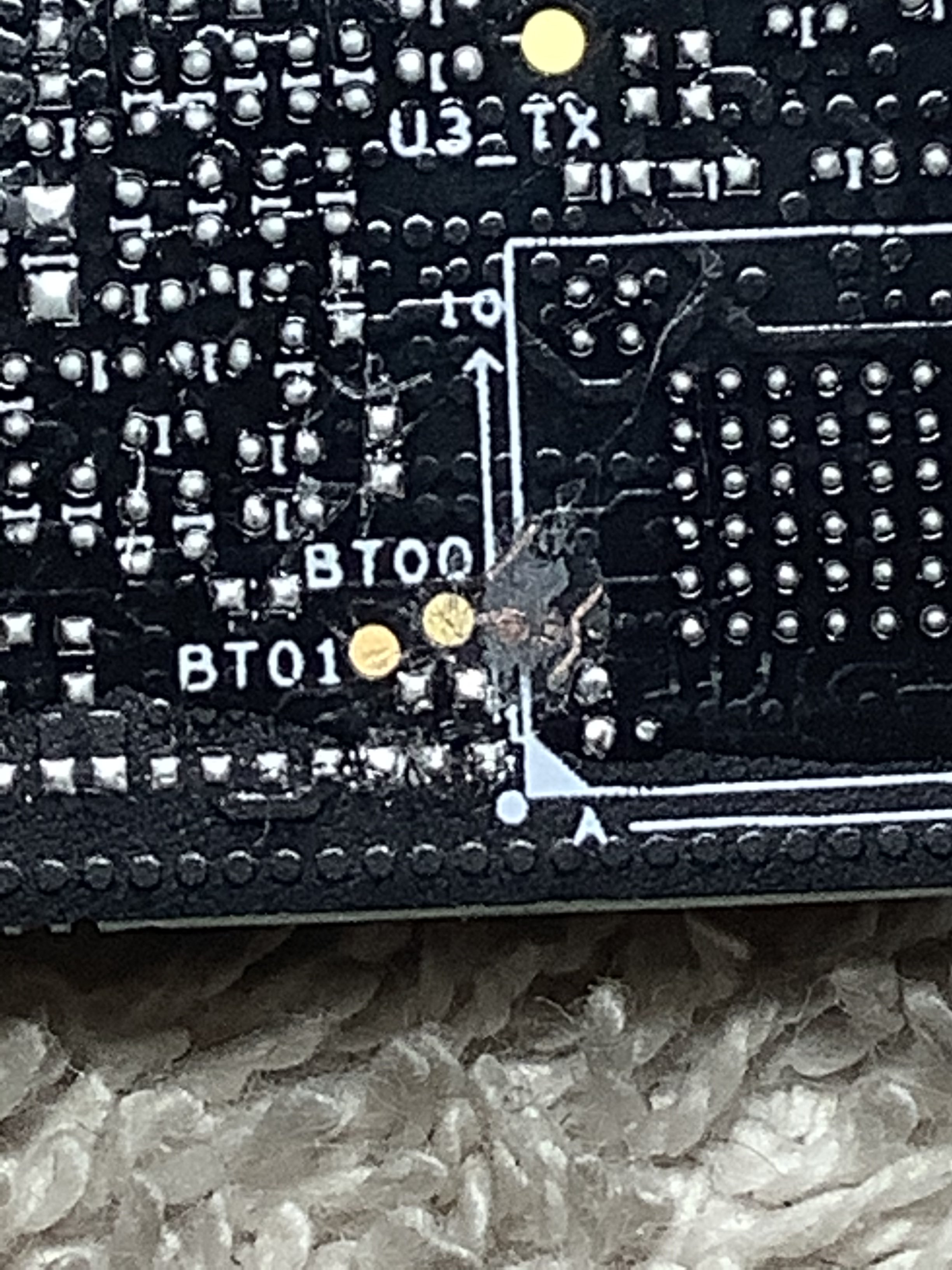

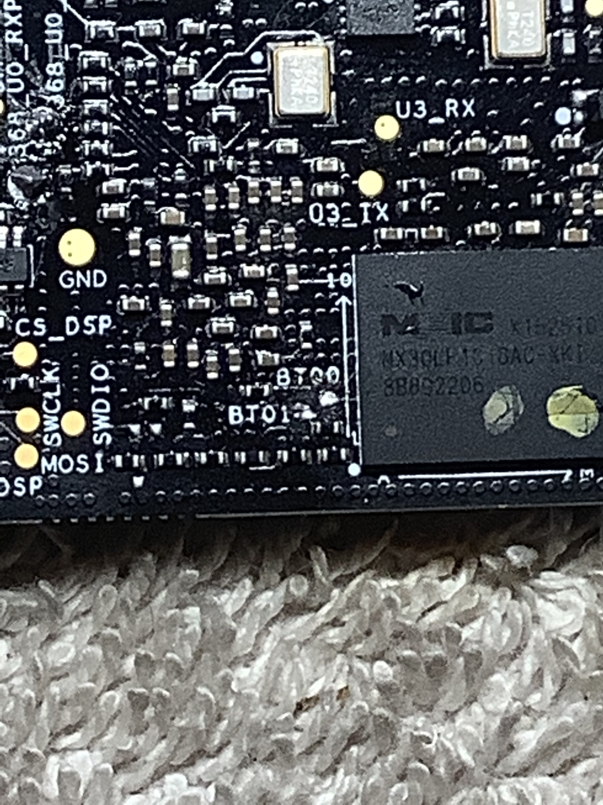

Hopefully these two photos are clear enough for you.
Just to the right of the bt00 pad you can see the copper track from the pad. I have carefully scraped the black coating off to expose it. It is close to the nand chip so a lot of care is involved, along with decent equipment and some soldering skills.
For the bt01 pad, below the pad and slightly to the right is a small resistor. The left end of this resistor is common with the bt01 pad. Care needs to be taken when soldering to these locations. If you have a totally bad board to practice on, it would be helpful.
Good luck to you @mj2019

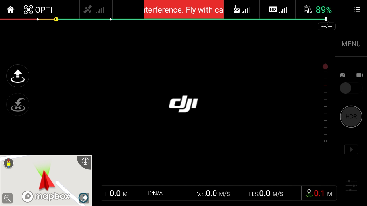

now heres a new thing!!! i pluged a gimbal some one had on shelf since a while here is what it gave me??!!! no video just dji

Do you have light on the front of the gimbal? I see it isn’t showing a sd card inserted, have you put one in to see if it’ll show it?
If it has a blinking green light and shows when a sd card is inserted, then just re-flash the board.?
Check if the cables are connected correctly to the gimbal or if you have any faulty cable or plug.

If the camera has been sitting for quite a while, the P3P gimbal board has a history of loosing the memory in the nand chip. It will need to be re-flashed.
sorry for being unclear, what happened is that some one had an extra gimbal, i wanted to check it for a friend to replace his one crashed physically, so i connected this extra gimbal to a p3p and on app instead of having vid or novideo, look what i got a black screen and dji in middle???!!! what is that and why?
Some of them will say that. I read about why it says that but I don’t remember why. I’ll search for it again and let you know what I find.
