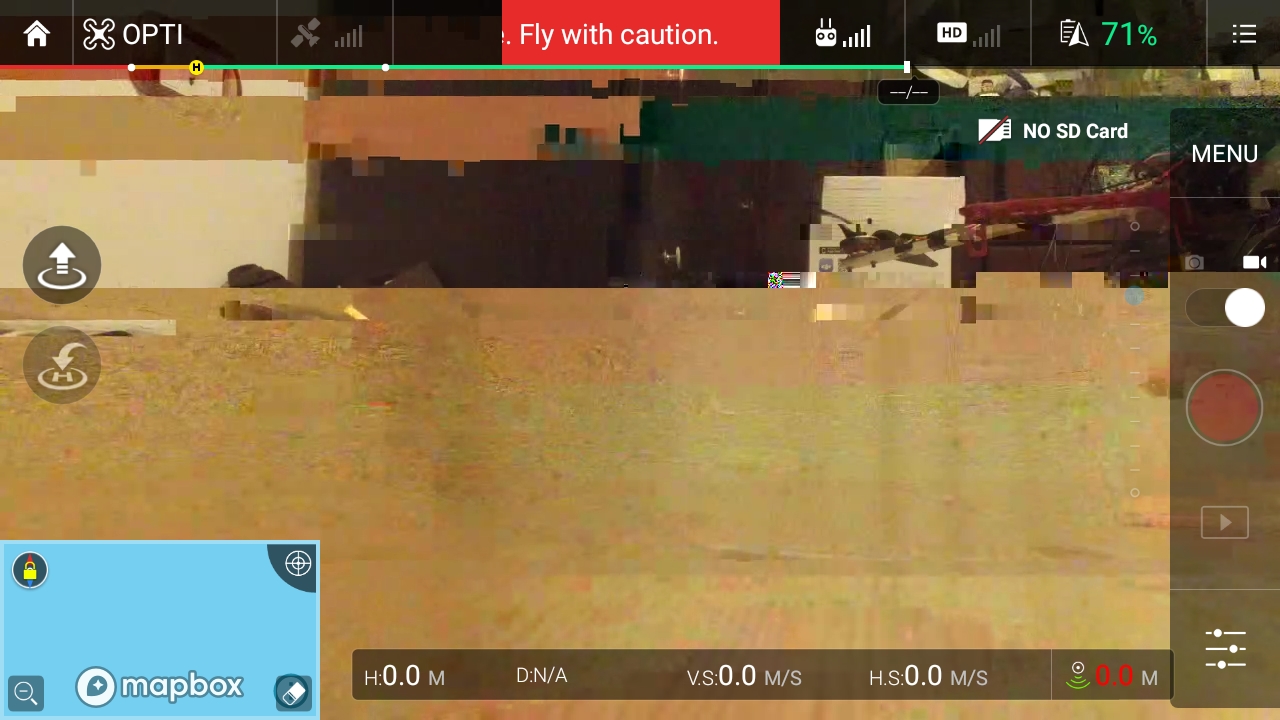

i fixed this bricked craft according to sunset catcher method, and upgraded it to firmware 01.11.0020 and i have a good other working p3p with its transmitter gl300B on firmware 1.8, before the fix i binded the bad p3p to this working transmitter , i was able to arm in atti mode and motors spin but got nothing on goapp, now after the fix this is the corrupted image below am getting but the fixed p3p cannot arm it states escerror restart plane and if doesnot work contact dji. the image some times get dim(like in case of low rssi). some thing to note when i bound the ac to this transmitter the transmitter led status is not solid green, but blinking green red, while the aircraft connection led status next to bind button is solid green. what to do
