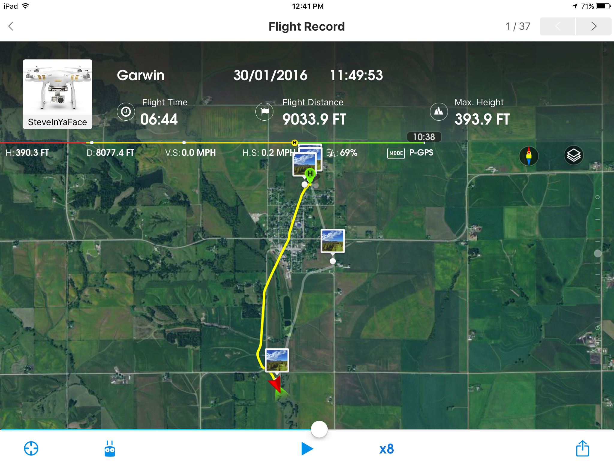

DJI help prefers green. That reply makes me a DJI fan for life. My favorite color is red. P3 for a little over 4 months. Every flight perfection. Great videos best videos I have ever shot. 1.5 mile distance best so far. I recommend get your drone read and watch videos learn to pilot, fly, have fun and shoot some great video.
my best so far could have kept goin the excitement got to me misread the remaining power panicked and flew home. Full signal all the way
