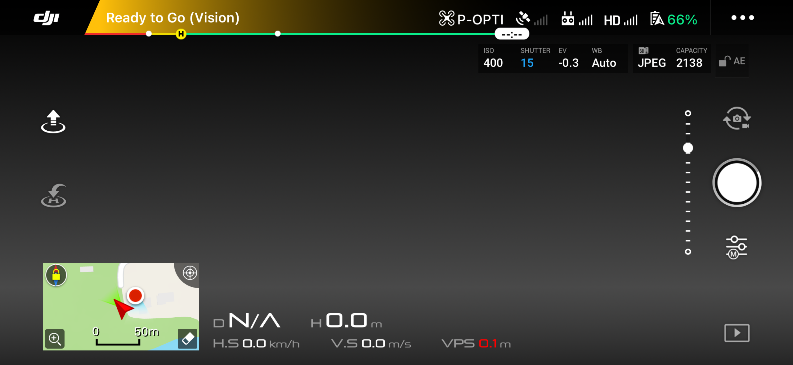

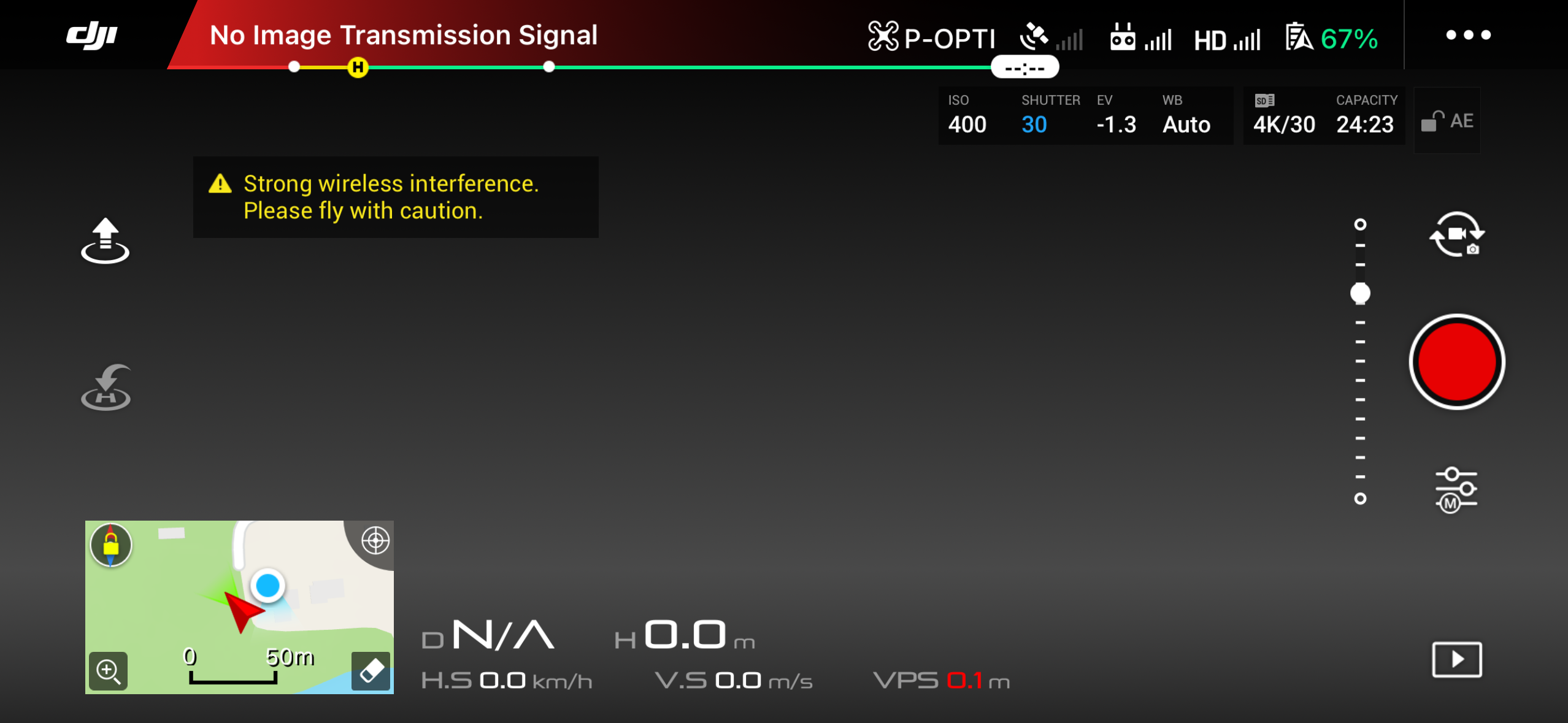

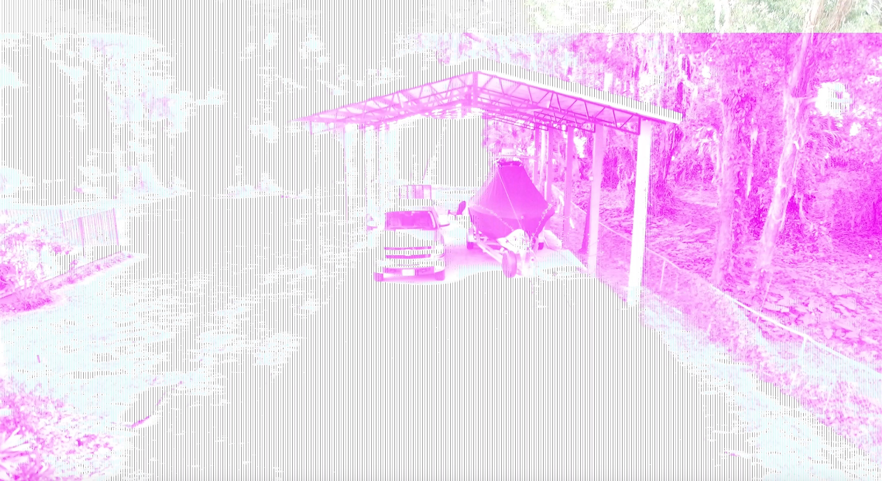

Well..... unjustified exuberance. Even though I had success getting the camera command to populate on my phone when connected in sequence as per instructions, the drone is not sending camera signal to the RC & Phone. As well, when I took video, it was really garbled mixed in with some mostly clear images but the color was incomplete. Does that sound like a bad camera ribbon connection? What might be causing the camera signal not to come to the RC & phone? I would think it would at least send the garbled/distorted image as captured on the SD card to the phone.

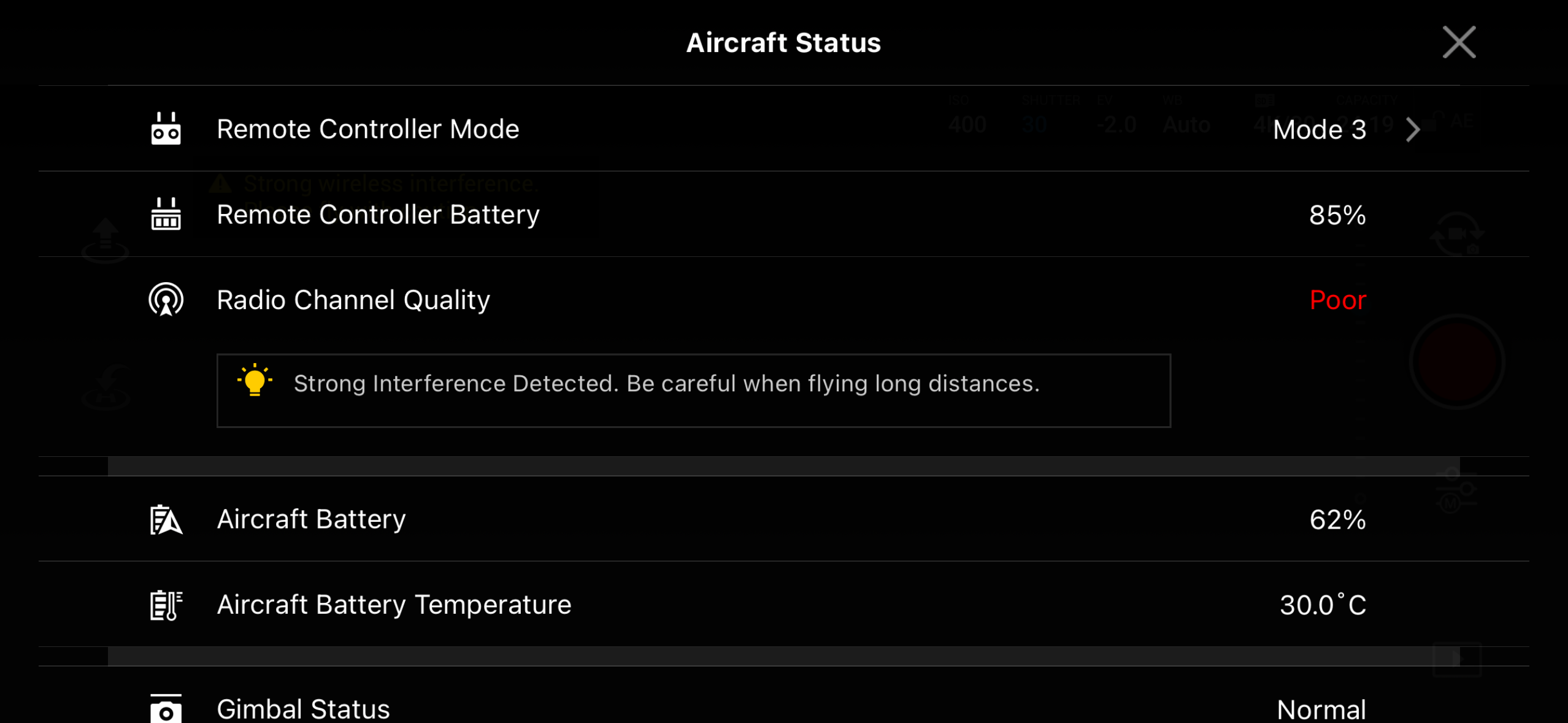

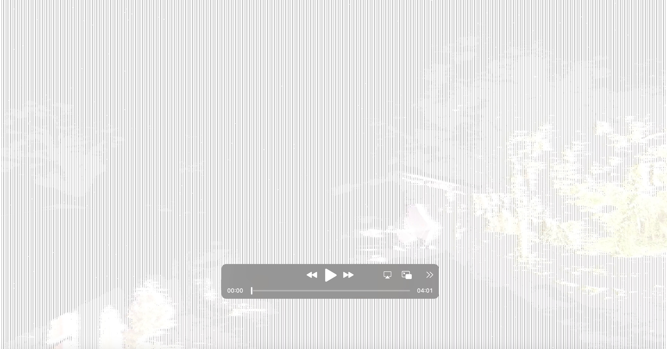

Until this morning, I had been having difficulty even getting the "Camera" button to appear on DJI Go app on my phone. I was wired into the wrong USB port on the RC(my bad); when I tried to take pictures inside, it took reasonably normal clarity, focus colors, etc.. However, when I flew with it the bright areas were blotted out with thin straight lines and the areas of the image that it did get were horribly washed out and the colors were not even close to being right. I brought it back inside as it's been really windy here in Florida today and now it's raining. In spooling up inside the house with props off, I get the following messages I'll attach. Signal is intermittently lost and the yellow 'signal interference' warning keeps popping up, and the gimbal, although it functions in moving, goes back and forth between being red as lost signal as well. I thought that I might have a bad SD card but that doesn't seem to be the case. I formatted one thru the Camera/RC and the AC and when it dries out here I'll see if that and the camera shutter and aperture is perhaps at least part of the issue. I'm craving getting the darned phone/RC/AC in synch so I can fly out of visual range.

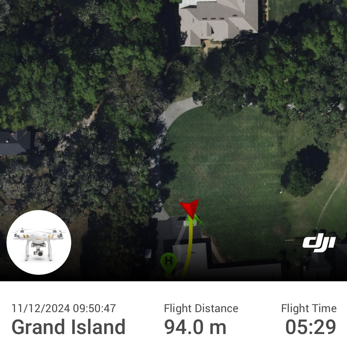

Update: I formatted the SD card and had another go at it when the rains passed thru. Although quite breezy, I managed to snap a dozen or so photos and shot some film. It all came out fine. There was some pesto-bismal colored lines running thru some of the film, not sure why.... but most of the stills and video came out as it did when the drone was new. Now the last remaining puzzle is the camera not connecting with my RC & phone. If the AC camera is shooting video and stills okay... could it be a damage to just that part of the system or is there any adjustment to AC or RC that might get the two talking? The LED light on the AC gimbal body is green and RC status light is also green for connection between AC and RC.

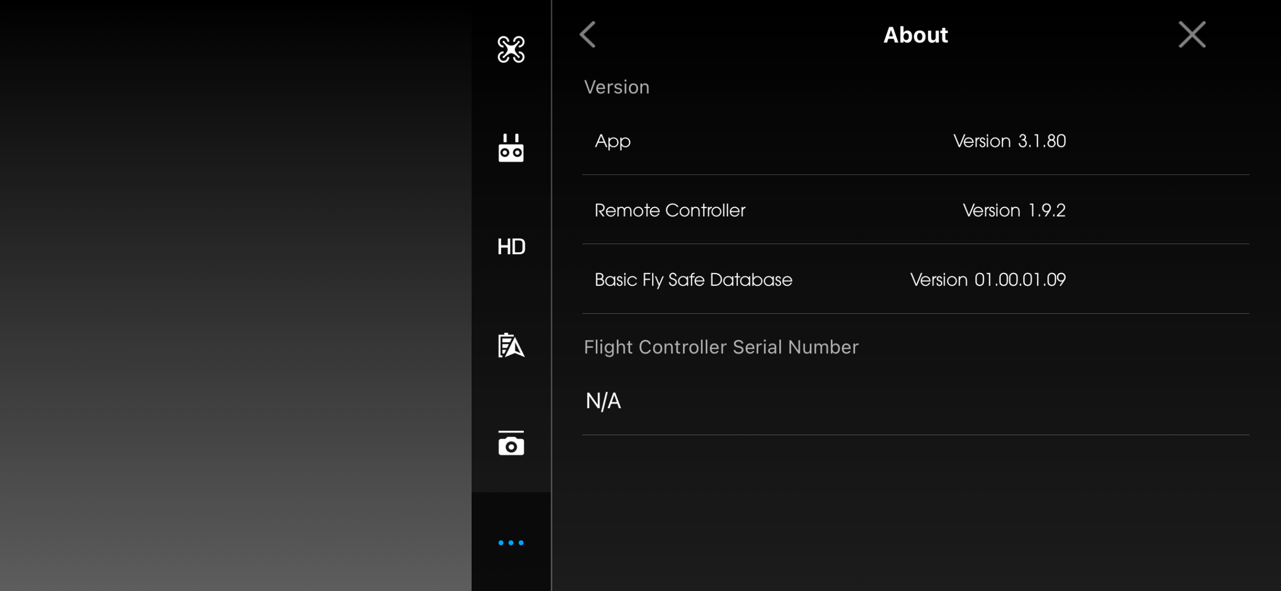

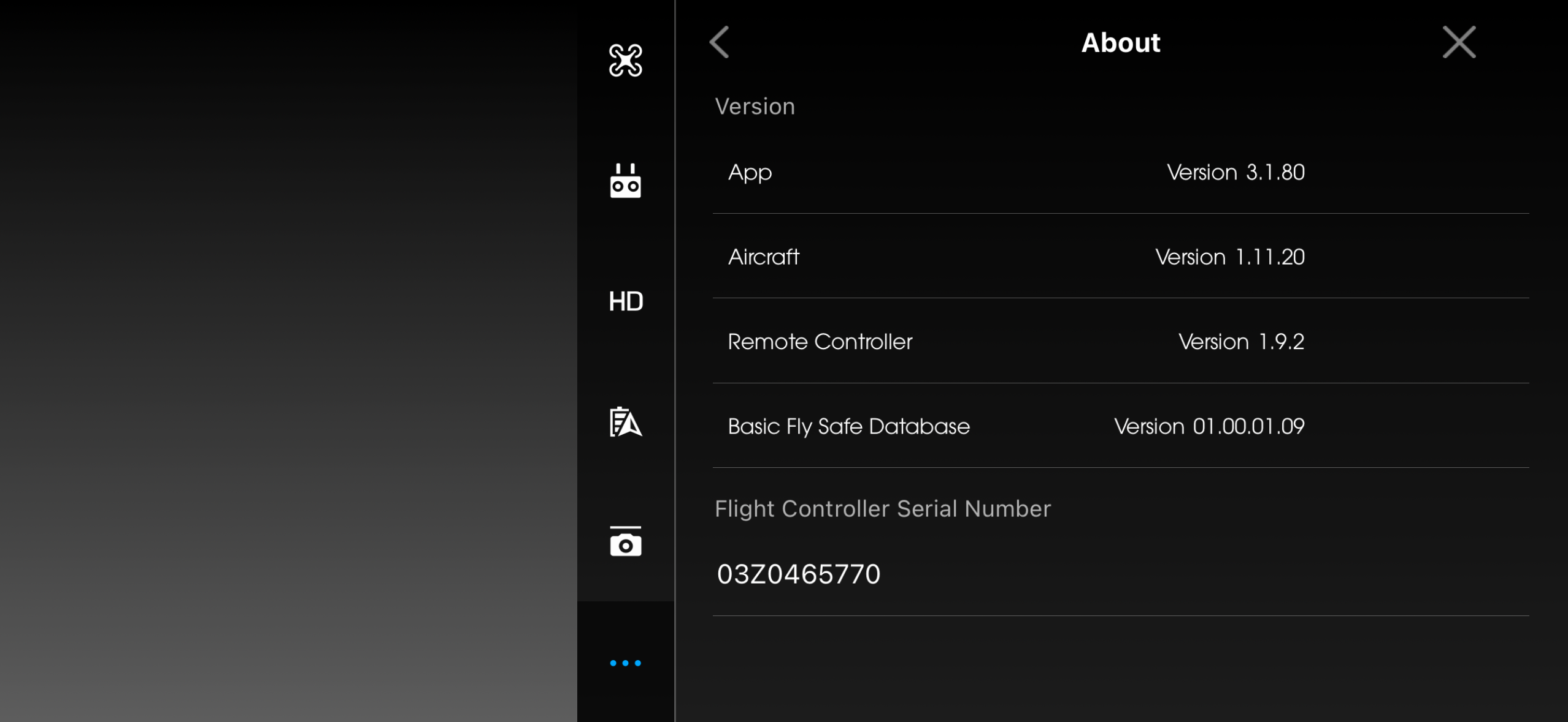

I tried without an SD card and I tried a different cable and still no joy on the camera function. I noticed on the DJI site that the IOS update is v.3.1.13 and the Android version is 3.1.8... and in looking at my screens it shows I have 3.1.8 even though my phone is definitely an iPhone 15 with IOS.... Surely Apple Store doesn't have Android downloads (nor would it download to my iPhone).... but grasping at straws at this point. Probably a typo on the DJI site. Is there a benefit to downloading DJI Fly and/or Litchi to see if either of those solves the phone to camera connection?

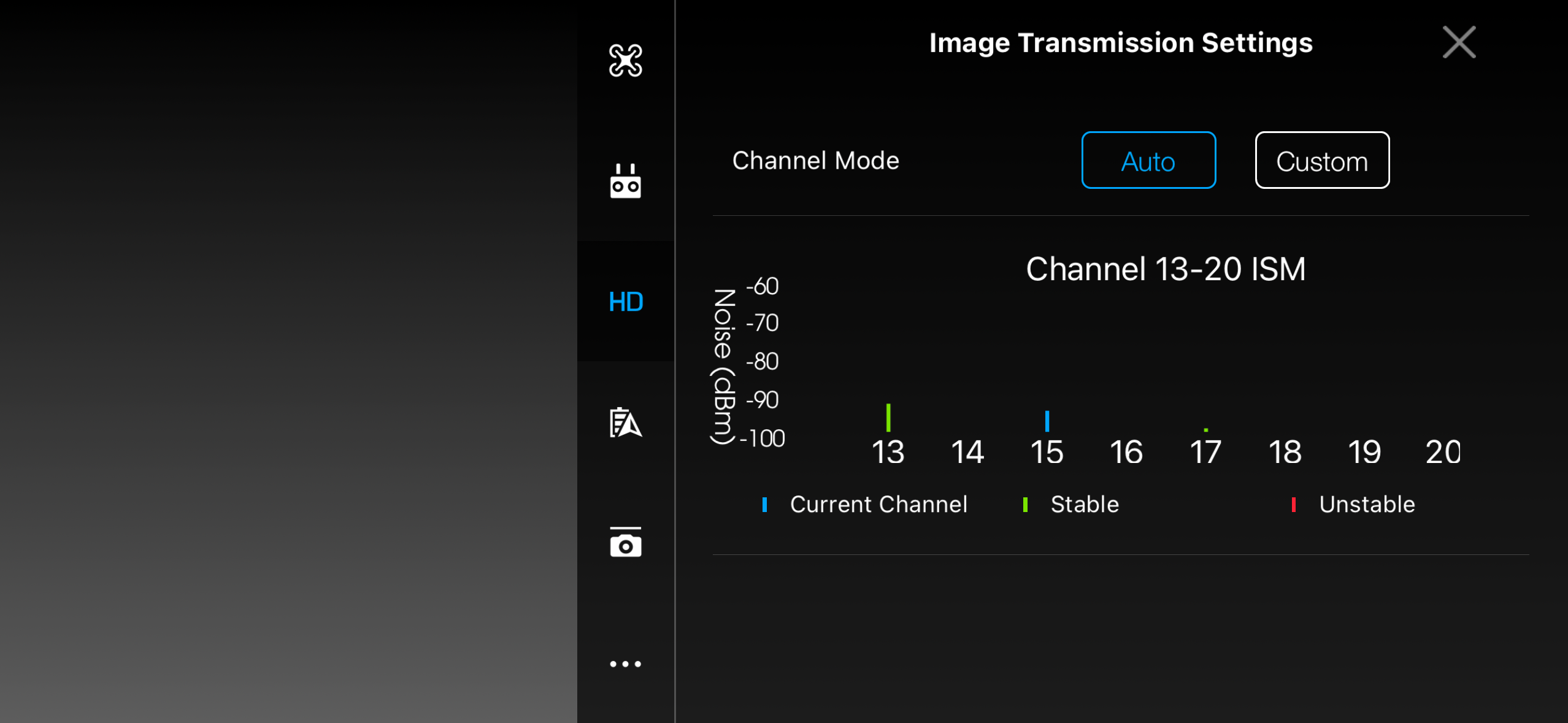

Can also check transmission channels, default on auto , has custom to where you can select a channel that might be better than auto pre selecting to see if gets better

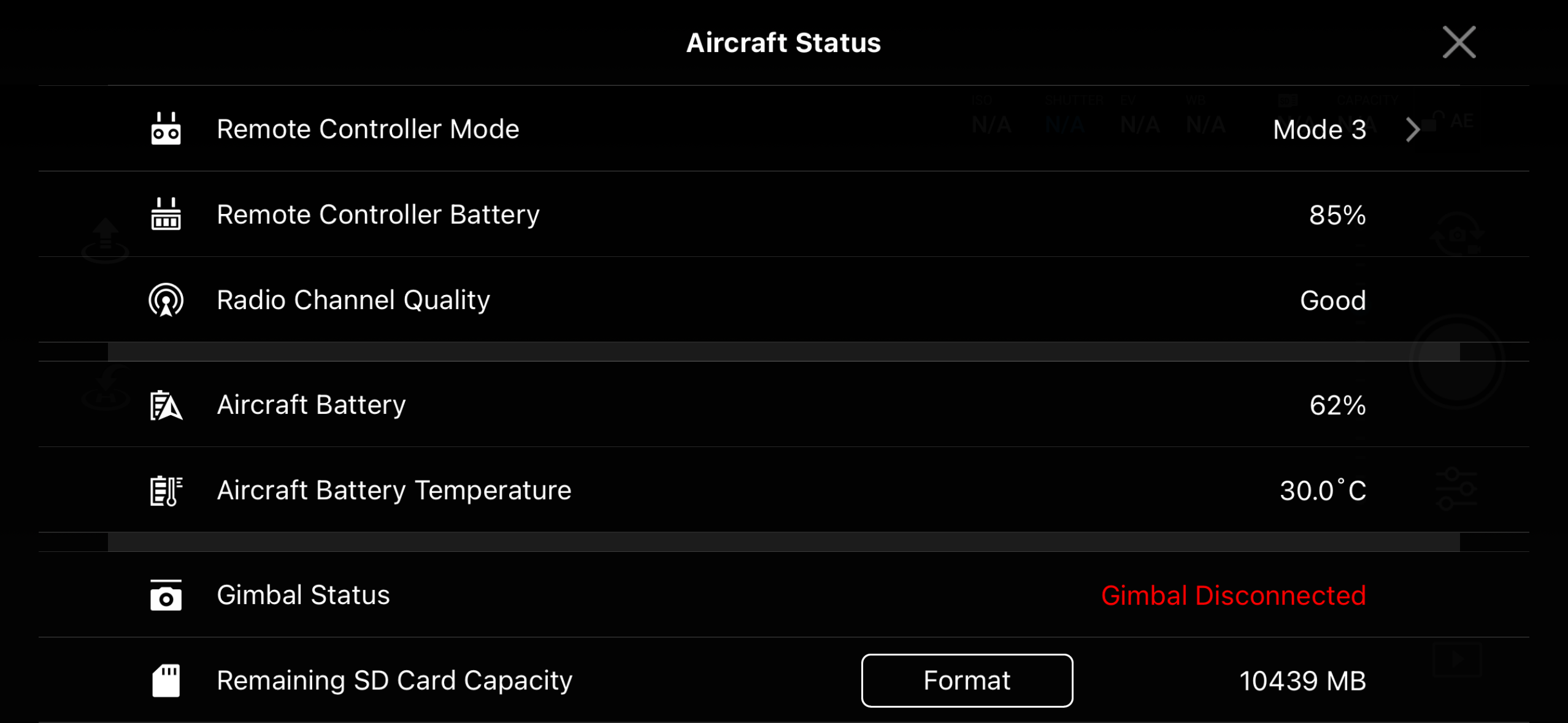

One thing I unsure about is the MODE 3 under RC setting, cant say I seen that before ,
Mode 1 changes throttle to right stick and left stick steering
Mode 2 most use being throttle left stick and steering ,foward reverse, right stick
How's mode 3 work ?
I not check on what's latest version of firmware because I tend to avoid because of my unsurity and leave that for others to advise,

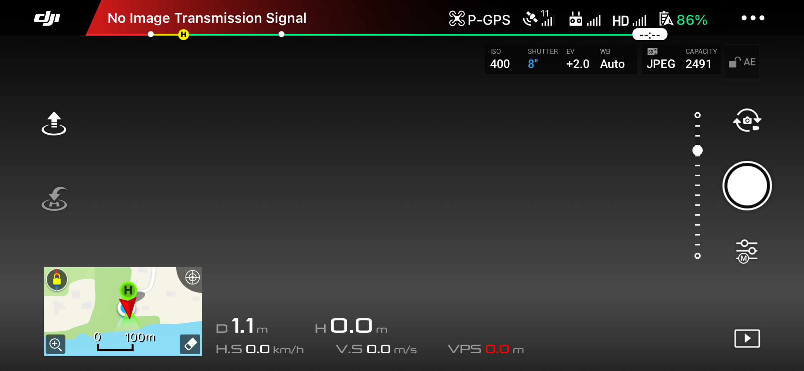

Green lights good on gimble and rc but no live view , I'd check transmission channels ,if that dont change nothing , as you probably seen here some firmware updates can cause grief so hold off on any updates , could also be caused by bad ribbon cable from the gimble, phantoms hate to sit dormant and somehow makes ribbon cable go bad,,I'm still lost on the mode 3 though
Off to search on that 1
Quick job to do I check back soon
I've only used two solutions for the 'no camera image' issue....but I've got P3 Standards....not a P3 Pro.
First was a complete shutdown and restart of all components....drone, r/c, app, and device (IPad) . Restarted them as directed and issue solved.
Second was (after power down) unplug and replug in the ribbon cable on camera/gimbal. Then full restart as above. No further issues. As @IANZONE said, ribbon cables are notorious for failure.

Starting simple is best. I'm still thinking there's an issue between the r/c and the phone (USB cable) or the gimbal and the camera (flat ribbon cable). Since the images make it to the SD card, the camera is working. But somehow the images aren't being broadcast from the bird to the R/C.
