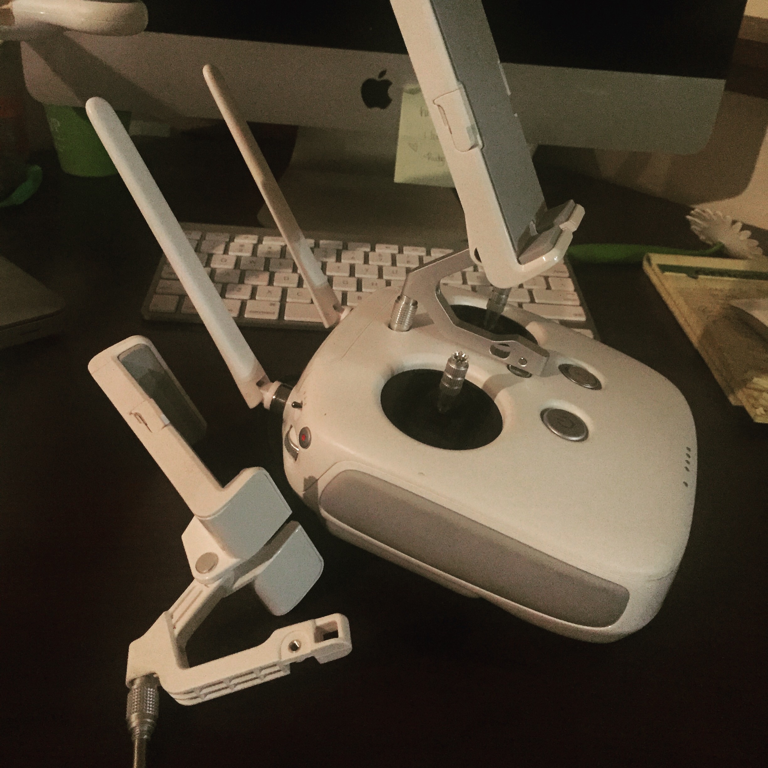

I got my Inspire mount and I can say that it was indeed worth the $30 and more. It properly supports my iPad Air 2 and also has the harness hole higher up on the mount which balances it properly so when I let go, the controller doesn't flop straight down from the weight of the iPad. It stays upright. Extremely pleased here.
As stated, the metal mount is a lot better. The hole for a neck lanyard or whatever on the metal one is before the mounting screw on the controller. On the plastic mount the hole is after the mounting screw. The metal bracket balances the controller A LOT better.
