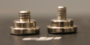

I just received mine but the mounting screw from the P3P controller is too small for the Inspire holder. Was there supposed to be a screw in the box with the new inspire holder? The threads on the P3P holder is much smaller than the inspire version.
Reactions: iquadtography
Yes, the Inspire mount should come with a screw, mine came in a silvery plastic bag. The screws are totally different.
Inspire on the left, Phantom on the right.

Awesome post @msinger . Best 30 dollars I've spent in awhile. No more wobbles on my P3P Tx. When I was installing it, I tried using the old screw with the mount and it didn't fit. Didn't realize that in the package was sitting a different sized screw that would fit.
Ha, I posted this a few months back but forgot to update it. I found the small silver bag under the car in the garage next to my recycle bin in the garage. I must have dropped it when I tossed the box into the bin. :)
