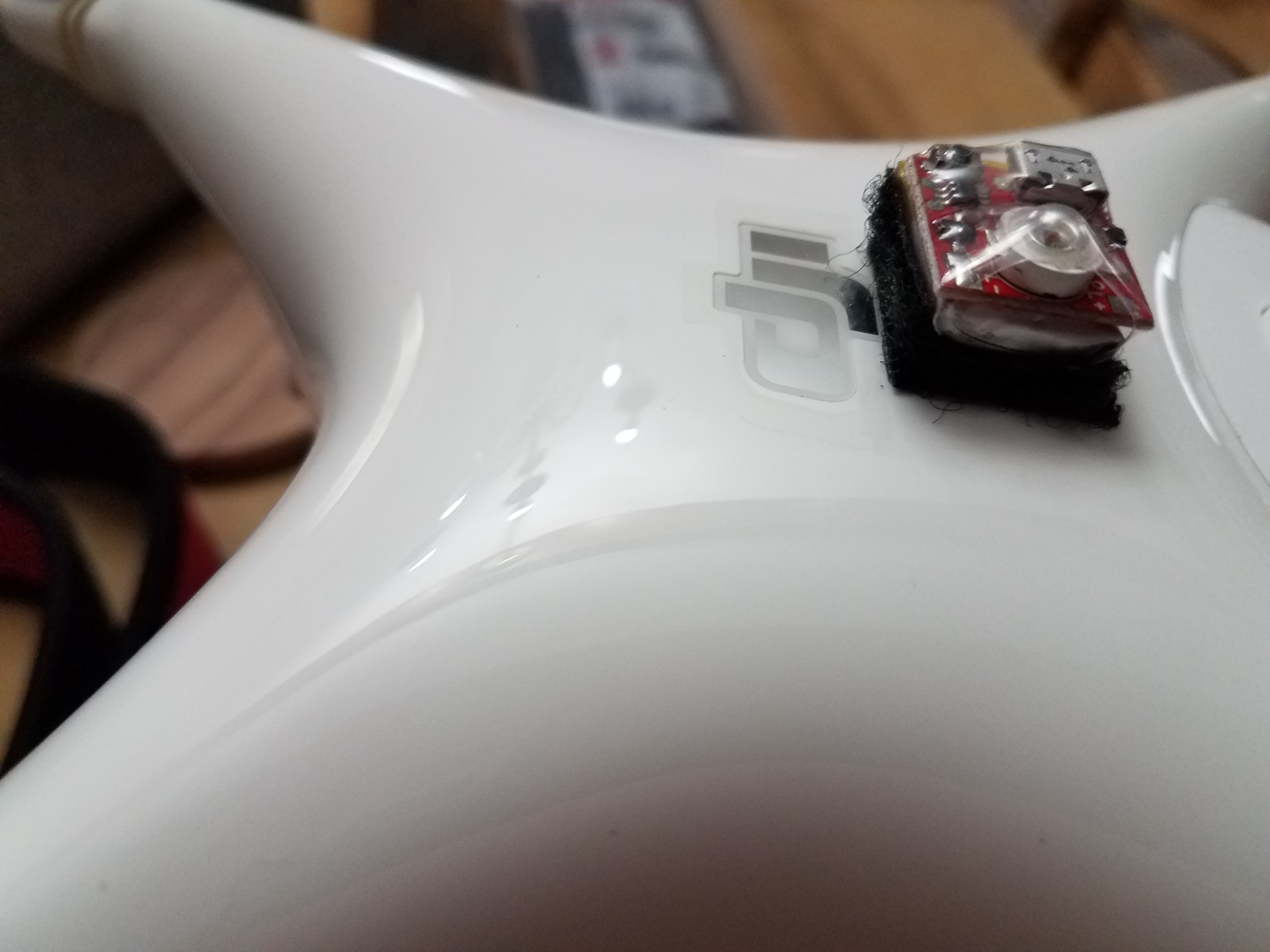

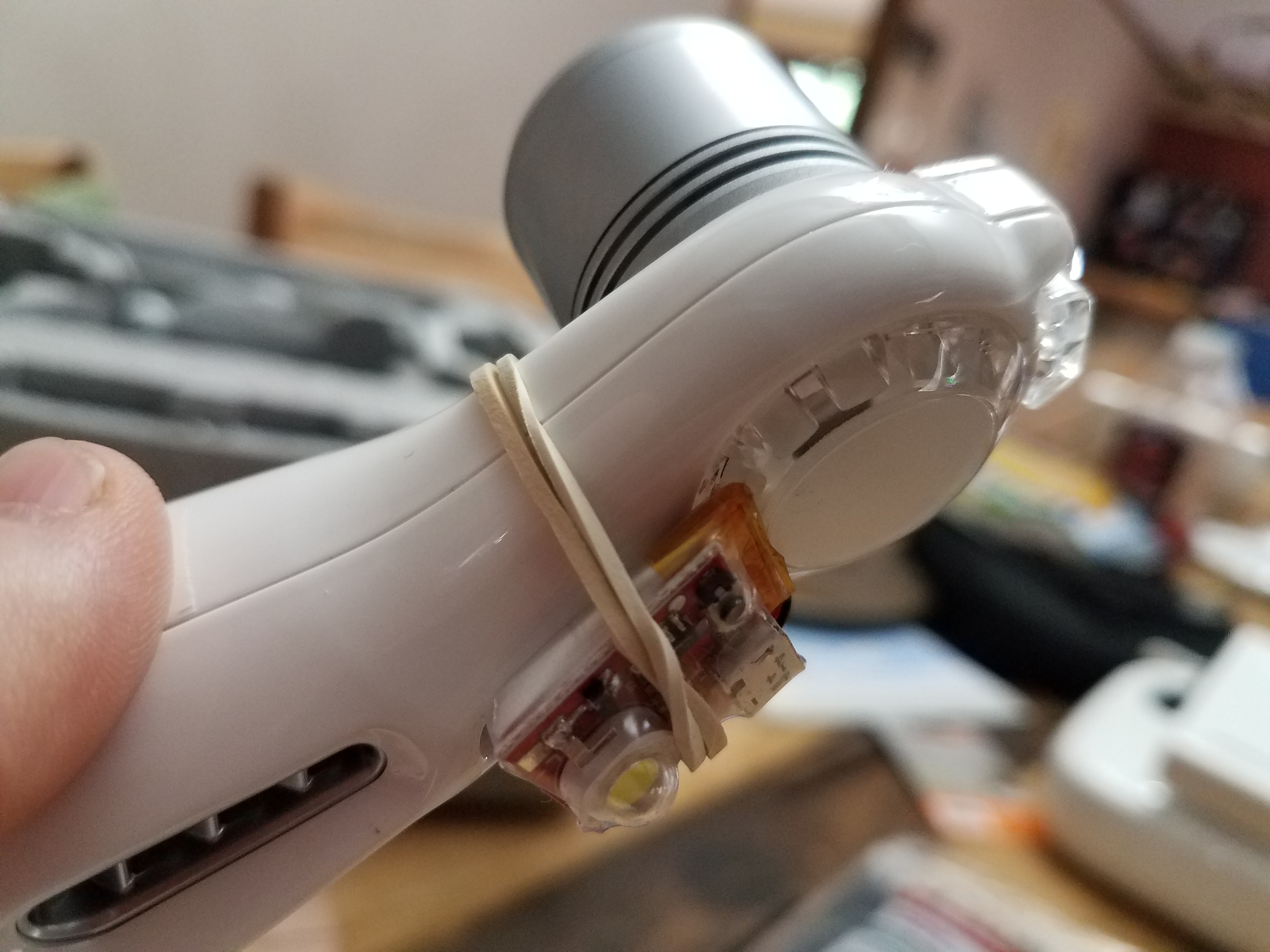

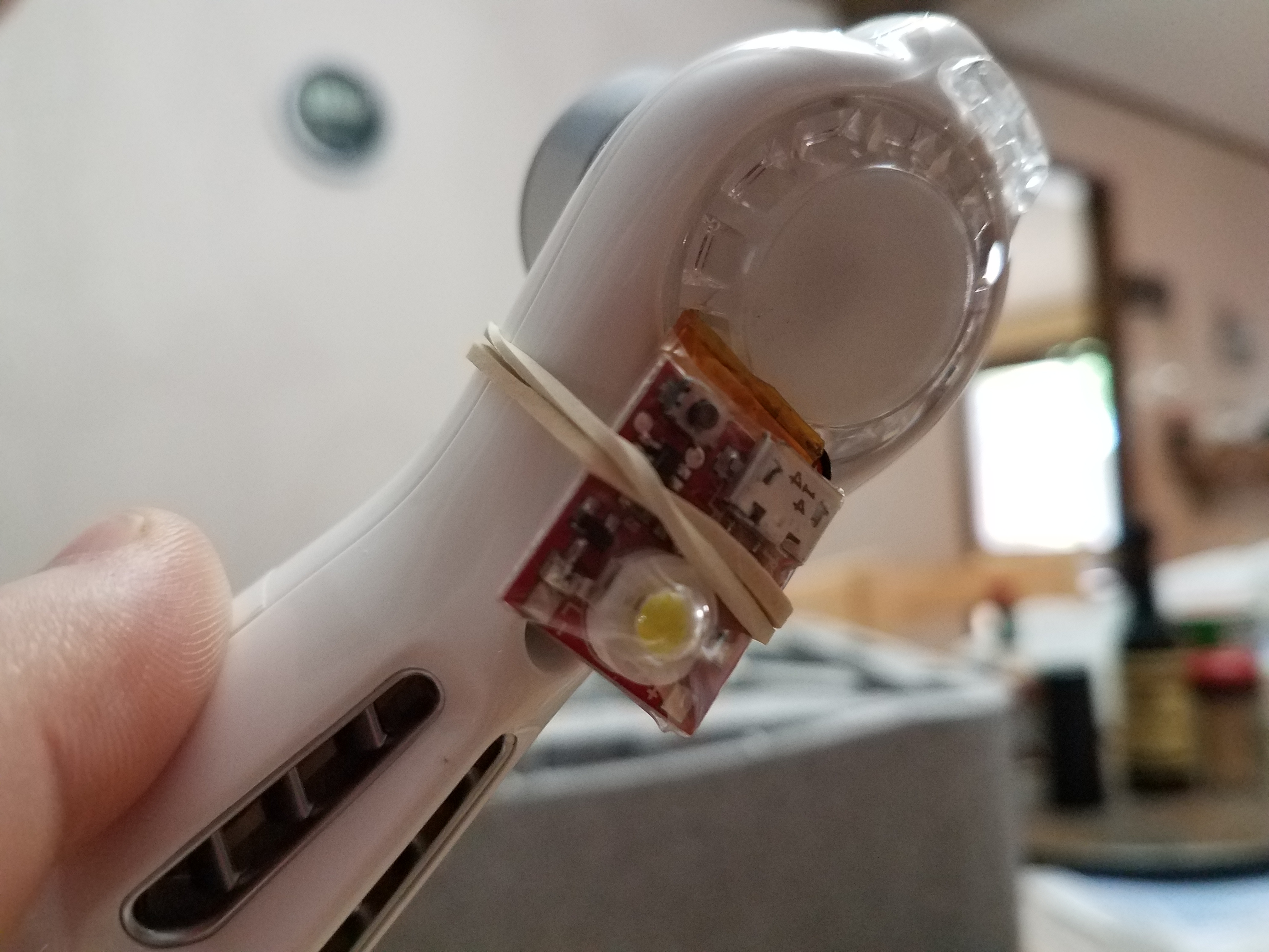

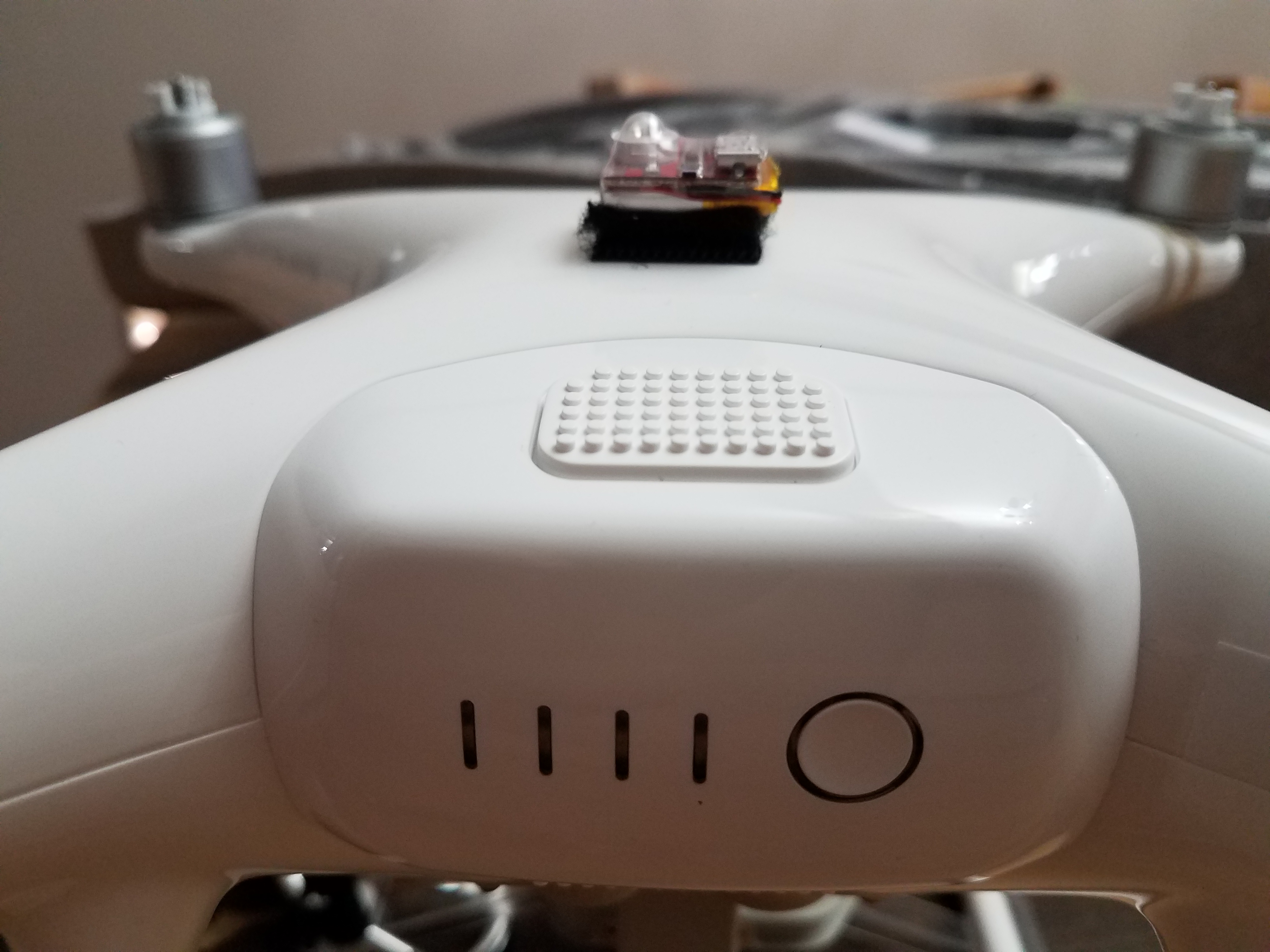

Can anyone please tell me where in the bird should I install the 2 Crees that i bought?
I have a P4P+
I have installed one of mine on the very top using industrial velcro I bought at Walmart and the other one on the rear arm using a small rubber band. Both have been tested using sport mode and I have had no issues with them falling off. I have had no issues with the GPS either.
The light mounted on the top (red strobe, not a Cree) can be seen by anything above me and it does not interfere with the camera. Also when I am flying directly toward myself, the light is easily seen. This works well in regular and even better in sport mode as the drone tilted forward is more pronounced.
The light mounted to the rear arm (white strobe, not a Cree) is facing down and I have tested it to 12,584 feet (2.38 miles, 3.8 km) away at night successfully. I could have seen it further but I didn't want to fly over any industrial plants that surround my area.
I do want to have a 3D printed mounting bracket that can clip to one of the legs which could hold one or two of these strobes of these but it hasn't happened yet. Any suggestions about getting this accomplished? Anyway hope this helps.

Cool but I wouldn't rely on rubber bands long term. They notoriously weaken and break and atmospheric conditions in flight could speed up the problem.
Exactly right and sunlight GREATLY speeds up the process.

I would not put these on the front of the bird or the front arms if clean video is the goal. The best spot will be the top of the bird and/or the back of the bird.
I am with you on the 3d print mount. I searched Thingverse and others. I found a Mavic mount, but no P4P mounts. Someday I have to learn how to make 3D stuff myself
