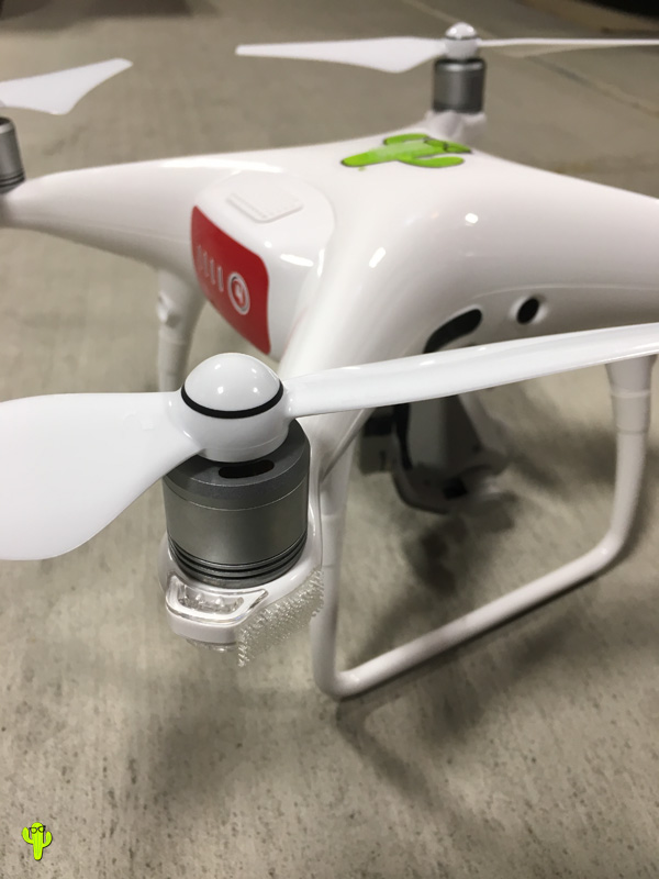

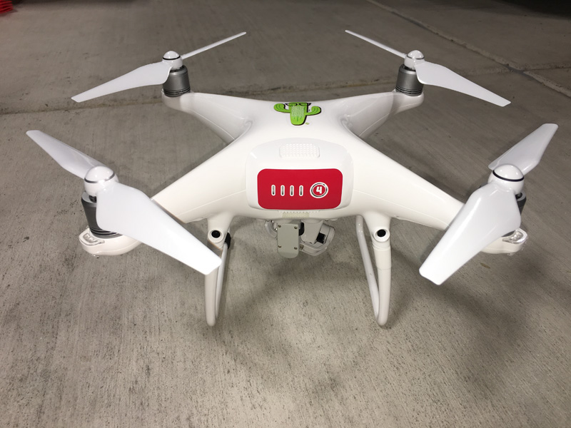

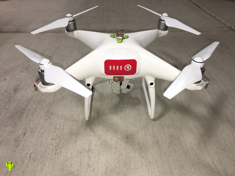

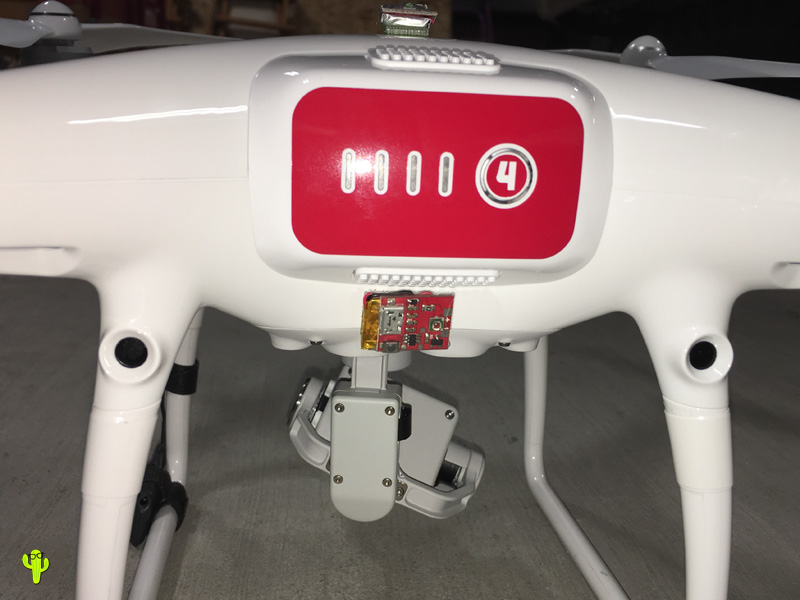

Here are some pics and a video of 4 Flytron Strobons (Cree) on my Phantom 4 Pro. I got two red and two white. If I were going to order again I would skip the red and just go for the white. They look to be about twice as bright and more easily seen than the red ones (again, the brighter Cree LED on those as well).
Thanks to @RocketBrew for his suggestion to use Scotch fasteners Flytron Strobe Lights
Here's where I have them located on the bird. While they may look to be fairly weak, they actually are quite the opposite. Even the locations at the ends of the motor mounts fasten quite well:
I like the clear nature of the fastener because it blends in with the bird:
The spot below the battery is at a slight downward angle, making it easier to spot at elevation. The one on the top really disappears quickly when viewing from the ground.
And a lame video from an iPhone below. The bird was fairly close (300 ft out and 150 ft AGL), looking at the port side. The white Strobons are easily seen and the red are visible, but not as bright. If you look closely you can pick out a bright dot above the clouds that is slowly moving --- that's the International Space Station flying by.
