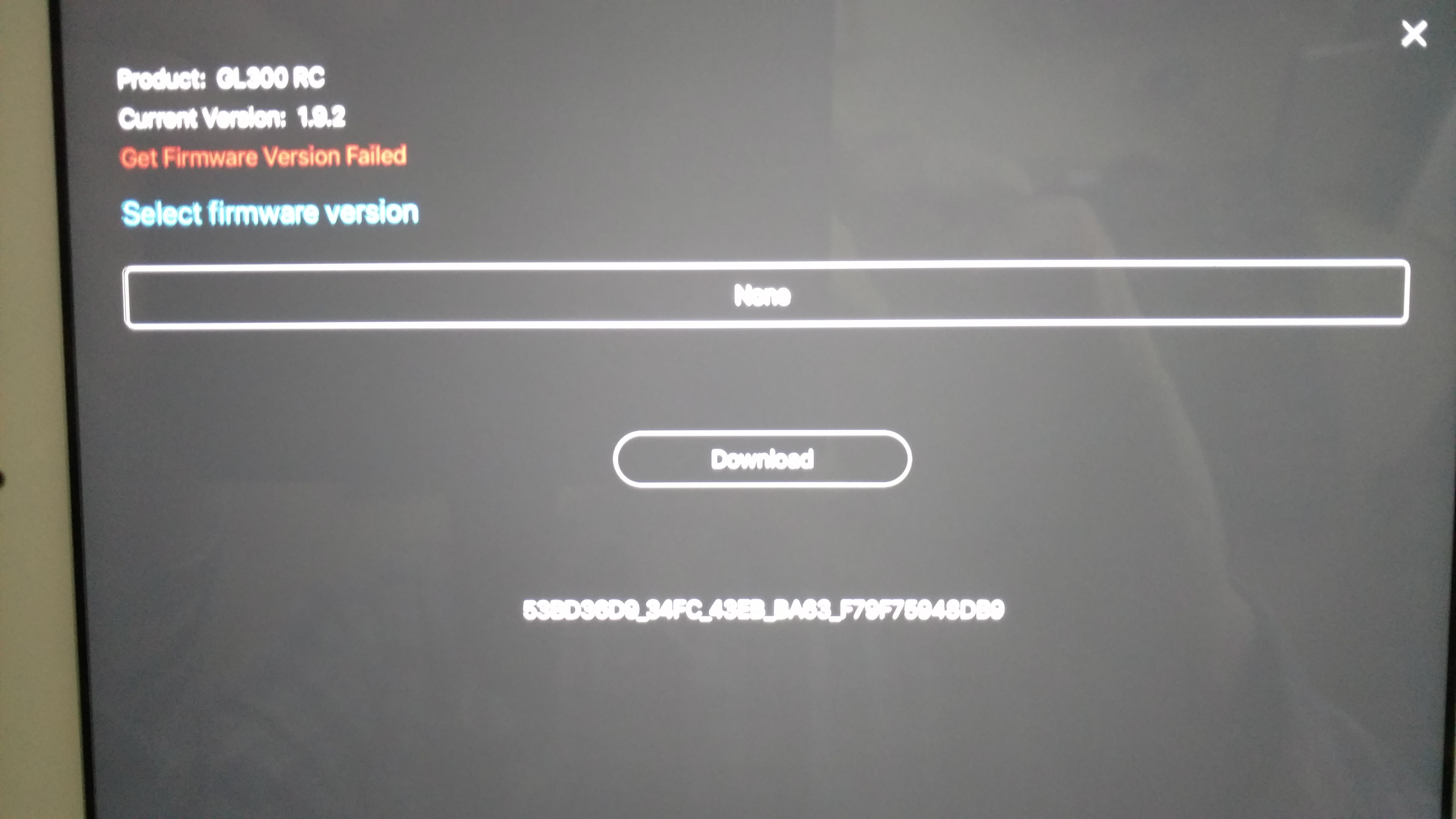

thanks again for your help
is there any way that i can get the ac into downgrade mode other than switching on with formatted sd card inserted with the bin file on it or in the app holding on the 3 bars see attached photo
Sadly, with AC v1.10 and later DJI removed the ability to easily downgrade via official means. There are unofficial means, but they are not without risk and especially from v1.11.20. You can find the info using the forum’s search function.
This is for the RC
