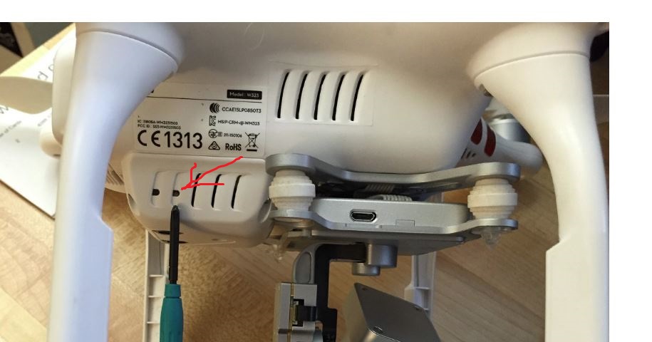

Thanks for the new suggestion! Gave that a shot, and this time the AC seemed to progress much further through the process, but then about 3 minutes into it, flatline tone and a "Result: Failed - Reboot the aircraft and try to upgrade the firmware again" in the .txt file. I'm going to try it again though. Maybe also with the v1.11.0020 file since that's the update that failed originally.
I think that is encouraging. Perhaps another attempt or two (with and without the binding button) will get you all the way home. Keep the fan running ..... and us informed. Good luck.
Two more attempts with formatting & using v1.03.0020 while depressing the binding button and the same result: gets to the same spot and flatlines/fails. I'm going to call it a night for now.
