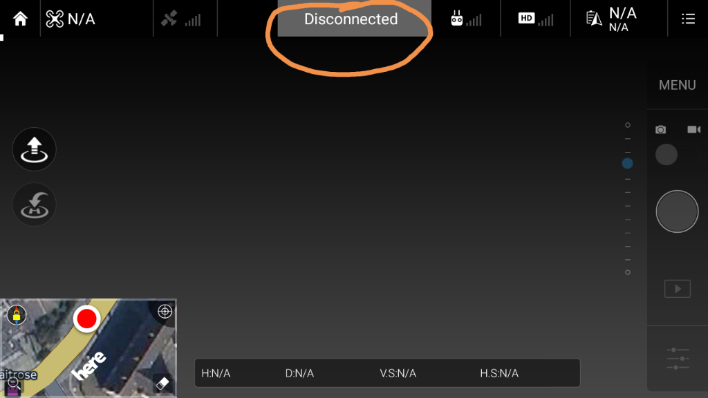

How did it turn out. My phantom is turned off but I included a screen shot on where you need to tap when you turn your one on. When you click here it will take you to an option to do the firmware.
Sent from my HUAWEI LYO-L01 using PhantomPilots mobile app
How did it turn out. My phantom is turned off but I included a screen shot on where you need to tap when you turn your one on. When you click here it will take you to an option to do the firmware. View attachment 70988
