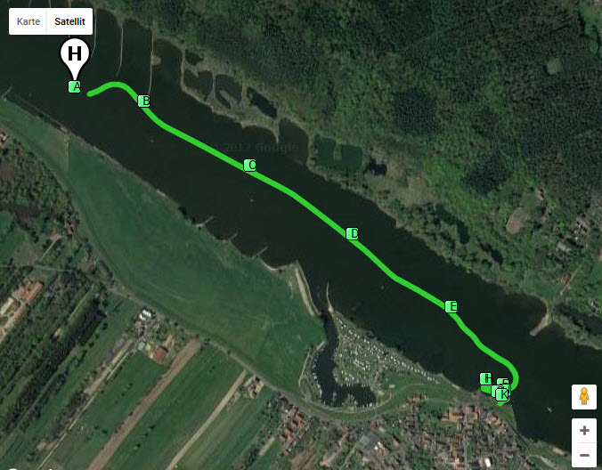

I think I know now what happened to the OP - it happened to me today!
Since having video lag etc often on the K1 tablet, I thought I give it a try with my Google Pixel XL phone (Android 7)
Bad idea!
I managed to go quite some distance over a river, I was standing next to it on a dike.
No signal problems. Just as I turned around the app crashed.
I restarted the app and continued to fly home.
When I checked the flight at Air Data I realized that upon restarting, the Go4 app automatically set a new homepoint - at the AC, over Water!
I'm lucky I didn't rigger RTH. The drone would have gone for a swim.

IF THE APP CRASHES, DON'T RESTART IT! Trigger RTH on the remote!
See top left in the image:
It says "H" for homepoint at the moment where the app was back up working.
My actual homepoint was to the right at the bottom.
Since having video lag etc often on the K1 tablet, I thought I give it a try withe my Google Pixel XL phone (Android 7)
Bad idea!

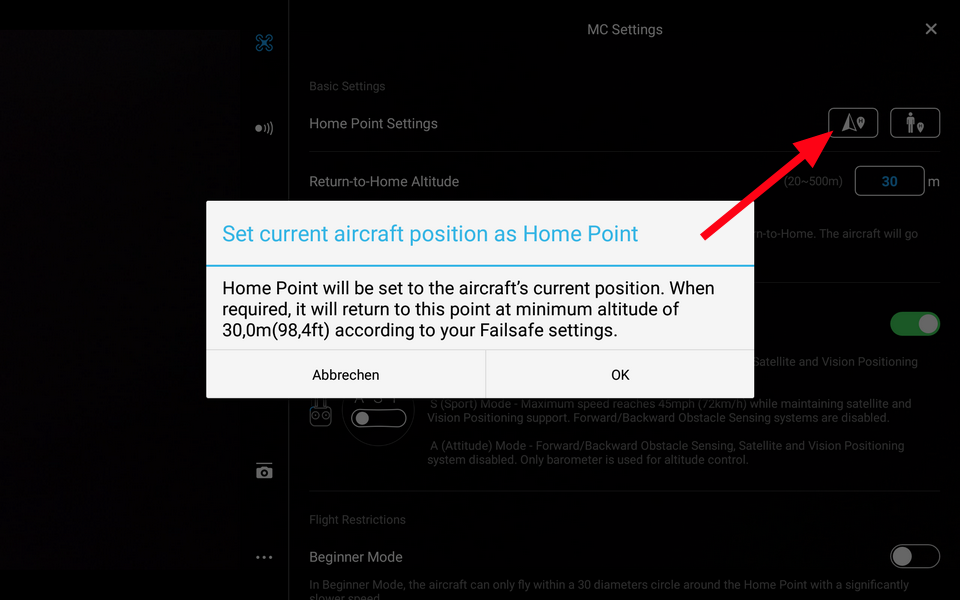

In the Go 4 app I can't see an option for dynamic home point for the P4P.
I can set homepoint as often as I want during flight - to AC or RC - but that's a manual procedure.

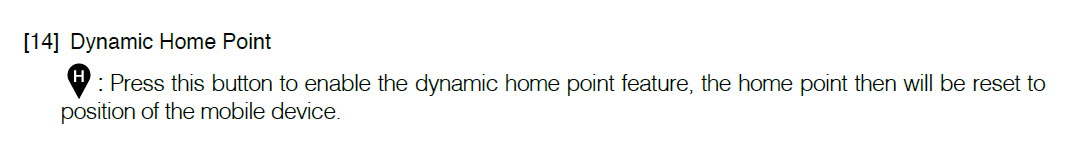

On p. 37 in the manual for the P3 advanced I found this (below).
Wondering why it's not available for P4P.
I guess it only makes sense if you are wandering some distance with the remote while flying
(or while being on a boat!) - having set home point to RC:

It has happened to some that while being nervous as the situation becomes difficult, they mess up the home point setting and accidentally hit the button for "Homepoint at AC". (You can continously set a new homepoint unless you have precision landing activated.)
For some reason I don't understand the P3A even has a "dynamic" homepoint feature which is not available for the P4P!?
