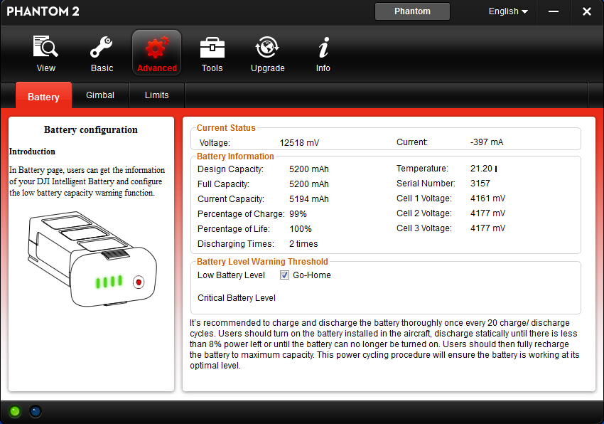

Other than replacing the receiver have you removed any of the connectors from the Naza-M module?? This problem of it crashing when the gimbal and camera mounted is not caused by either as it is either incorrect wiring, cold connection or your batteries. I have shown you screenshots of batteries now I would like to see screenshots of the batteries you are using that is if you would like to get to the root of the problem. Charge all the batteries before posting screenshots.

Still, need to see those fully charged battery screenshots.

I'll be uploading those screen shots of the battery as they finish charging. I don't let them charge unattended, and used them up last night flying without the gimbal.
Battery 1

Try this take the props off and take two batteries that shut down and plug one into the P2 and start it up. Let it run until there are only two LEDs lite on the battery and do the same with the other. Then take a reading of both and post screenshots of both. By not storing the batteries properly can cause the current drop very quickly and when the voltage reaches 10.6v it's all over as that is the critical point. This video is from a battery with a bad cell.
Battery 2 stopped charging after 3 minutes and had this.
Battery 3 charged for an hour and stopped charging.
If I plug in either battery, they will not charge any further. Green LED on the charger.
