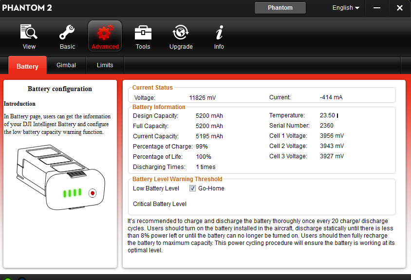

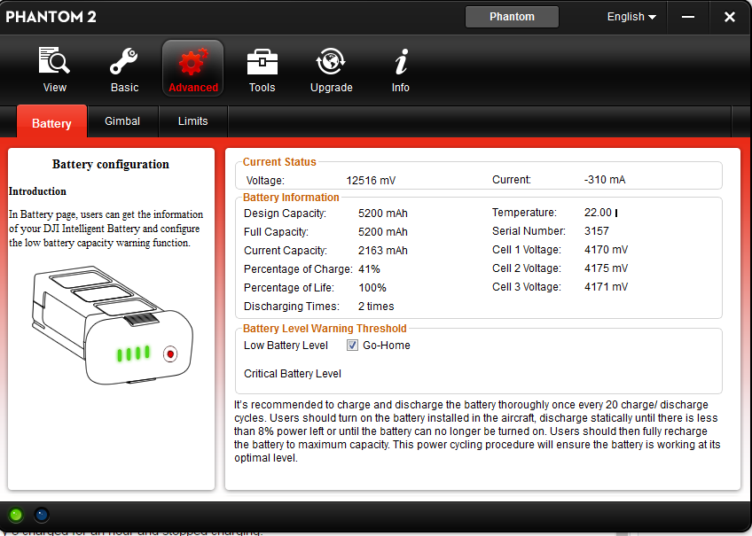

Battery 2 stopped charging after 3 minutes and had this.
Battery 3 charged for an hour and stopped charging.
If I plug in either battery, they will not charge any further. Green LED on the charger.

Don't waste your time with those two batteries as you have seen happens without the gimbal/camera attached Personally I wouldn't trust the other one either.
New pair of batteries will be here Wednesday. I'll do a couple of test flights with them, then get the gopro mounted again, and try it again. I would really like to get some video.
Success!
Great, so it was batteries.
